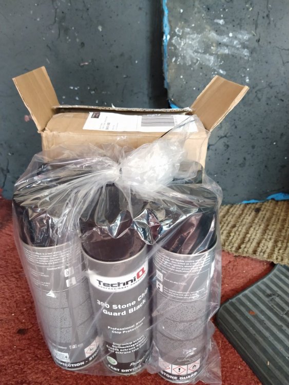

I'm using some thick seam sealer as a protective coat instead of underseal, on the areas I've repaired, then as a precaution I'll try this stuff over the top of the seam sealer.
TechniQ Stone Chip

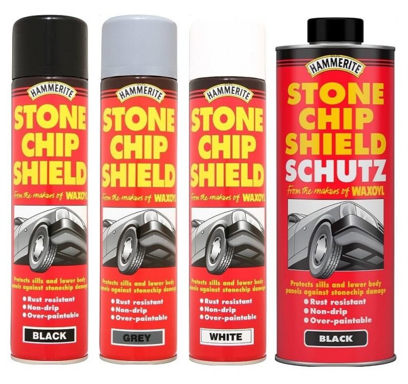

Before I even applied the seam sealer, I painted a few layers of paint first, zink or galvanized paint, then some red oxide paint, then used some Hammerite stone chip, once that was dry then applied the seam sealer.
