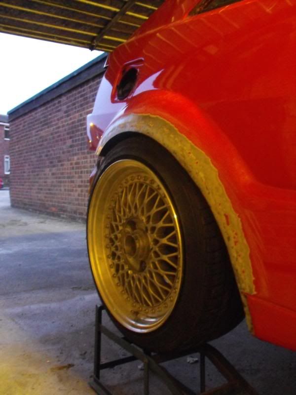

Critical_Mass 10 Posted July 15, 2010 The wheels arent on the car any more Nath, infact im getting rid of them. BUT i still love seeing the work. It does look mean in the pics. Daft question alert!!!! - how do you know how much to pull each side and how do you know you've pulled the rear ns arch the same as the rear os arch and same with the fronts? Quote Share this post Link to post Share on other sites

C488ADO 0 Posted July 16, 2010 The arch roller is rubbish much easier and a much better result by dollying it out by hand, The arches were made to fit aroun the tyres I had on the car and the car set at the ride height I wanted to achieve I didn't want any rubbing issues, to make sure everything was equal the bumper was fitted and re fitted to get the right gaps shape and look the original lines were kept as I wanted a stock look Quote Share this post Link to post Share on other sites

CorradoVR6-Turbo 0 Posted July 16, 2010 This is how i did my arches,front are easy,rears i separated the inner tub from the arches and pulled them out and harmed them out,not easy but got it to the point only a skim of filler was needed to finish it off. Quote Share this post Link to post Share on other sites
Fulltimejunglist 0 Posted July 16, 2010 nice mate, nice wheels too. Is the tub, the bit where it joins onto the underside of the arch? is the then welded back on and fillerd etc etc... thanks Quote Share this post Link to post Share on other sites

CorradoVR6-Turbo 0 Posted July 16, 2010 Love the work on both these cars seen james in the flesh and looked such a good job soooooooooooo jealous Cheers mate...the good old days... :salute: and yea they were cut and reweled,the inner tub is the inner arch,then reweled and seam sealed them undercoat and then stonechiped. Quote Share this post Link to post Share on other sites

Erny 0 Posted July 18, 2010 James what did you do to seperate the two skins? I've not dug the old sealer of yet to see what I'm goin to be workin with, did it require much heat when hammer and dollying? When I did the ones on my mk2 they were a doddle much like corrado fronts I guess, little to no heat just pateince n no fear. I'm a little scared of the rears, it will be one arch a weekend. Start on A Friday night n hopefully be drivin to work Monday morning job done just a sloppy paint patch up Quote Share this post Link to post Share on other sites
CorradoVR6-Turbo 0 Posted July 18, 2010 I used no heat,it would have been better for sure but i just batterd them untill i got the shape i was after. As for the skin they only have around 4 spot weleds and the rest is boded together,basicly dont bother finding the spot welded just cut the inner arch all the way round as close as you can to the outer arch.....it takes time.....lots of it and plenty of grinding with you neck pointing in the wrong direction :lol: then its a matter of bending the inner tub away and using a shape dolly to get it to the shape of the outer arch....and then re hammer the inner arch back to the outer skin and spot weld it together,this also gives you much more tyre clearance,after that you need to seal it up real good to keep the weather out and then spray cavity wax from the inside with trims removed. I tried to use a arch roller but got no where fast as the the steal used is thick! combined that with the inner and outer tub will never happen :bad-words: Quote Share this post Link to post Share on other sites
Erny 0 Posted July 18, 2010 Cheers James, I thought theyed be more than 4 spots in there, I'm guessing you did more than 4 spots after, I can see hammering the inner arch up tight to the outter one being a pain, Quote Share this post Link to post Share on other sites
CorradoVR6-Turbo 0 Posted July 18, 2010 yea i just welded tacks all round and this would make it more stiffer than oem, hammering the inner arch was not to bad,just were ear defenders! :lol: its worth it imop,gets the look i was after and matched up the rear bumper nicly to the arches 8) plenty more pics here mate. http://s561.photobucket.com/albums/ss60 ... ?start=all Quote Share this post Link to post Share on other sites
Erny 0 Posted July 18, 2010 Yeh I've had a good read thru your thread, I was Thinkin ied get my mate to weld all around to stiffen it up. Thanks Quote Share this post Link to post Share on other sites
