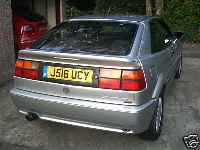

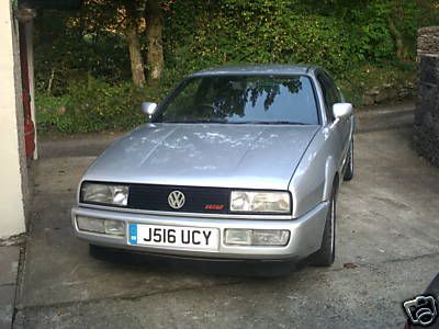

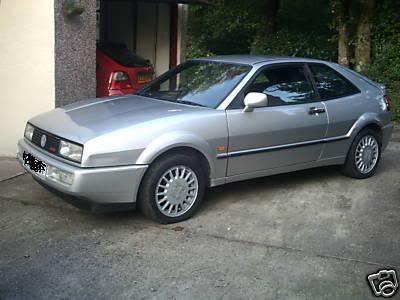

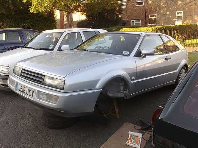

It all started with a sliver non sunroof corrado 1.8 16v brought for £400 from Wales as a non runner...brought off a FARM!
First pics via ebay
brought for a everyday car......if not broken for spares.

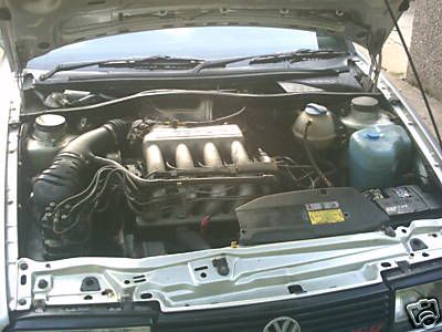

After accessing the engine, it was discovered:-
1.The side plastic water flange was leaking water,
2.Thermostat was seized
3.Water Temp senor Broken
4.Matrix's was blocked too
once all this was sorted, she fired up fine.......bargain.....so the dilemma do i break her for spares or not?........i think NOT!!!! :clap: :norty: :notworthy: :nuts:

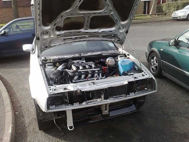

Ok, so well im in the engine bay, why not clean a few things up and modify bits and pieces.
1.K&N Panel filter
2.Stealth racing warm up reg and cold start.
3.Power roah tubes
4 power coat manifolds
5.clean and paint metering head
6.Upgraded leads

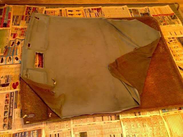

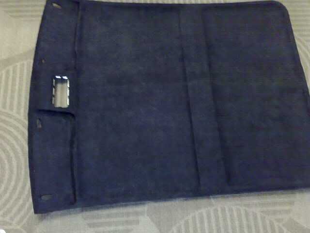

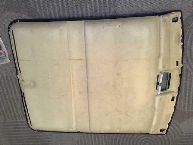

i kind got pee off with the sagey roof lining so out it came for a re-trim..

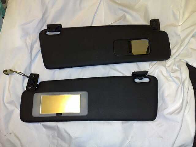

why not have some black sunvisors too....

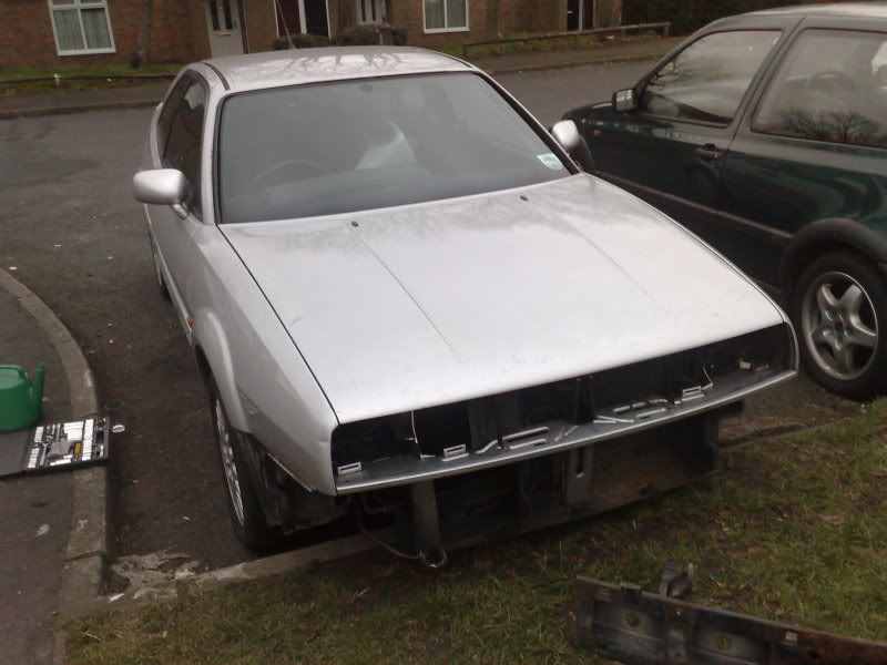

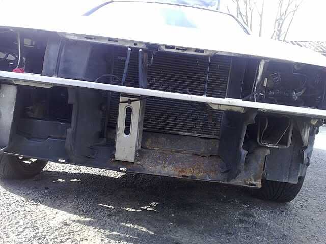

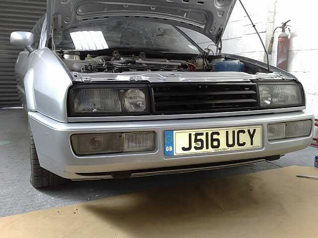

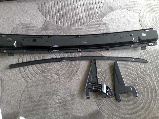

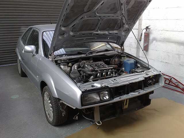

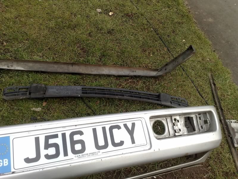

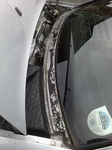

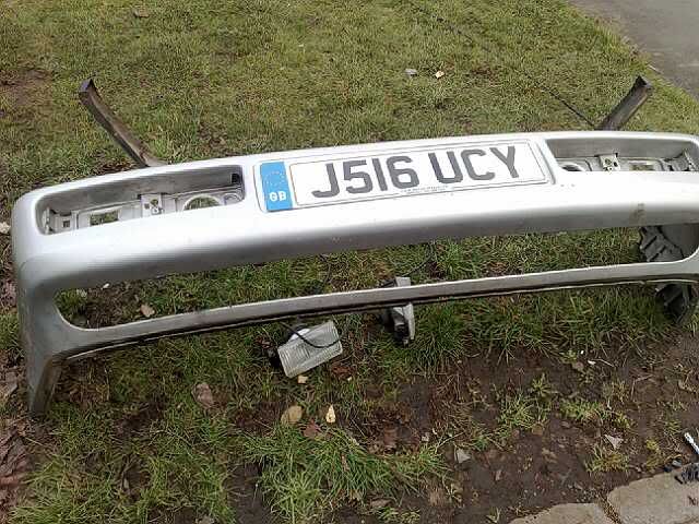

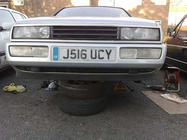

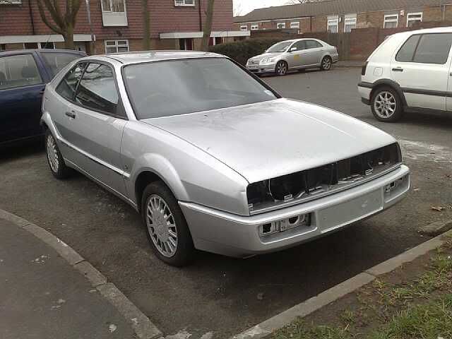

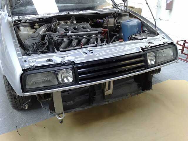

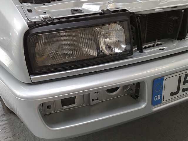

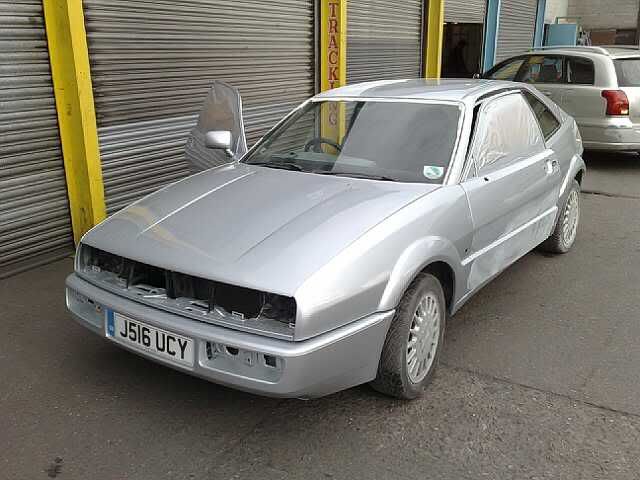

ok then, time for the strip down before paint...off with the front bumper......then oh no....what have i found..... :brickwall: headlighs and grill also removed

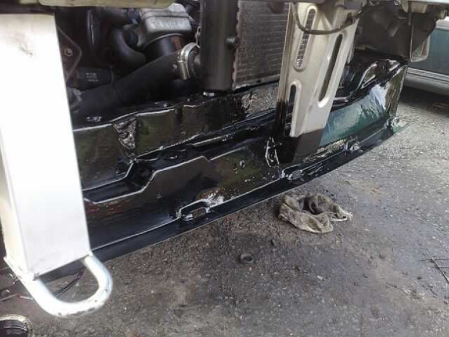

rust lower valance...
metal then strip back to bare metal, rust treated, etch primered, then paint ...then stone chipped.

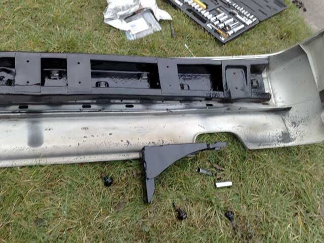

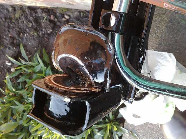

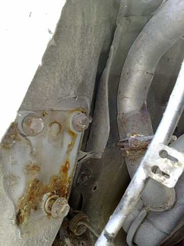

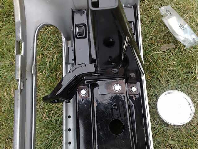

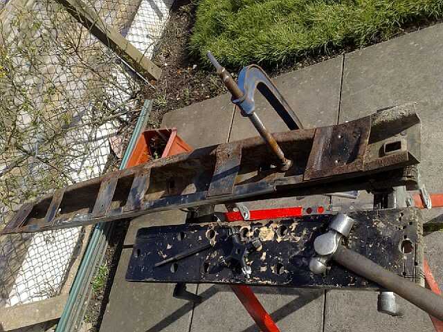

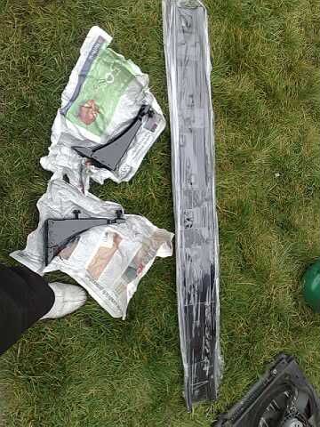

time to strip down the front bumper....bumper brackets were rusted too.
brackets send for blasting and power coating..and refitted....new bolts/washers. while at power coaters, bumpers were washing in and out to remove all dirt.....

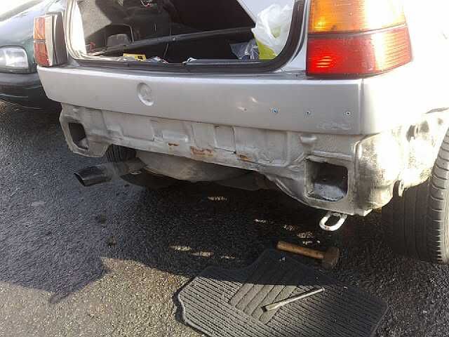

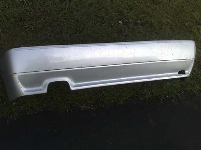

same for the rear bumper too....
a few rust blots snapped off in the bumper iron.....so redrilled out and tapped.
back from power coaters and refitted,new bolts/washers, again bumper washed out...

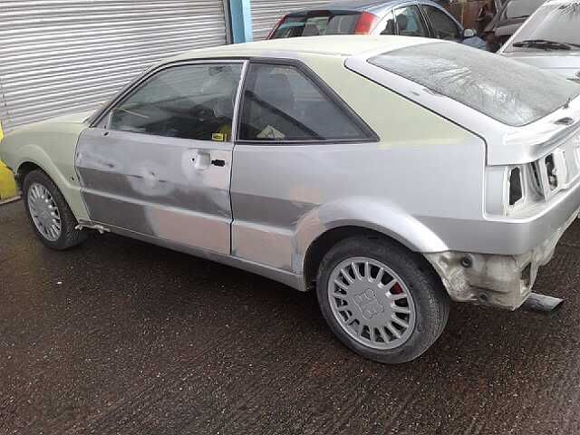

rest of car then strip down, rubbers removed, handles, mirrors, badges,side mouldingetc

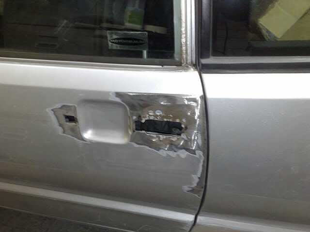

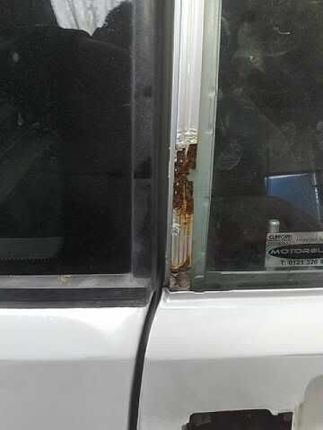

door had been screwed before and hidden behind different rubber window seal

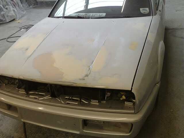

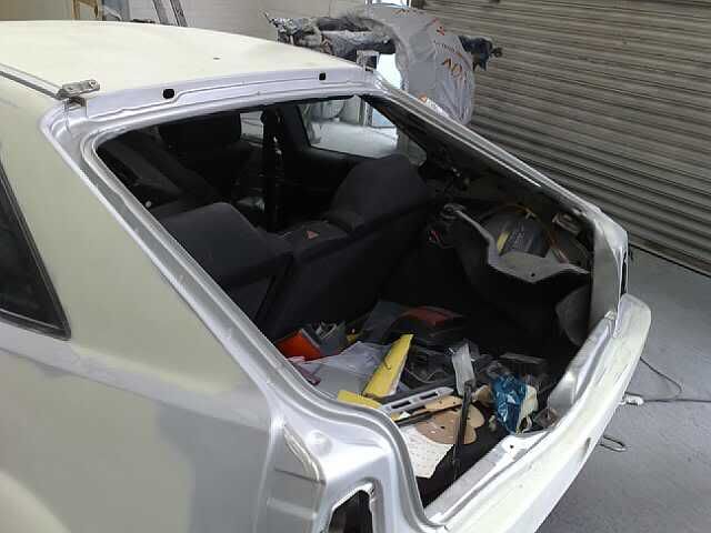

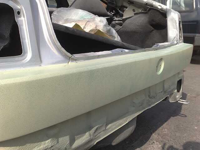

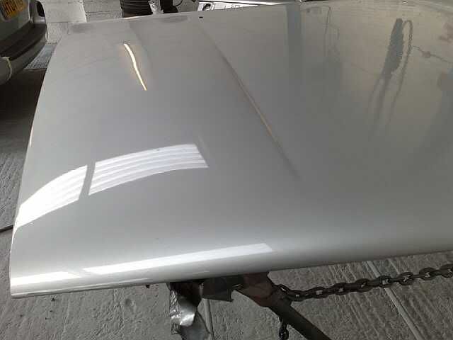

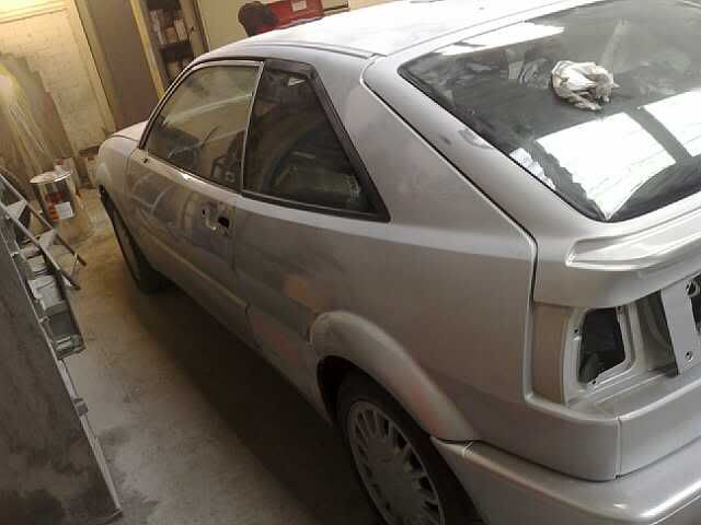

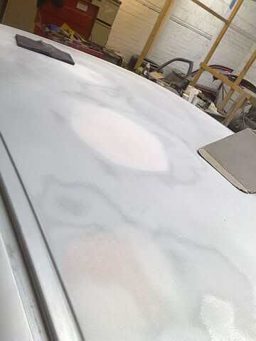

right of to the body/paint shop.....the chap whom paint and did the bodywork repairs Porsche's for main dealer....so worth a go, after all it was a cheap quote too...car had dings all over the place.. :shrug:

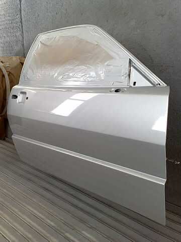

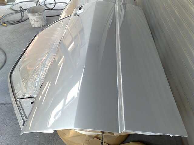

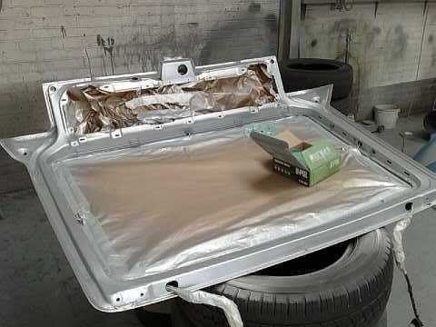

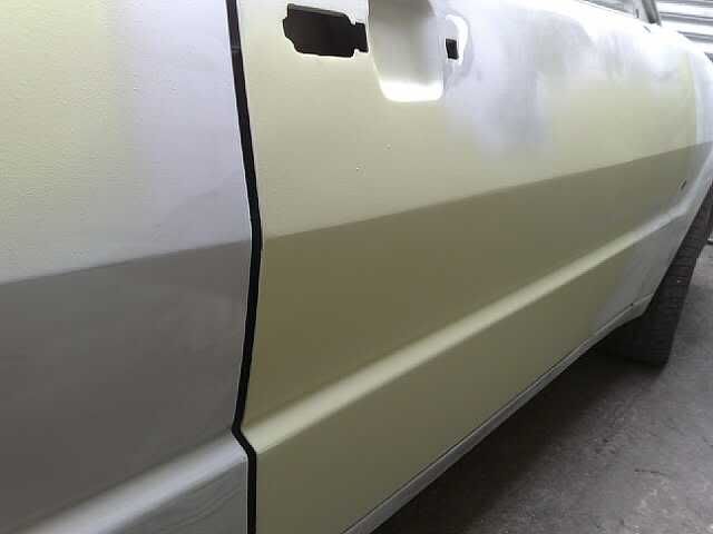

door repair, where previous screwed......metal cut away and new piece welded in

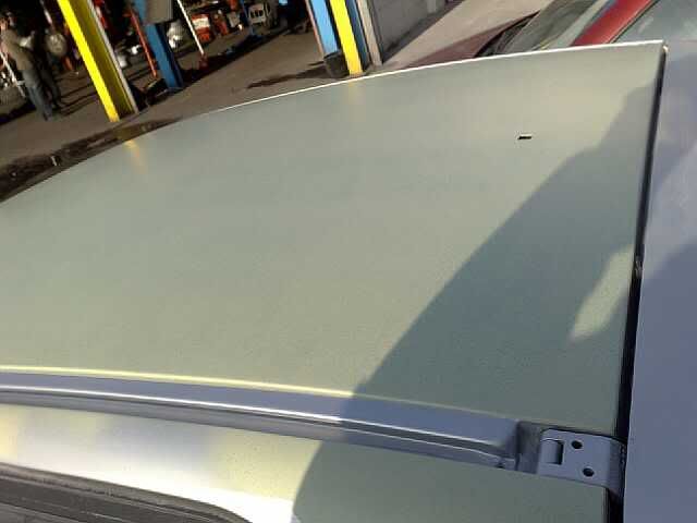

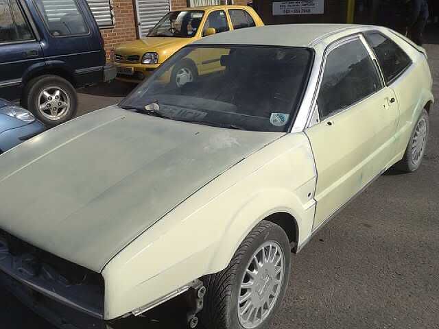

primer time....

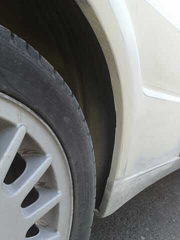

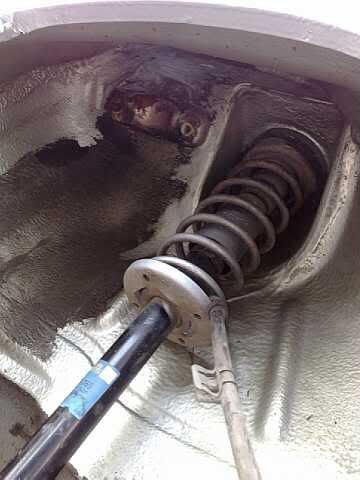

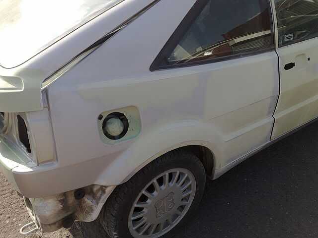

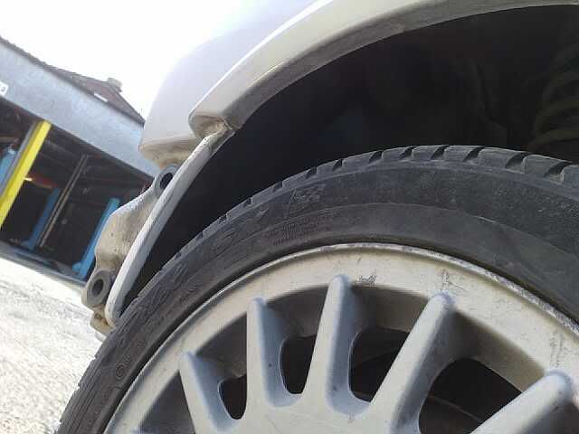

all four arches were fine, no welding .....abit of surface rust, cleaned and treated..

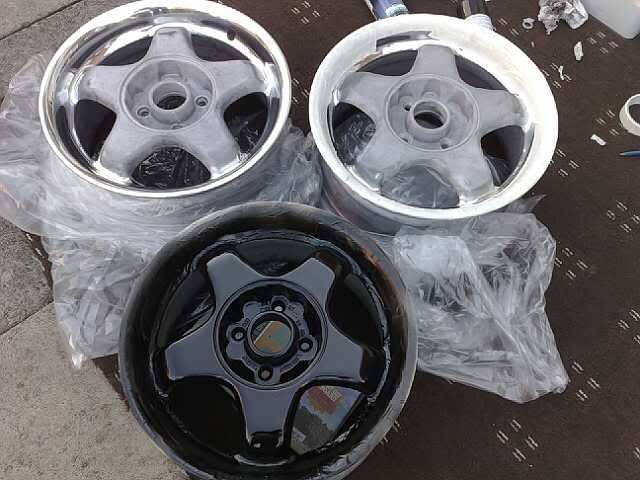

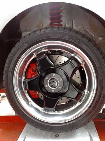

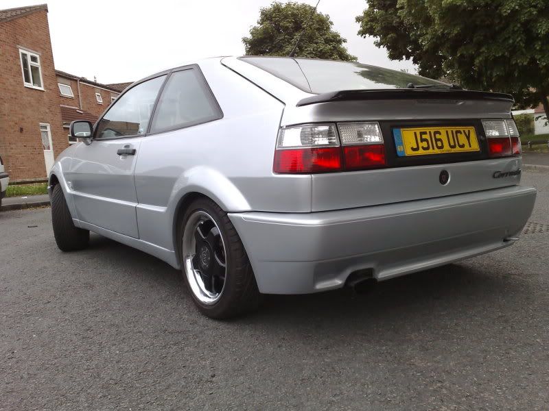

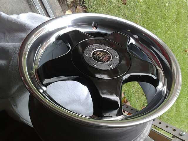

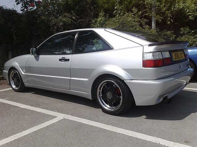

alloys- i had these for about 7years 15' 4x100 7.5J Rial. chemical striped, dish polished and inners painted.

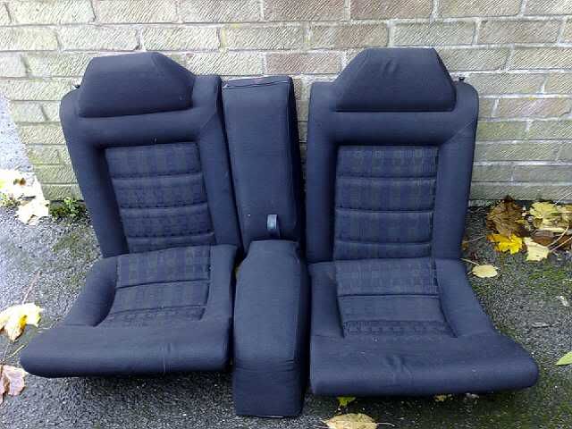

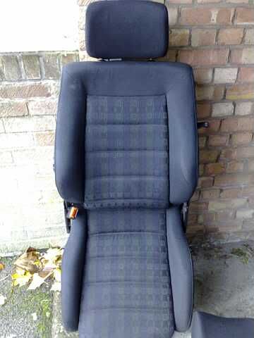

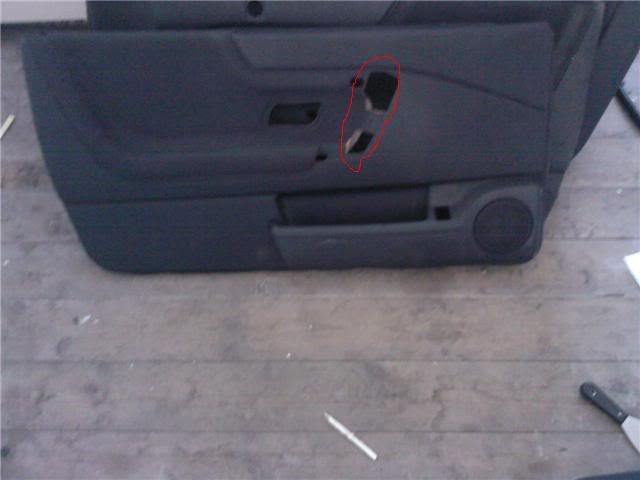

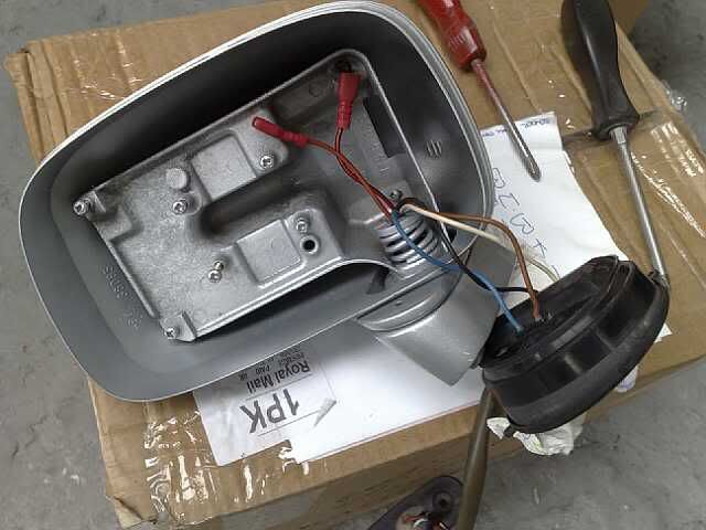

interior taken out and swap for late VR6 cloth interior,inc door cards, electric windows were also fitted and late mirror switch.

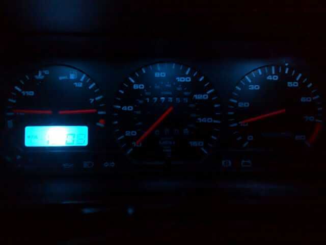

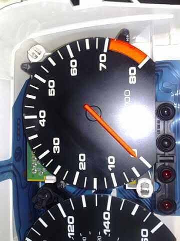

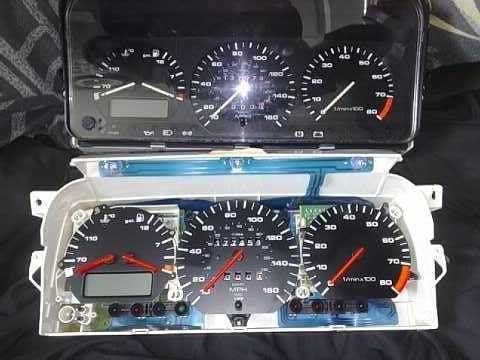

clock needles painted and blue LED's fitted:
SHOUT OUT TO JMC for led convo for all switch and heater panel:

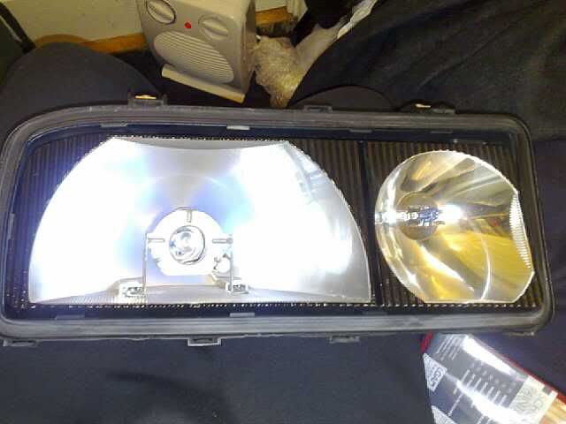

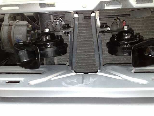

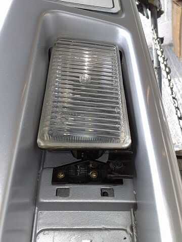

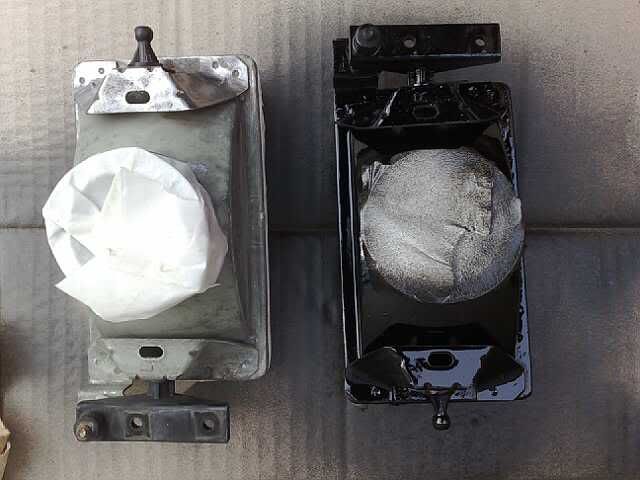

headlights, horn and fogs cleaned and painted + upgraded headlight loom

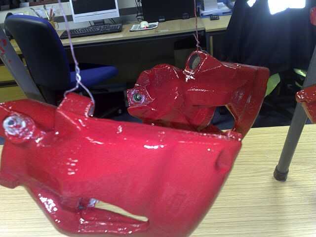

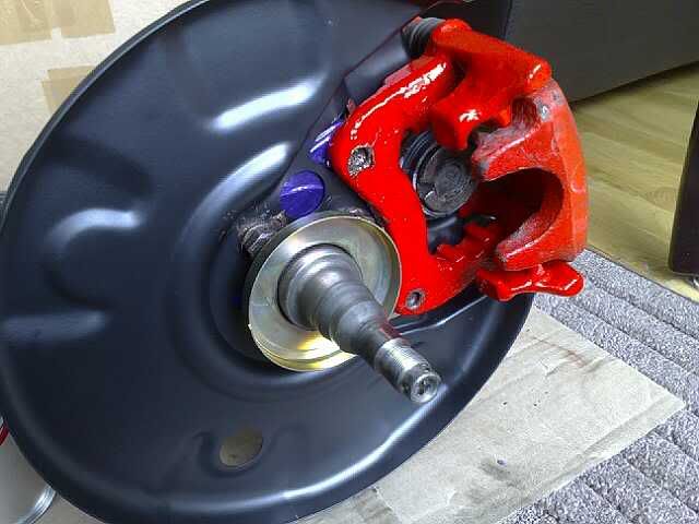

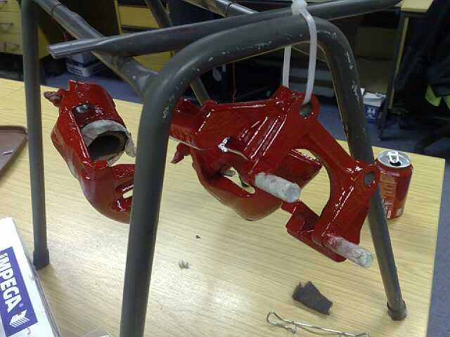

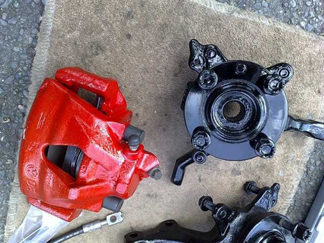

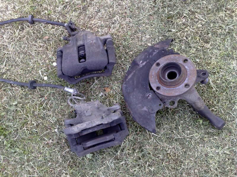

VR rear calipers and mk3 front 280mm calipers- striped, clean, rebuilt and painted

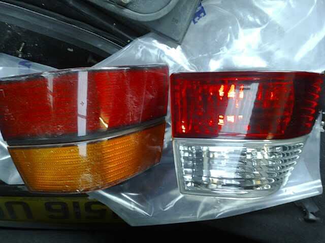

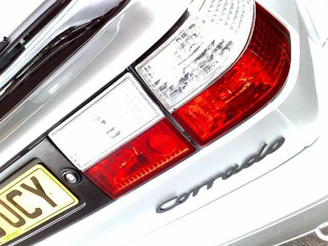

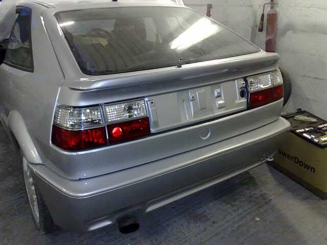

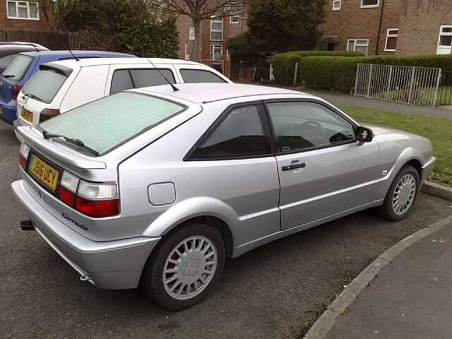

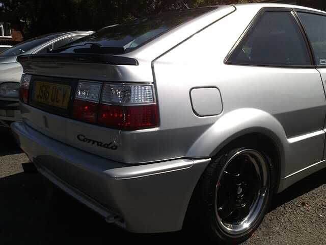

some new smoked red/white rear lights:

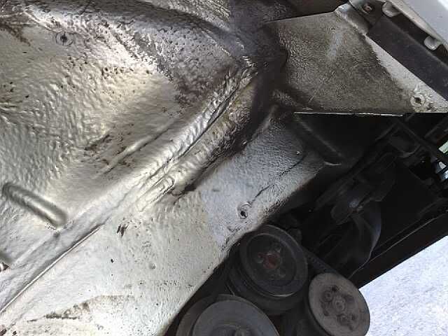

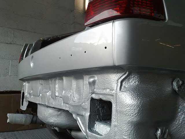

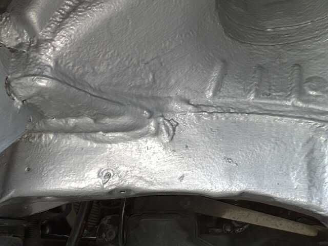

i missed out a few pics....before the car went to paint, i clean all the arches out and painted then a fresh silver and then wax oiled them heavily after it return from paint.

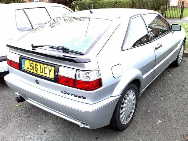

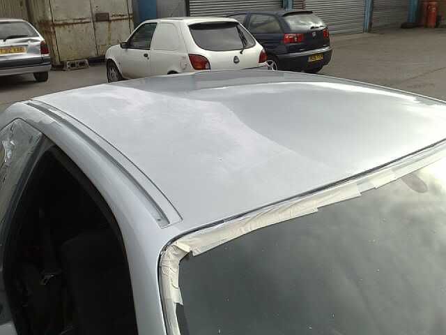

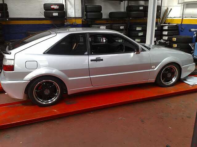

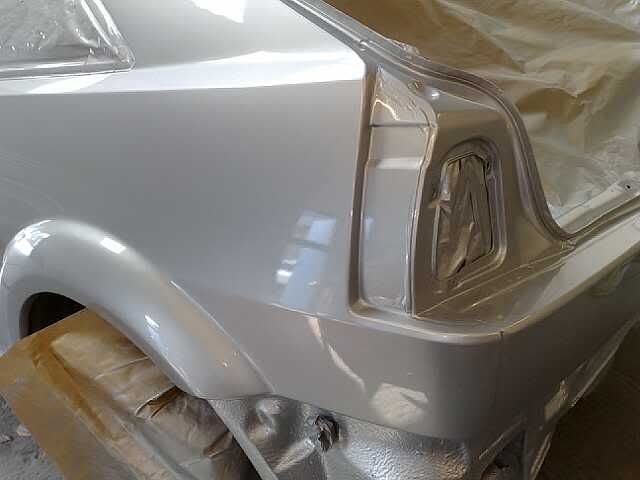

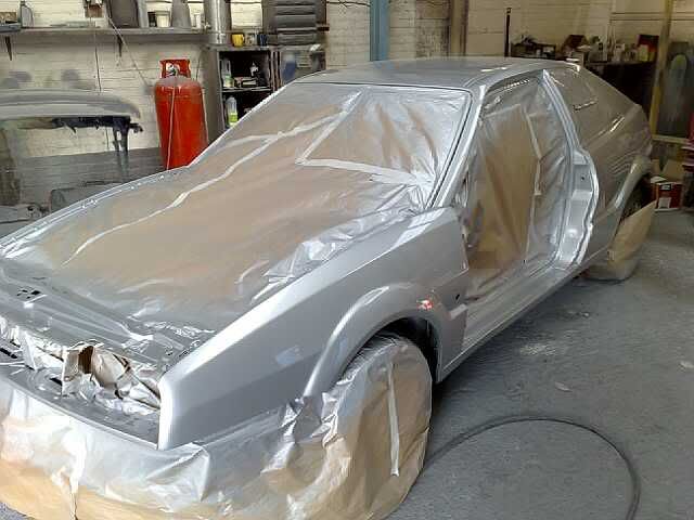

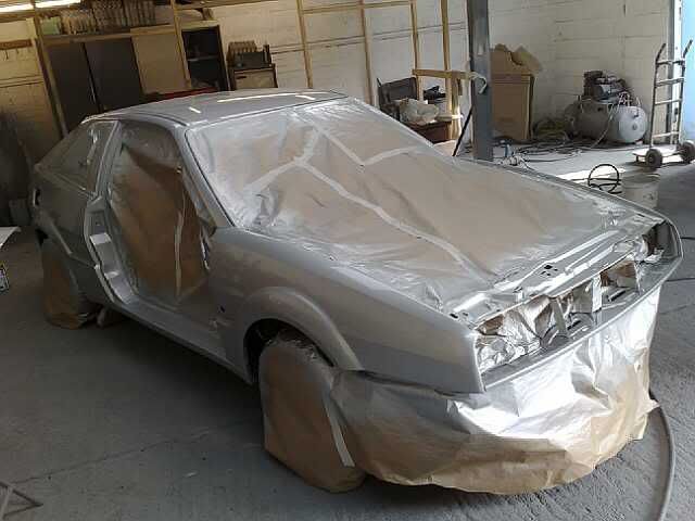

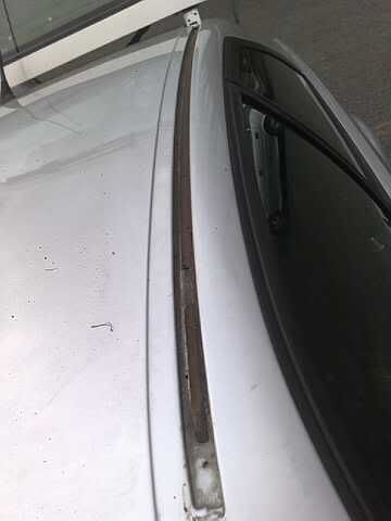

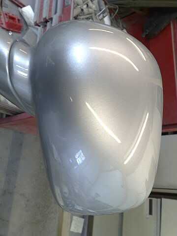

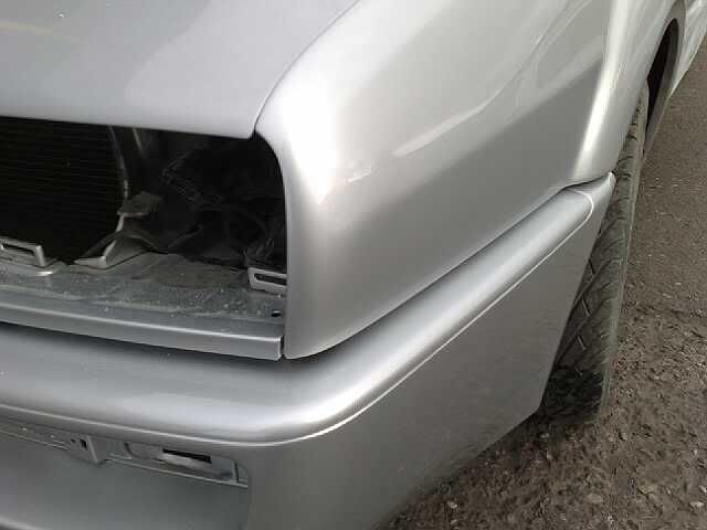

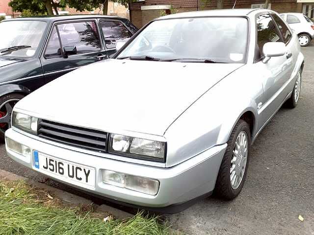

ok, so time for the paint work pics..... 8)
and here comes the rebuild.......

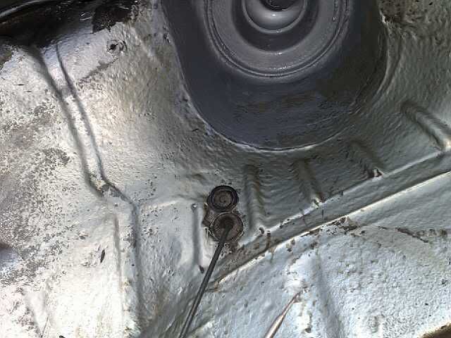

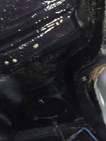

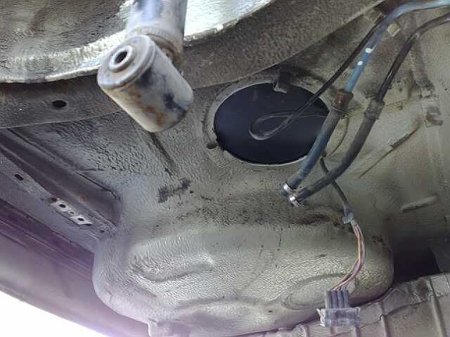

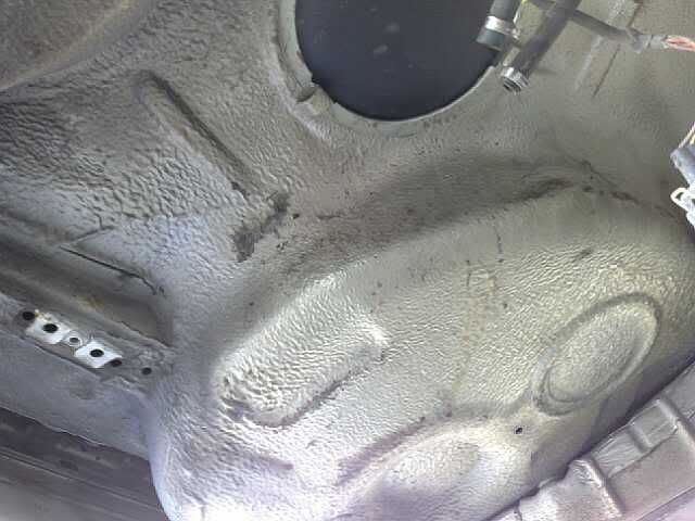

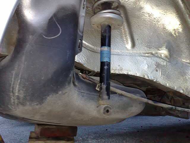

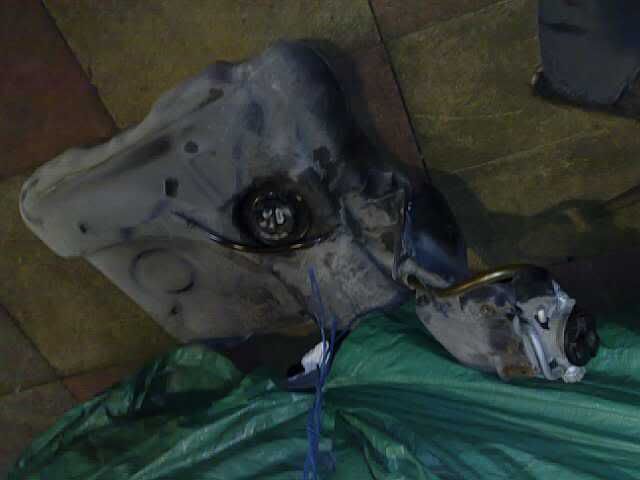

car was then jacked up and both rear beam and tank removed.......floors cleaned and a few bits of surface rust treated......all the floor was then painted gloss black, then heavily wax oiled.

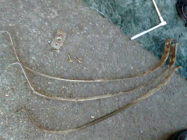

tank and tank straps....

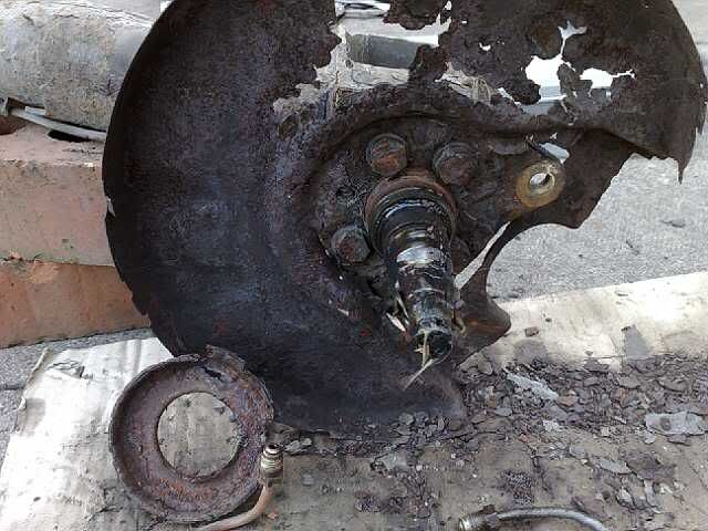

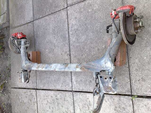

rear axle....

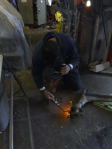

broken bolts.......heated out.....thanks MOTORZONE

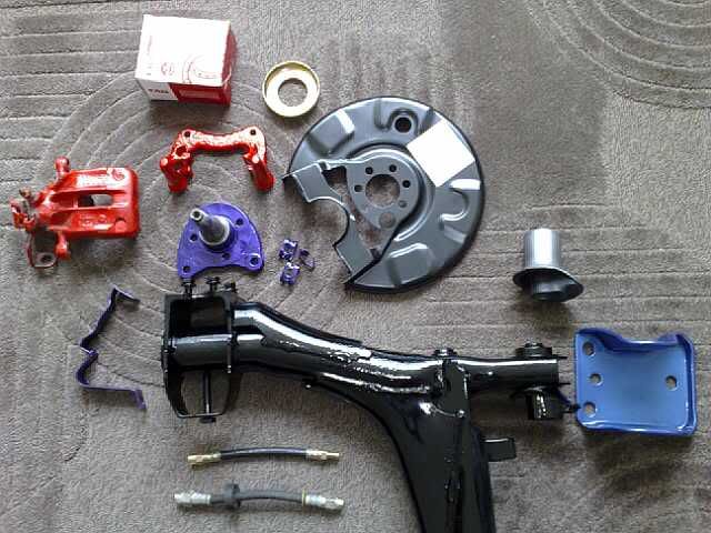

ok heres the best bits.....the axle rebuild....

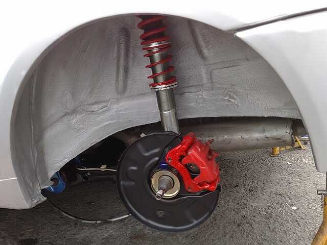

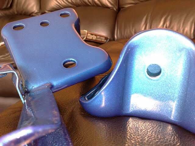

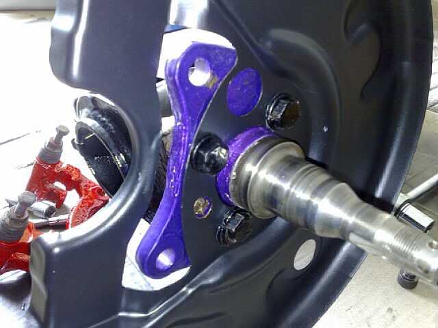

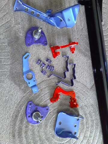

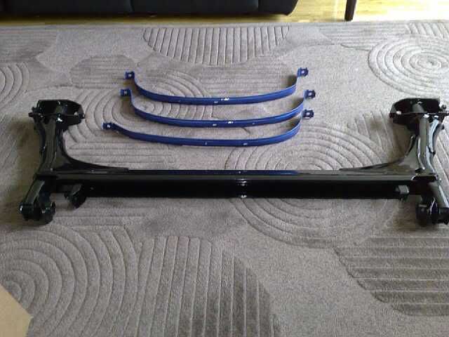

tank strips, rear axle, stub axle, hose brackets, axle mounts, carriers and brake hose spacers all power coated.

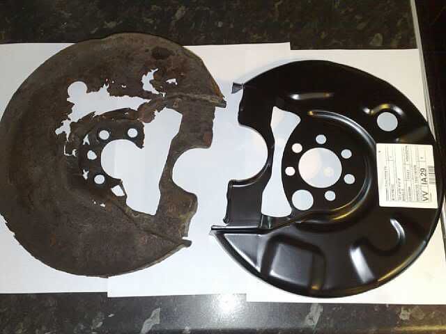

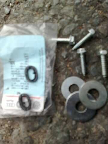

backing dust guards and inner bolt covers were replaced, new brack hoses, new discs and bearings, axle mounts(VAG)

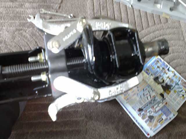

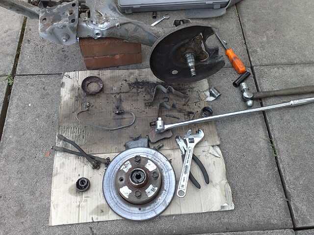

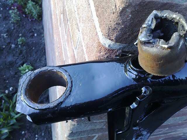

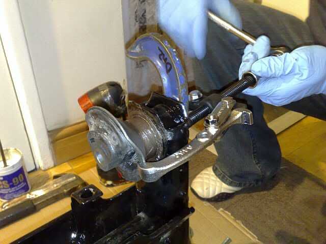

New rear bushes (VAG) fitting them........was a nightmare....
first push out the old brush with a pulley puller.
then cut the metal sleeve.
then slice the inner sleeves so it take the tension out of them
then a little hammering out.....and there out..... :censored:
time to press the new ones.....i made up a tool....two chasers, thread, few bolts, and plates.

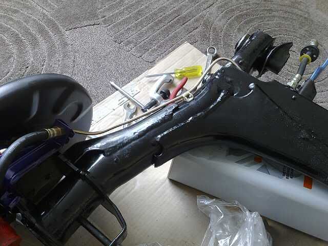

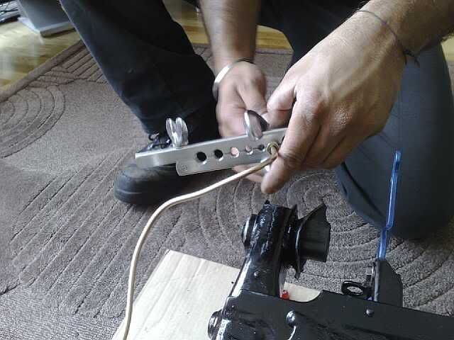

new coppernikel brake lines..

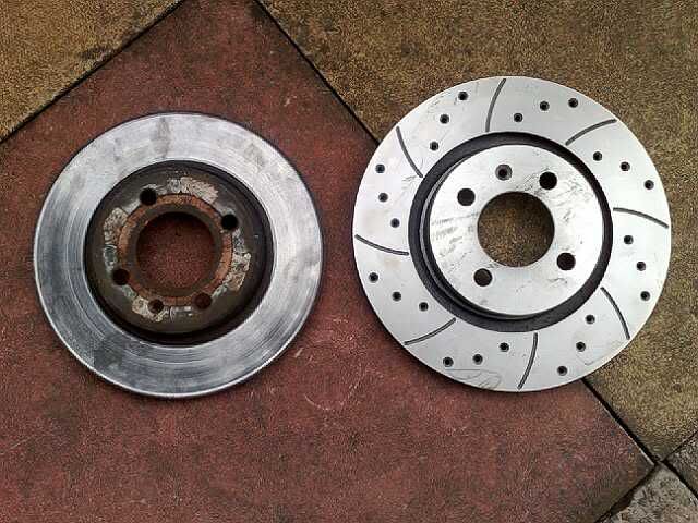

Upgraded Discs will new bearings fitted...

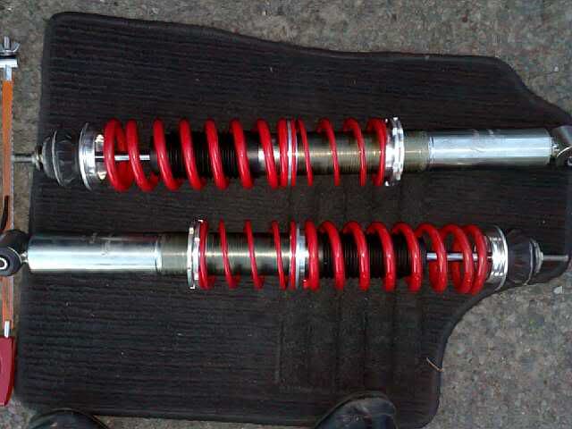

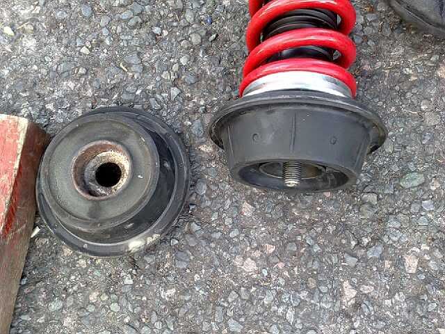

coilovers fitted with new top mounts

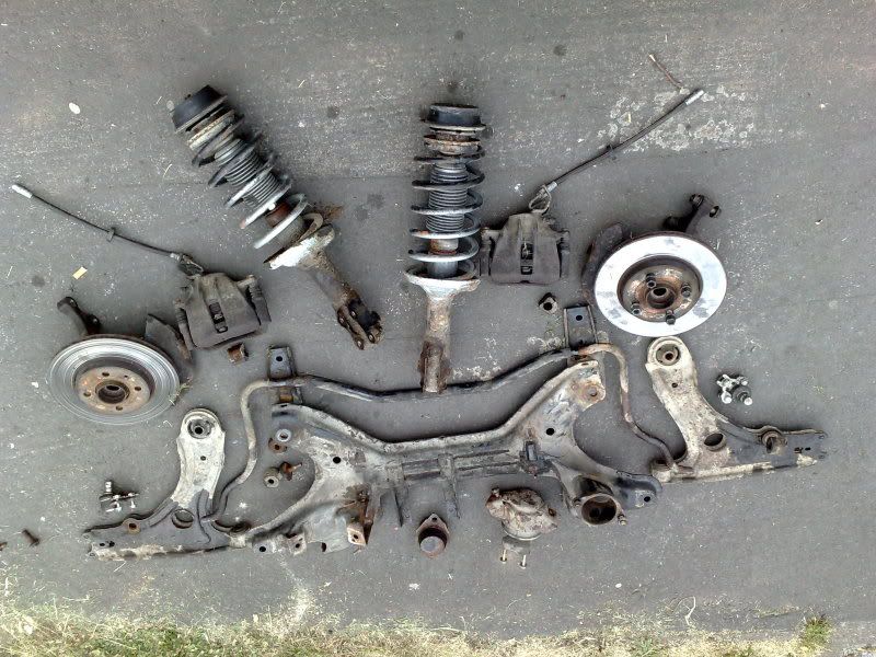

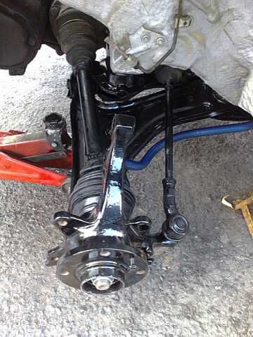

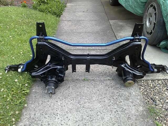

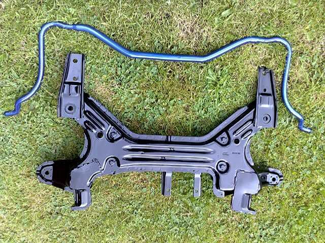

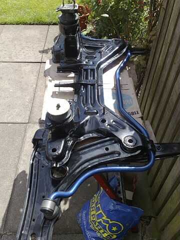

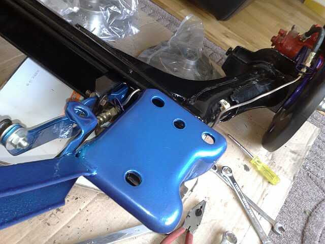

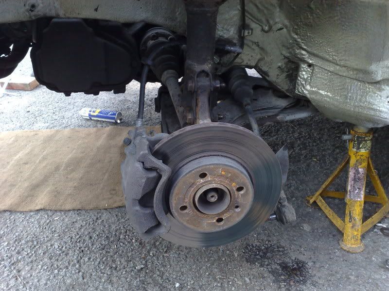

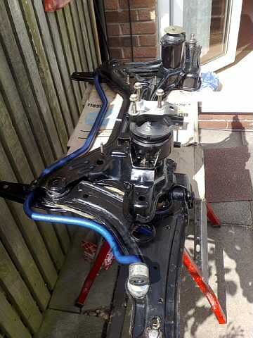

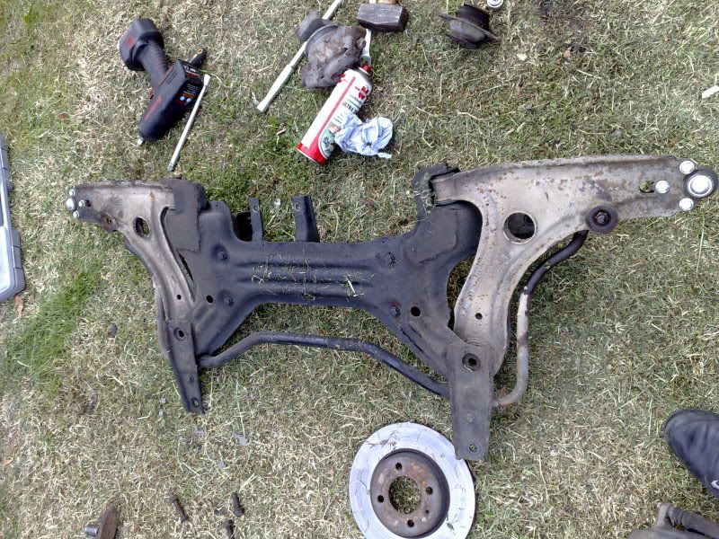

ok now for the front subframe.......
started striping it down...
ok so away to power coat and this is what i got...

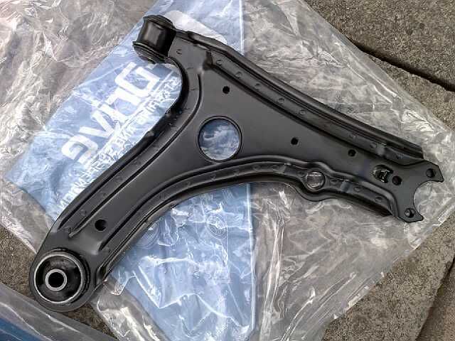

new wishbones with bushes, new engine/gearbox mounts,drop links, anti roll bar bushes,ball joints.
the subframe and wishbones were hammerited for extra protection, then all cavities filled with wax oil, and a light covering over the tops.

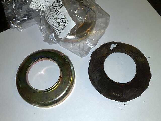

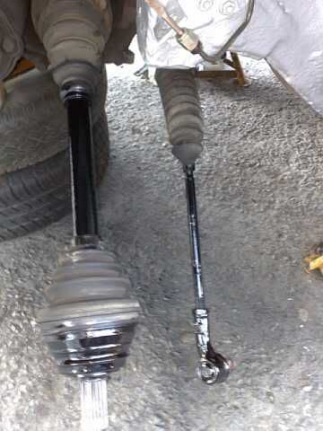

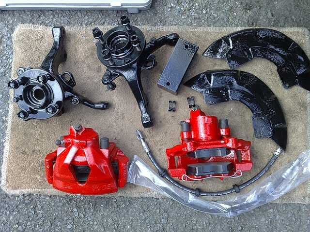

New brake hoses, VR6 calipers, New pads,New discs 280mm, New top mounts, New steering Rack bushes,CV boots and Coilovers.Hubs, backing plates and counter weight all Power Coated.
Rack recond...

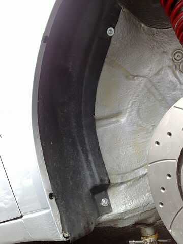

wheel liner and new bolts/washers

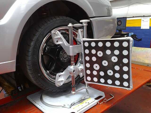

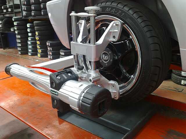

4 wheel alignment, camber setting and tracking....

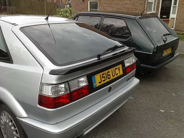

few other pics of the topic:

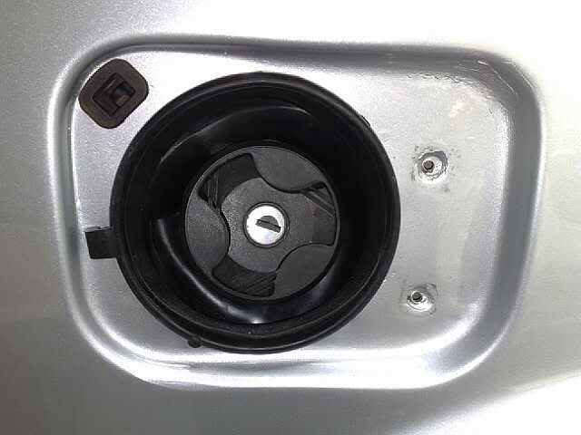

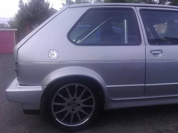

my mark1 golf: rallye front, evo 8 recaros, custom roll cage, caliper kit,noble petrol cap, audi 80 handles,16' ronals.

did you upholster the sunvisors, or you painted them?

thank you, the guy who supplys me with the roof lining material, gave me this "special spray can" no name on it, but it does is sinks into the plastic and makes it look like factory finish, cant tel you how impressed i am with them.

ilove corrados in silver, how much was the spray job if you dont mind me asking? looks a goodun!

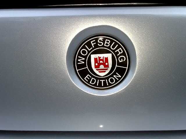

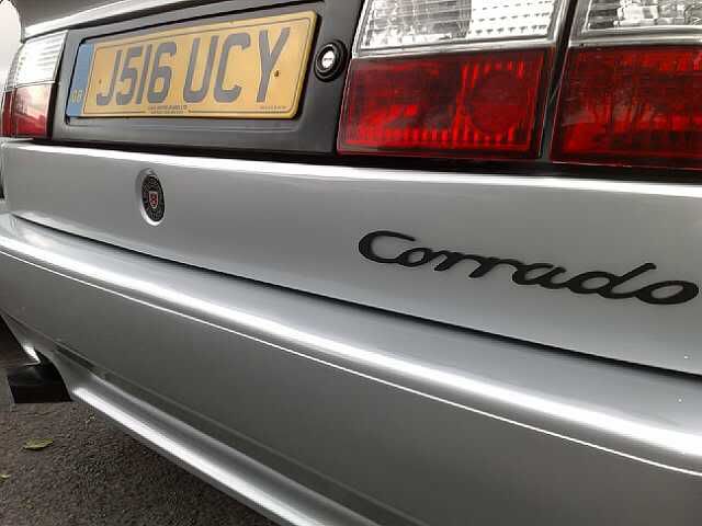

You gotta ditch the Wolfsburg badge though - Corrados were make in Osnabruck :wink:
its wasnt cheap .......it was at "mates rates".....you got remba this is my daily runner...so i wasnt bothered with minor bits and bobs .....
yeh i sure there thing everyone would change......if you can find me a badge with "Osnabruck".....i'll change it.....if it looks good.... :lol: :notworthy:
