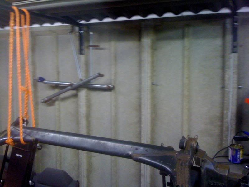

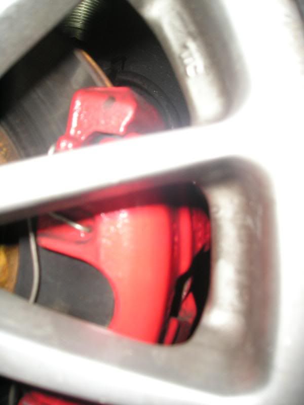

24V Renshaw 0 Posted December 19, 2009 Well......... I have been fairly busy on the basic mechanicals over the last couple of weeks, alongside building nursery furniture and buying prams etc.. :) Started by removing the complete rear beam and replacing/upgrading every single part. Stripped the rear beam, fitted brand new OEM bushes as the old ones had seen better days! Then proceeded to create a make shift hoist to support the beam as I carefully pressed the new bushes into the beam, using a vice and some careful movements so not to damage the new bushes. Managed to fit all that and then fitted the following to the rear beam. (No pictures sorry) - New MK4 Golf rear calipers and carriers. - New OEM rear pads - New OEM rear discs - New OEM Rear Bearings - New Goodridge braided hoses. - New OEM handbrake cables (had to move the handbrake over by an inch for the boxster centre console so did that at the same time) Also fitted rear Bilstein Coilovers and new AP front coilovers too. While I was replacing the rear brakes I figured I might aswell do the front, so rather than replace the boggo 280mm stuff I got a full almost new 312mm setup of a TT, complete with Mintex pads. Also picked up some wheels to go with the Clubsport theme I will be running eventually...... Chassis and brakes are now million times better than it was and the first step towards making this a nice daily, as it was/is cold, uncomfortable, scary and noisy! LOL Also set the tracking using my home made tracking gear. It simply consists of nice straight poles which attach to the wheels, one with a laser pointer at 90 degrees to the pole, the other with a mirror on it. If the reflection of the laser is not straight back, the tracking is off. Simple and free!! :) INTERIOR ------ So with the chassis progressing I focused my attention on the interior again. With the dash back out I wanted to fit the Boxster climate control, which in principle is the same as the MK4 golf/Audi etc.. climate control. Having fitted the passat one before I decided to get the fan and ducting part from a Passat as its slightly different to the MK4 golf one. The main difference is the way the air-con pipes go through the firewall. On the golf its a big plate with lots of holes and a complex seal. On the passat its one big hole with one big seal This can be made to fit by cutting 3 x 50mm holes in a triangle and then filing them to create one neat hole that matches the passat seal. The easiest and neatest way to do this is with a 50mm panel punch. Pictures tell a thousand words so...... Fitted a brand new Corrado heater matrix while I was there. Then by modifying a couple of the Passat brackets and drilling an extra hole in the firewall for the studs that hold the heaterbox in, it was done. Wired it up and it works no problem. Unfortunately I don't have a fan motor (its in the post) so the drives to work have been a little chilly this week LOL!!! Now the pretty bits :) For the interior I am going for the style and feel of a GT3 Porsche. With the dash the obvious choice really. So. I had previously acquired a 997 Porsche steering wheel, but it was a cream leather one with a blown airbag. Having had a quick chat with my best mate and general interior trimming genius Doug (tribetypefourty) we decided it would work well in alcantara. A few steps reconstructing the airbag with foam and filler and some nice trimming work you end up with a GT3 style wheel. All credit to Doug for the work on this. Top man! Finally my other investment this week. A set of Kevlar Composite FIA Approved buckets, to continue the theme, currently stored under my mate Vicks christmas tree until I collect them next week. Should look good with the dash and the stripped out back end/ roll cage ;) Its coming along slowly :) Jay Quote Share this post Link to post Share on other sites
