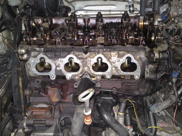

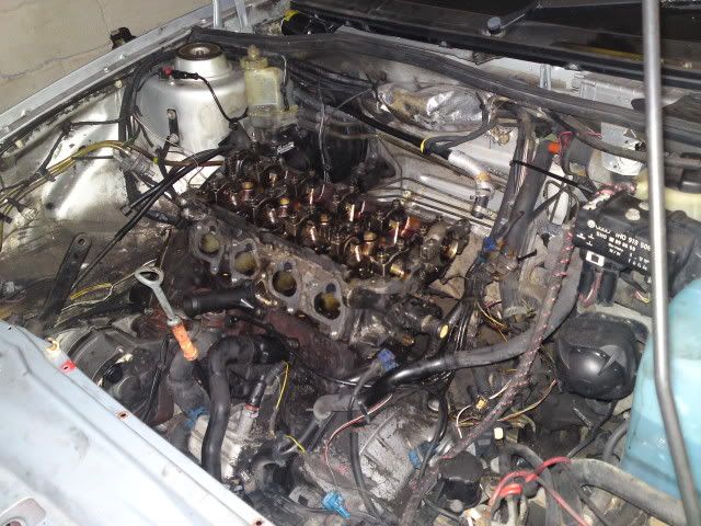

Kempy 0 Posted September 25, 2009 What a mess :clap: If anything looks not right, do tell Quote Share this post Link to post Share on other sites
Kempy 0 Posted September 27, 2009 dunno what to do next :| suggestions please... i was thinking clean it... Is there anything I should do with the bottom end, change the oil? Ive not done anything remotely like this before so any help would be appreciated Quote Share this post Link to post Share on other sites
aide 0 Posted September 27, 2009 dangerous request as there's loads you can do :D easy stuff like cleaning the block, taking the sump off and cleaning, draining and flushing coolant harder stuff like stripping and cleaning water pump, oil cooler, new filter, breather assembly, coolant pipes harder still checking crank and shell bearings, oil pump, end float :) get urself a 16v haynes, even if a 2ltr would provide a good guide.... Quote Share this post Link to post Share on other sites
