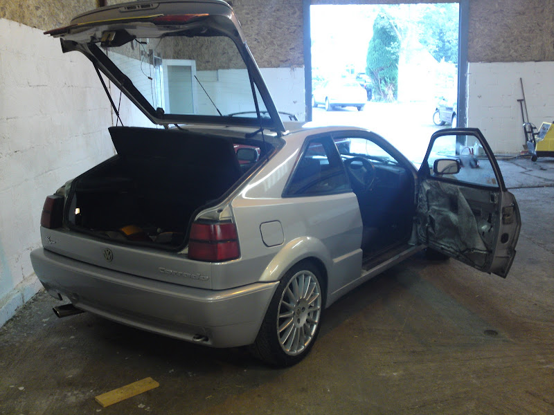

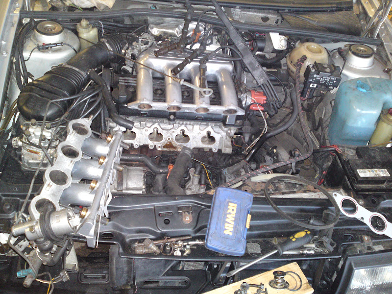

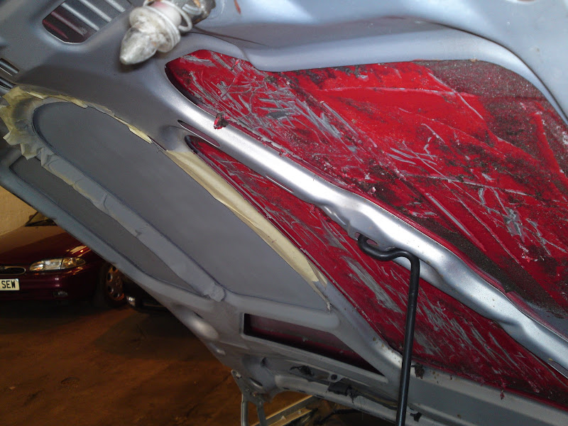

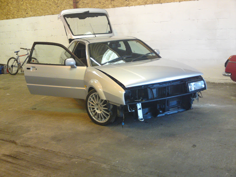

Kempy 0 Posted June 20, 2010 Apparently before I started working on the car today, my mate fired it up 1st time and it idled :) looked like this when I left :eek: I done lots of fun stuff on the car today: firstly I took of the lambda probe so that I can extend it to fit the 4 branch, easy Removed lower manifold to gain easier access to the water flange at the front because it was leaking when the car was running, it got hot too quick to, so I decided to remove the thermostat ( never done these before ). Turns out the thermostat is bust so that'll help the overheating I hope. The flange needs replacing, the lip where the seal goes was broke A little worrying was that there was a little mayo in the flange, could that be something to do with it being a little bit of oil somewhere during my rebuild, would some coolant flush sort it??? :shrug: So I need a couple of new gaskets, a flange and water seal, and a PS pump belt, coolant bottle cap conversion maybe.... Then I think it'll be cool, just need a sesh with a strobe for the timing :D Quote Share this post Link to post Share on other sites
Kempy 0 Posted June 27, 2010 getting slowly nearer to a running engine :D I do seem to take 3 steps back and 2 forward though but I'm learning from my mistakes. Most recent one being over tightening of the copper seats for the fuel injectors in my manifold. need to replace the plastic guide tubes and the seals :? I recently bought A thermostat - fitted today Belt for PS pump - fitted today Also replaced as many as possible of the annoying hose clamps with jubilee clips.. FTW New flange on the front of the head after cracking the lip on the inside - fitted today (need to do same job on the daily :censored: ) New coolant tank - not fitted till I flush the system once the manifold and fuel injectors are refitted I will get the timing sorted and engine flushed Then I will need some disks and pads and 4 new Tyres :censored: getting there Quote Share this post Link to post Share on other sites
Kempy 0 Posted June 29, 2010 Had to replace the injector inserts and seals today, so I did that and fitted new gaskets to the manifolds. She fired up 1st time :clap: and Idled nicely. I will need timing on the strobe though. I ran the engine till warm and it appears that I got no leaks :clap: thermostat works to. But.. the fan never came on and I didnt get any readings on the MFA nor the needle. I need to test the fan off the battery. I cant remember if the needle worked before TBH or the MFa Oil temp. What can I do to fix these few things? a little vid of it running :D [youtube:1swjn0a3]iTnbgRTPugc[/youtube:1swjn0a3] Ive also started to paint the underside of the bonnet, its taking a while :roll: Quote Share this post Link to post Share on other sites

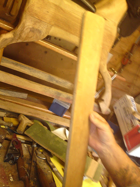

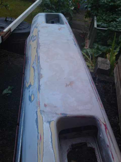

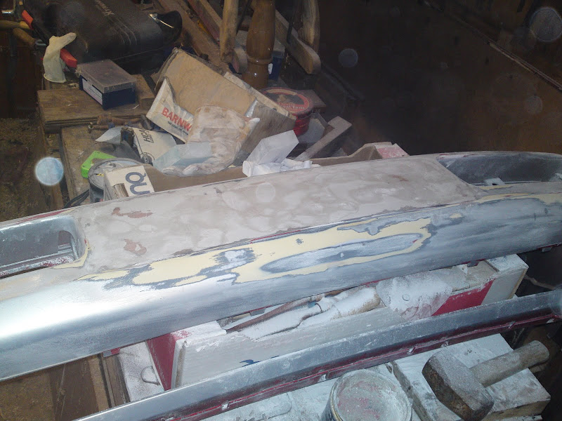

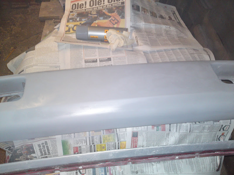

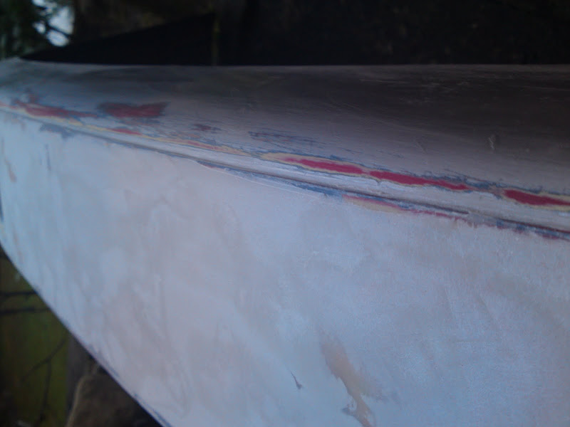

Kempy 0 Posted July 13, 2010 ok yesterday I started this job, my granddad and I decided to use a plywood plug for the recess. I wasn't sure about this to start tbh and still not sure how it'll last over time. Anyway I cut the shape out on the ban-saw Then I chambered it a bit as the recess is bigger at the bottom that the top. Then countersunk some screws into it and the bumper. Once it was in place I planed the top a bit and around the edge of the plywood. Once I felt that I done that enough I fibre glassed around the edges and the top to build it up more to create a better shape. Once that went off I smoothed everything with filler ftw. then I couldnt resist putting some paint on it.. just see my handy verk Quote Share this post Link to post Share on other sites
OllieVR6 0 Posted July 13, 2010 Great stuff mate, this is something I want to do, and wasn't sure how to begin. I'm not starting it yet so I'll wait to see how it looks in a few months, can't see it being a problem though! Quote Share this post Link to post Share on other sites
Kempy 0 Posted July 14, 2010 theres a few ways you can do it i suppose. how are you thinking about doing it? you could fill it all in but i think that might weigh lots. with all the sanding theres only a small amont of filler on mine Quote Share this post Link to post Share on other sites
