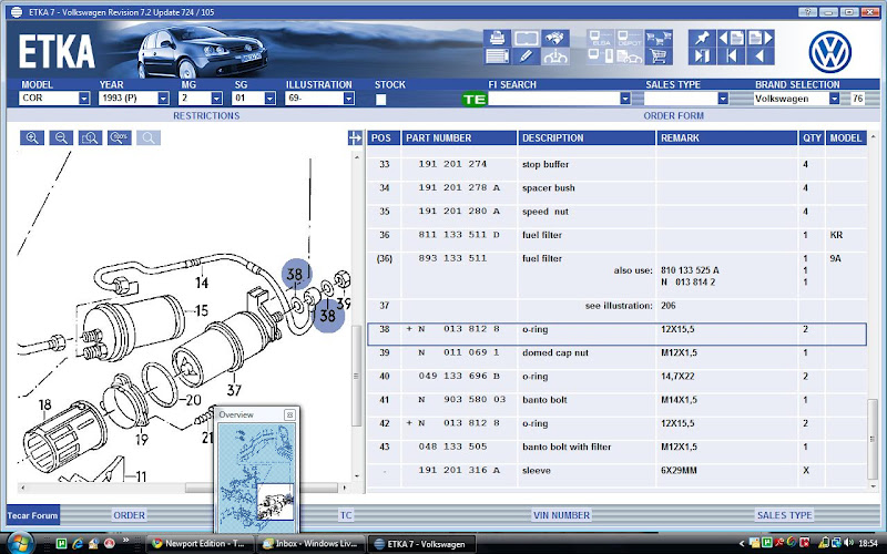

Kempy 0 Posted November 11, 2010 Right got a problem with my fuel pump, its still leaking from the end where the feed comes in from the accumulator. Just been browsing Etka and it shows 2 O rings, Ive been using copper washers. Now what will I get from VAG when I order the O rings? Rubber or copper, Im thinking I should get the feed if they are still availiable its waiting somebody with a mechanical brain :scratch: Quote Share this post Link to post Share on other sites
davidwort 0 Posted November 12, 2010 they can be copper, or soft alloy and sometimes have a rubber insert/edge on the inside, as long as it doesn't leak it'll be fine :) all these washers/seals should strictly speaking be renewed when removed, but like sump plug washers, in reality they can be re-crushed and get away with it. Re-used mine when I did the KR fuel filter. Quote Share this post Link to post Share on other sites
Kempy 0 Posted November 12, 2010 ive put new copper ones in and it just still leaks from that area? Quote Share this post Link to post Share on other sites
davidwort 0 Posted November 12, 2010 must be some other damage then, it's pretty high pressure compared to most fuel systems but the unions should only need nipping up to seal fine. Quote Share this post Link to post Share on other sites
Wild-Animal 2 Posted November 12, 2010 hmm, if your thinking of changing the pipe with the banjo bolt fitting, i dont think it will be cheap, i have ordered the bit of pipe from the fuel filter to the accumulator, well just ordered one that will cost me £37 its about the same length, other than tighten up the banjo bolt a bit more ? Not sure, i presume you have the washers in the right place. I could imagine it will be really annoying you! Quote Share this post Link to post Share on other sites
