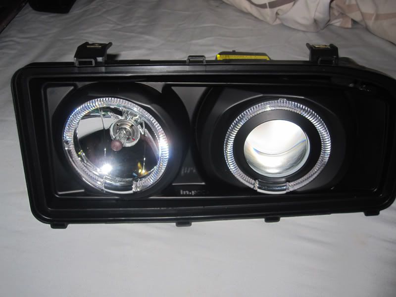

UseOnceDestroy 0 Posted February 4, 2010 I've bought myself a pair of inpro headlights too, just arrived today ... I love them, think they're a 100% improvement on the boring stocks. I haven't heard about this adjuster problem though, anyone care to explain ... Can't I fit them directly out of the box? ... What are the blue xenon bulbs like that are supplied with them? Cheers Quote Share this post Link to post Share on other sites
millerman 0 Posted February 4, 2010 I've bought myself a pair of inpro headlights too, just arrived today ... I love them, think they're a 100% improvement on the boring stocks. I haven't heard about this adjuster problem though, anyone care to explain ... Can't I fit them directly out of the box? ... What are the blue xenon bulbs like that are supplied with them? Cheers you need to take em apart (lenses off and light holder out look behind the projector and there is a little alloy lever and a screw securing it you need to make sure its on R if not undo the screw and move it and then secure the screw again and put em back together) simples :lol: Quote Share this post Link to post Share on other sites

UseOnceDestroy 0 Posted February 4, 2010 Right ... I got the lens off ... now what?! I'm too scared of breaking something!! There is a phillips screw on the back, is this the adjuster? Quote Share this post Link to post Share on other sites

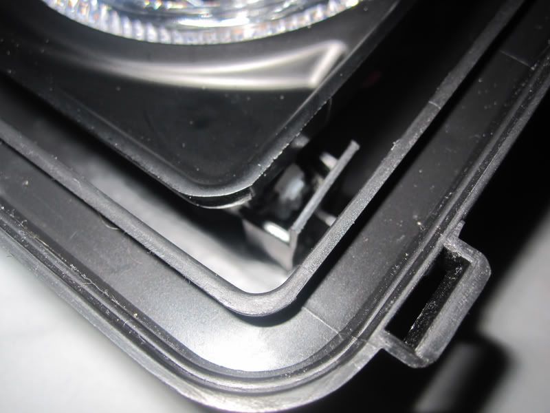

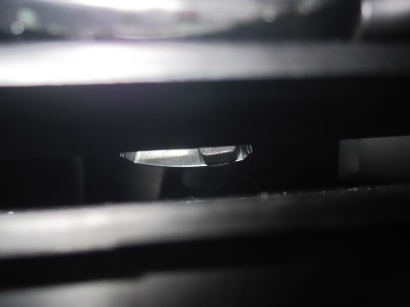

UseOnceDestroy 0 Posted February 5, 2010 Fuck me this is frustrating!!! I have removed both adjusters from my old headlights, so theyre ready to go into the inpros ... I had no problems dismantling the old headlights, I assume you dismantle the inpros in the same way but it wont budge, is there an easier way to get to the lever? I can see the lever under the projector but I can't get to it. I can't drive my car until this problem is sorted so pleeeaaasee someone help soon!!! :notworthy: Quote Share this post Link to post Share on other sites
millerman 0 Posted February 5, 2010 Have you removed the plate that holds the lights as you need to get behind the projector there you just undo the screw slide the little silver lever across and do the screw back up and your done post some pics so I can see where you at Quote Share this post Link to post Share on other sites

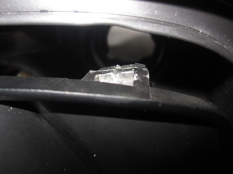

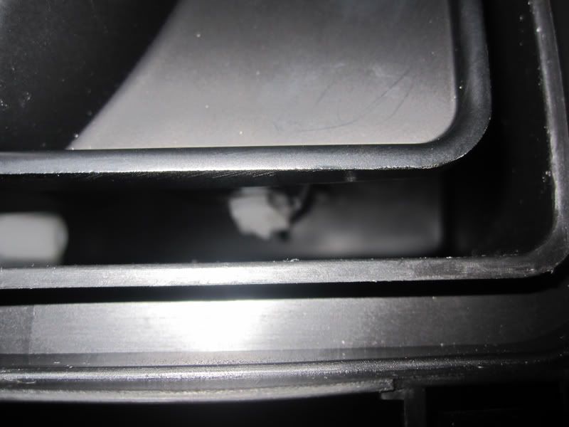

UseOnceDestroy 0 Posted February 5, 2010 Have you removed the plate that holds the lights as you need to get behind the projector there you just undo the screw slide the little silver lever across and do the screw back up and your done post some pics so I can see where you at No I haven't removed it yet, it wont budge ... I have managed to remove one white clip where the adjuster will fit ... (the existing white clip is now trapped in seeing as I can't get the other 2 out!!) ... Its as if the white clips are glued in, there is just no play at all. I'm guessing this is the lever ... Do you know if this is in the correct position? ... Either way I need to take it out so I can remove the white clip where the adjuster goes ... Quote Share this post Link to post Share on other sites
