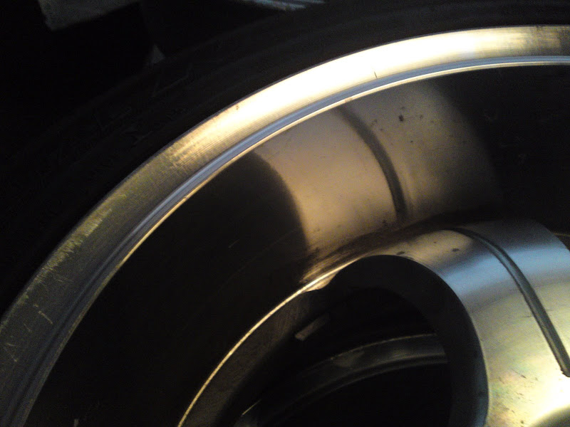

Kempy 0 Posted February 11, 2010 I bought some wheels a while back, I was gonna satin/gloss black them. But I fancy having them shining. I dont know whats on the wheels, Is it paint? It looks metallic. http://lh4.ggpht.com/_eSCB9GKVOx0/S3RRA ... 010011.JPG http://lh6.ggpht.com/_eSCB9GKVOx0/S3RQ6 ... 010010.JPG thanks again for help in advance :salute: Quote Share this post Link to post Share on other sites
coullstar 0 Posted February 11, 2010 Thats just lacquer damage. There has been little area where the lacquer has lifted and moisture has gotten underneath. This then causes localised corrosion which appears a milky colour. Only way to get rid of is remove the lacquer using Nitromors then polish out the corrosion. Quote Share this post Link to post Share on other sites
Kempy 0 Posted February 11, 2010 theres no paint on these wheels then? just clear coat Quote Share this post Link to post Share on other sites
VR6 South 0 Posted February 11, 2010 theres no paint on these wheels then? just clear coat That's right! Quote Share this post Link to post Share on other sites
Kempy 0 Posted February 11, 2010 tidy...I'll give them a good refirb asap Quote Share this post Link to post Share on other sites
OllieVR6 0 Posted February 11, 2010 Just as a side note. Nitromors is the most horrible, messy and frustrating product that I have ever worked with, I promise it would be worth the money to get someone to strip them for you. Quote Share this post Link to post Share on other sites
Critical_Mass 10 Posted February 11, 2010 Just as a side note. Nitromors is the most horrible, messy and frustrating product that I have ever worked with, I promise it would be worth the money to get someone to strip them for you. Aye i had to do the same on some polished rims. The laquer comes off like slime. Wear gloves because it does BURN if it gets on your hands! Quote Share this post Link to post Share on other sites
Kempy 0 Posted February 11, 2010 Ive used it before, I got the foam stuff atm and I tried to use it on a slam panel but it dont work cause its celulose I think? Quote Share this post Link to post Share on other sites
