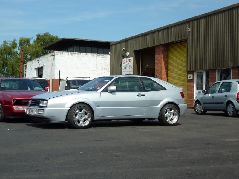

rsgntx 0 Posted June 23, 2010 thanks for the photo! i raised the struts before dropping it off looks better when its dropped an inch! :D Quote Share this post Link to post Share on other sites
