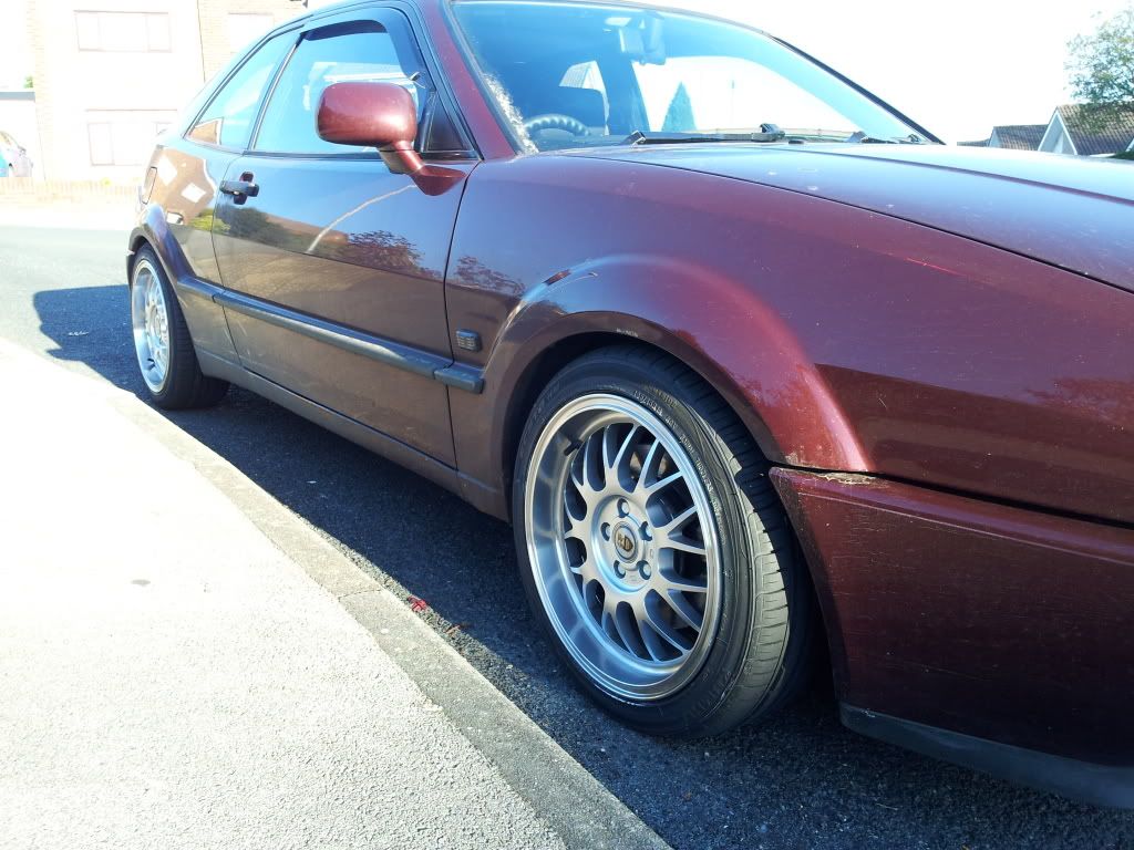

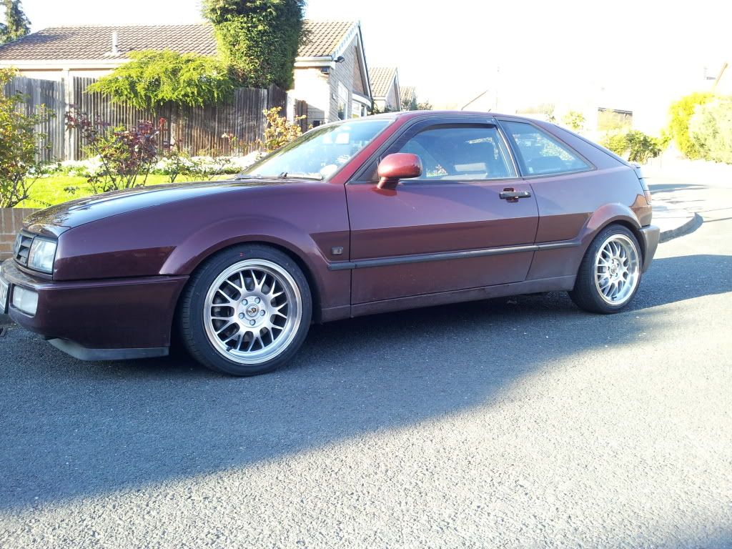

Cheers guys, appreciate the comments and the help. Note the centre caps have got to go on yet. Looking at the pic im not 100% sure the centre caps on the rears will fit due to the bearing end cap. But nothing a small spacer wont sort - i do have 10mm spacers to go on the back too but think it'll push the wheel out too far and car arch to tyre contact. I do have some 5 x 100 3mm spacers that are currently on the fronts if needed. THere's also a bit more arch gap compared to the 205/45 tyres, so depending on how it rides with all wheels on i maybe able to go a little lower. But not sure yet, ill see how it goes :D
As for the wheels themselves, they're by no means a BBS but certainly look the part and a very good price too, im really happy with them. Im chuffed that they fit and am now able to keep them :D :D :D
Im going to have to tidy those calipers up :lol: they let the look down a little. I did paint them silver as i dont think red goes with the colour of the car, but the silver hasnt lasted long - it was only VHT paint. Maybe a sandblast and powder coat is in order. :D
Watch this space, i'll put more pics up once i get chance to get all the tyres fitted to wheels and wheels on the car.
Cheers!
Well FINALLY got he wheel fitted. They look stunning and the arch gap isnt as bad as i first thought.
One thing that has really wound me up is, when torquing the bolts up the socket has chipped a couple of the wheels around the bolt holes. Going to get some oil based paint and touch up these parts. But im annoyed its happened at all.
Also, the rears scuff the arches a little when going over larger bumper/speed bumps, there's 10mm spacers on the back, need to get a bit machined off them. But not too much or the centre cap wont go on.
Will get some pics up asap..camera battery was dead when i came to take pics.

When I had a set of these on, I just gently tapped the bearing case thingymajiggy more flat, centre cap went on fine then without spacers!! Although this meant the front was 26mm in total wider than the rear as I had 13mm spacers on the fronts.
I wouldn't have been able to fit any spacers on the rear as mine was pretty low.
Be careful where u go to get the spacers machined if u decide on that - obviously the machined surface needs to be as square as possible, and as a qualified CNC/manual machinist I know that it takes a little time to set up the machine so it will turn the face square - don't ask any old company to do it!! :)

You can get 17mm sockets with a nylon sleeve, to protect against wheel damage. Or do what I do and wrap a socket in masking tape.
I've just fitted 195 45 16 tyres on a 7j and they look very good. I've also found that different tyre brands can alter the way the sidewall stretches (or doesn't).
Wheels look great by the way.
Cheers Jamie, i'll get some pics up later.
Yeah i put a bit of cloth over the nut before putting the socket over the top when i realised what had happened. didnt think of masking tape - cheers i'll do that too until i get a nylon sleeved socket.
Ive found the Khumos seems to look rather good and dont really look stretched at all tbh, the rears scuff a little on large bumps but not too bad. A couple of millimetres off the rear spacers should sort that out.

Johnny - the spacers were free. The place i bought the wheel from sent me them. they're hub centric, but the bolts go all the way through the spacer which are drilled at 5 x 100 and then into the disc. I also have 50mm long bolts - need longer locking nuts too though. for the record the wheels are Cades Eros, mine are 16" but are available in 15 and 17" all 6.5j
Jake - Yes got 10mm spacers on the rear too. For some reason they didnt slide over the centre of the discs as easy as the front went over the hubs - needed some persuasion to go on. The tyres scrubs slightly over large bumps so i was going to run with out the rear spacers. But like you discovered the centre cap wouldnt go on. I didnt want to break it either so put the spacers on. Think im going to get a few mm shaved off them so they clear the arches more. have you just got 10mm spacers on the front?

I have 13mm spacers on the front of mine atm I get a slight bit of arch rub if I enter a corner hard but for normal driving its fine. Just need to bring the backs out to make it look more in line with the front.
Id say about 8mm. The odd thing is the spacers are 10mm so im told. But theres a lip on either side of them which is 1 mm each so they're actually 12mm thick spacers. Very odd to advertise them as 10mm but they're infact 12mm. Still that can be sorted if necessary.
So really theyre 12mm on the front and there's ample gap between the spokes of the wheel and the caliper, a good 5mm id say. So 12mm on the rear, but yeah id say about 7mm is only required to clear the cantre cap. When i tried them on the back i put 3mm spacers on and that wasnt enough to clear the centre cap, again another 4-5mm would have been sufficient.
