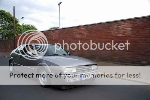

Iv been looking at these as well, iv only seen one or two corrados with them fitted but they look great, im tempted to get a set.

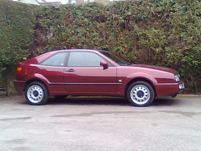

Here's a pic of my 8V with them fitted, I also had 280mm brakes on it:

I ran g60 steels on my rado and fitted fine over my 288 brakes and had 20mm spacers on the rear and looked great!
hope this helps
I was worried with it being lowered & them only being 15", they might look ridiculously small, but they pretty damn fine to me.
