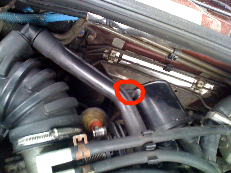

Rinse 0 Posted September 12, 2010 One of the 4 wires on the loom side of the Lambda Connection has been cut? Ran the car without the lambda also and was exactly the same. Going to get The garage to fix the connection, too short on one side for me to re-crimp it and given up trying to sort this problem myself. About to clean out the ISV but noticed a bit of an air leak here. What is this part and how would I go about sealing it? Quote Share this post Link to post Share on other sites
RW1 0 Posted September 12, 2010 The case shaped unit is the sound damper for the ISV. Not good if it's leaking around there. Be better off replacing. If its the pipe thats perished, then its 021 133 394B Don't know the price off hand. But £16 is typical. If its the damper case its 021 133 429A. Was quoted £10.90 plus VAT last week... instock at VW. . Quote Share this post Link to post Share on other sites
