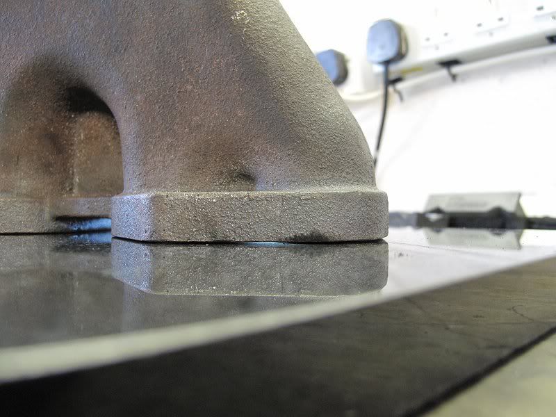

The most unreliable part of my turbo conversion so far has been the exhaust manifolds. 2 x crap copies of the SPA Turbo manifold cracked. 1 x ATP warped. 1 x Ebay ATP copy warped.

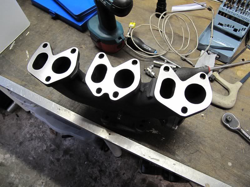

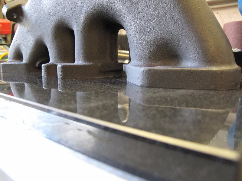

What happens is 1 and 6 ends of the manifold warp, as you can clearly see here on this flat surface. Probably because all the heat builds up in the middle, pre turbo, and 1 and 6 cool quicker (less metal)? :shrug:
This is the ATP copy I fitted earlier this year.

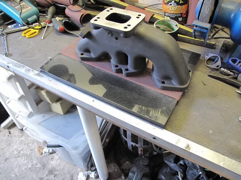

So I dug out the old ATP mani that warped last year and I set about skimming and prepping it for use again. I wasn't going to pay some bloke £75-£100 for 5 minutes work on a milling machine, so I bought a granite chopping board from Tesco (a dead flat surface is critical) and some emery roll and 'skimmed' it flat again myself. Not a bad job I think you'll agree :D
I also cut out the webbing between the cylinder pairs so that the runners can expand and contract at their own rate. I think part of the reason for the warping, as I say, was the heat was concentrated in the middle and because all 6 runners are joined together in one big log, the outer runners can't cool at their own rate, so started to pull up.....

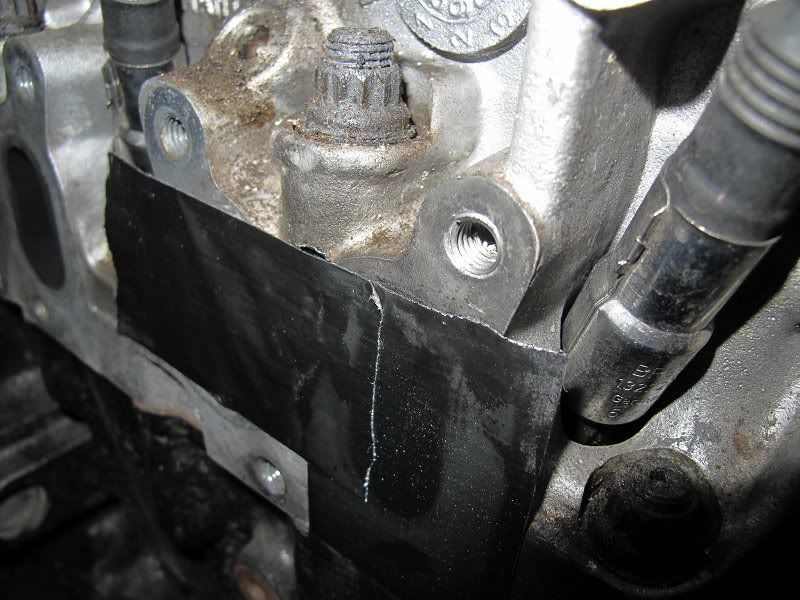

.....which on this occasion pulled out the upper stud on cylinder 1 because I was using ARP exhaust studs, which have no give what so ever. I've gone back to copper nuts and standard steel studs, which have more give. Better that than stripping threads in the head eh? :D

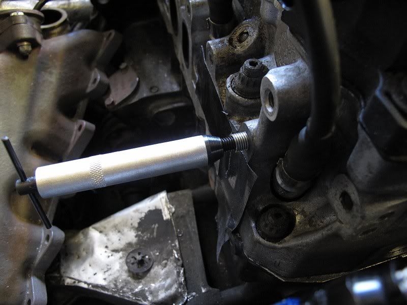

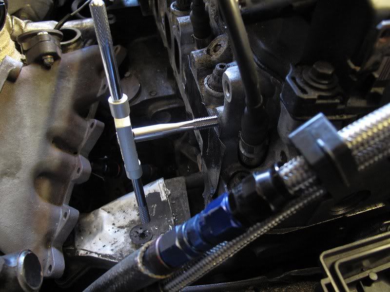

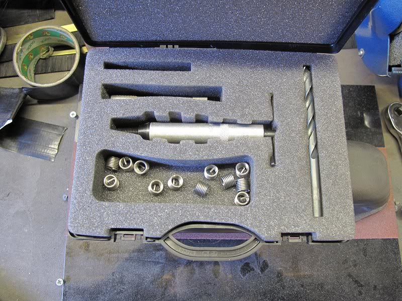

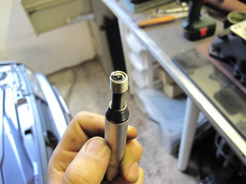

So I had to helicoil the thread. For those who haven't helicoiled a stripped thread before, it's pretty funky!
In the kit you get a bunch of thread inserts, the insertion tool and the correct size tap and drill....
First you drill the hole with the supplied drill, then tap it.....
Then stick a thread on the tool....
Then stick it in the hole!
Wind it in until the tool snaps the little tang off and job done! A nice new thread :D

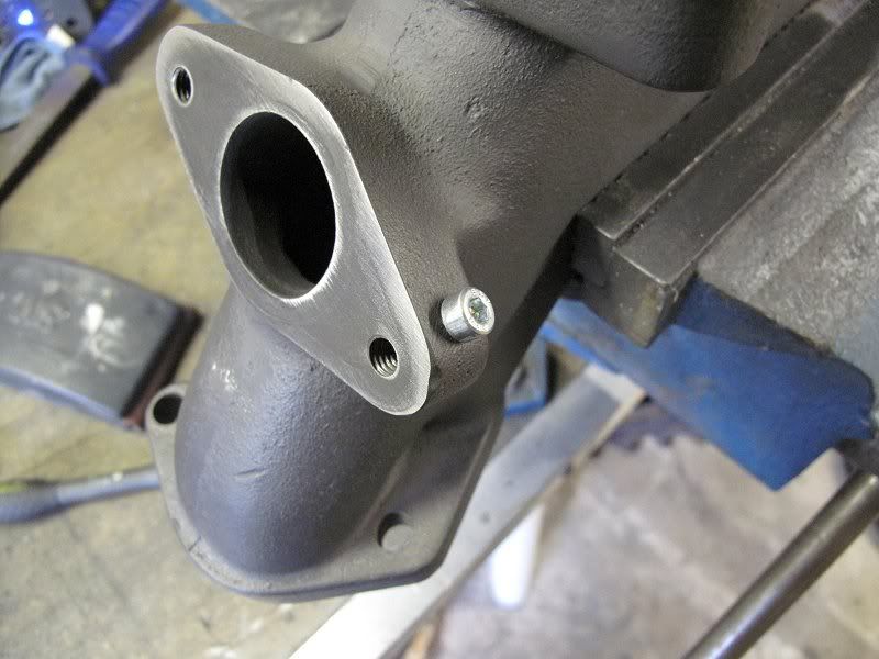

And whilst I was in the mood for drilling and tapping, I had issues with the Wastegate bolts winding out (another pants bit of design by ATP) causing a leak, so I solved that one too :D
I filed some flats on the wastegate bolts and then I tapped in some M5 bolts to stop them backing out....

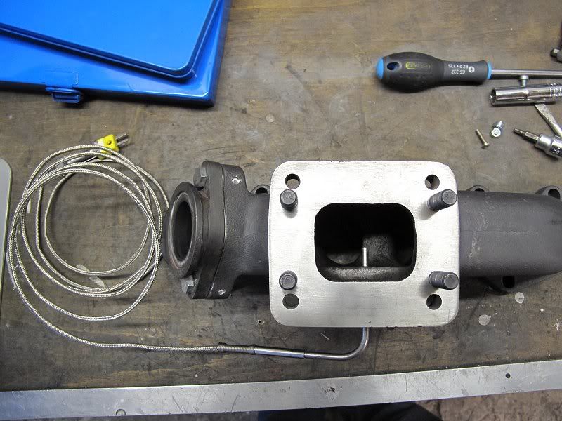

I put a new EGT probe in and pulled it out a little. I don't think it needed to be as far in as I had it before!

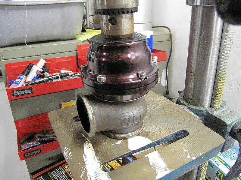

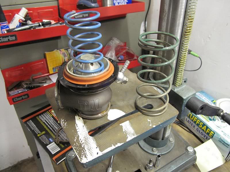

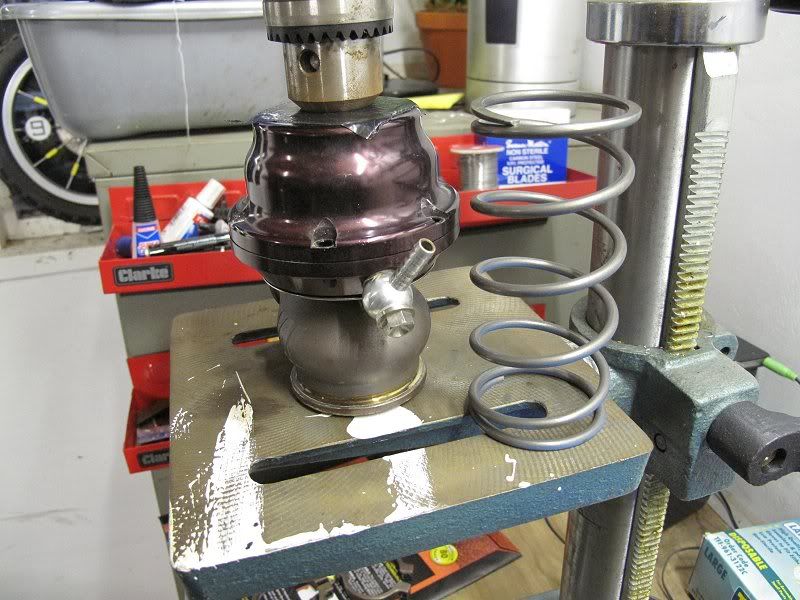

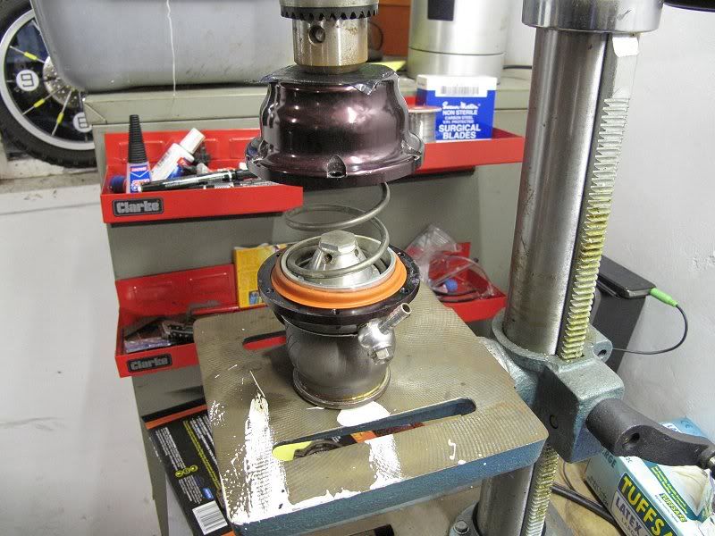

I want to run electronic boost control in the near future, so I decided to take the 13psi spring out of the Tial and put an 8psi one in.
You really need a deep vice or a pillar drill to do this. Get in position and loosen the plinth so that it can be wound down. Undo the bolts holding the lid on....
Here's why you need to open it gently, the springs are massive!! If you undo it in your hands, it will take your eye out or fly across the workshop once the last bolt twangs out.....
Lower the plinth down to expose the innards...
8psi spring goes in. Much larger 13psi spring on the right. As Haynes say, refitting is the reverse of removal but be careful to realign the lid with the bottom half and don't pinch the orange diaphragm. You'll kick your own arse if you do because it's very expensive to replace.

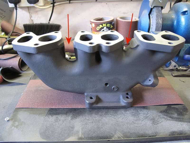

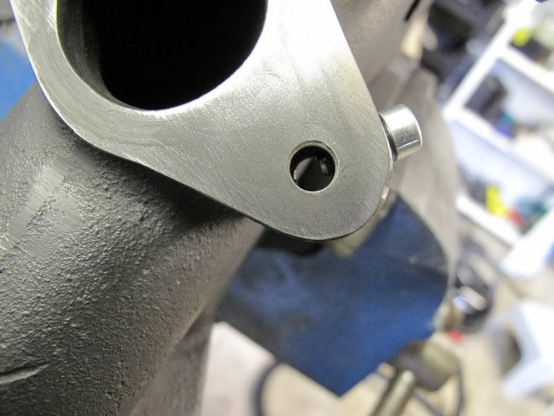

Some ATP manifolds don't have the stud holes drilled in the right place, which causes exhaust port misalignment, mine was no exception! So I elongated them with a file.
That's that done again! Hopefully my modifications will stop the warping problem. If it does it again, I will design and make my own manifold. Oh and I also added a manual boost controller for now directly onto the turbo scroll. Neat huh? :D

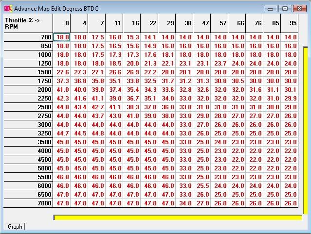

Fingers crossed this one lasts longer. I've lowered the boost to 8psi, modified the map and the exhaust gas temperatures are much more acceptatble now.

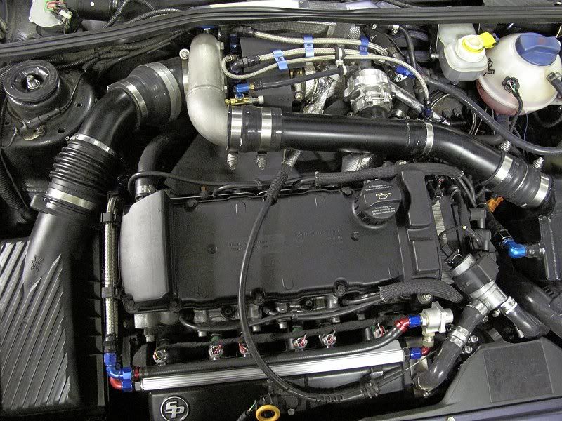

5062943287_3136721216_b.jpgThe spec...
Engine:
548bhp and 545 ft/lb of torque at 1.3 bar
- MK5 R32 Block
- MK4 2.8 4motion head and engine management
- Custom Remapped
- Cast Exhaust Manifold
- Tial wastegate with 1 bar spring
- Precision engineering 6262 Turbocharger
- JE Low Comp Pistons
- PEC Rods
- C2 Motorsports short runner manifold
- 630cc Injectors
- Custom 3" downpipe
- Wastegate Screamer pipe straight to the floor
- Single resonator exhaust system
- Twin fuel pump setup
- Greddy profec b spec II boost controller
- HUGE intercooler
- custom boost pipes and heat shielding
- double platinum denso plugs
- semi wire tuck with everything running through the inner wings
- baffled sump
- full set of VF-Engineering engine mounts
- ARP head stud kit
- Mocal oil catch can
