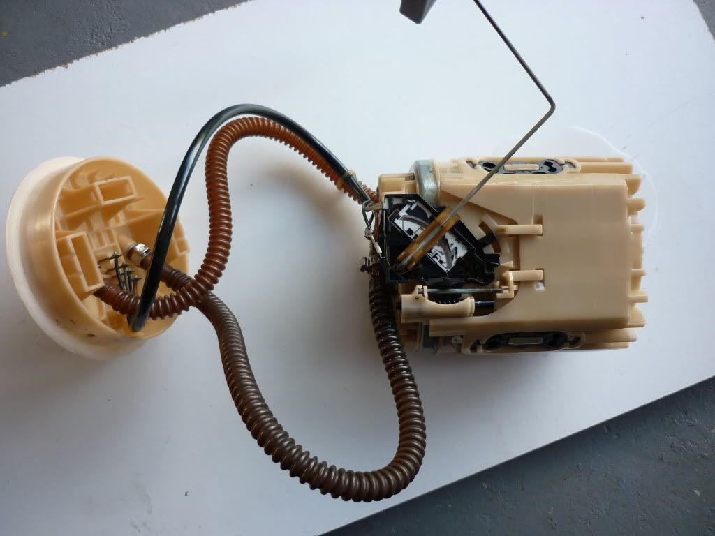

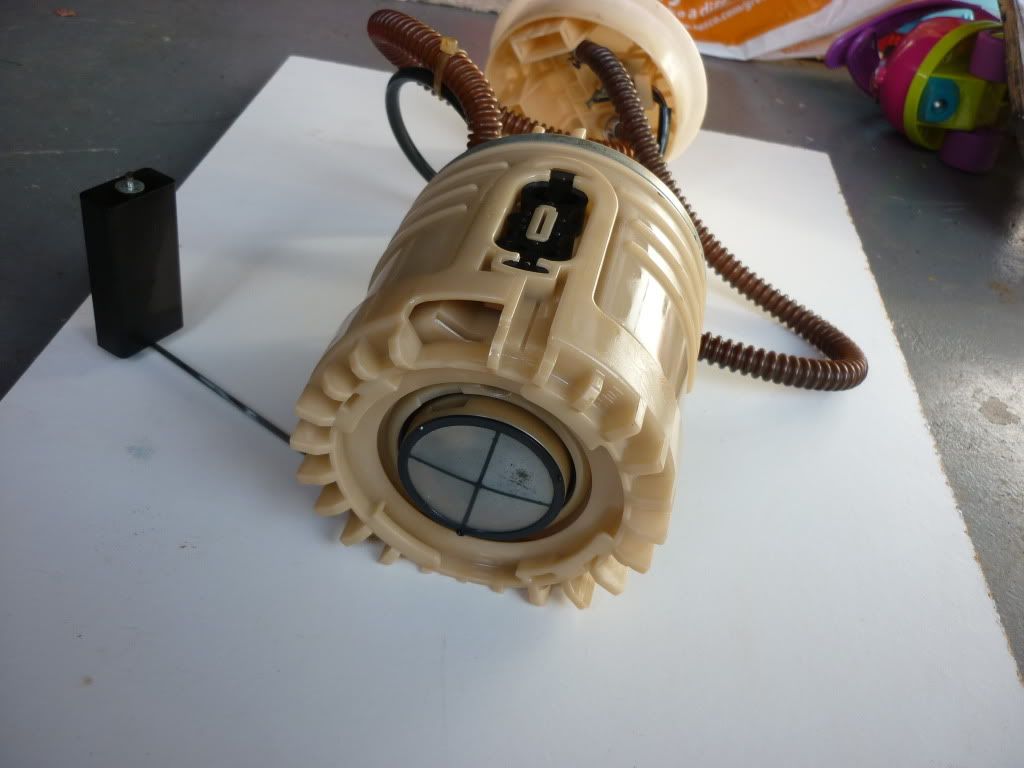

davidwort 0 Posted November 4, 2010 after changing my 8v pump (for a mk3 VR one :) ) I can see why it's a really bad idea to have much less than 1/4 of a tank in the car all the time, the 8v/VR pumps are a fair size and rely on the fuel for cooling, the interesting thing is the variation in pumps and senders means that you can mix and match pump bodies, top covers/connectors and level sensors across a wide range of VW's, and mk3's had the smaller 12 gallon tank don't forget. I was lazy and my 8v has a golf VR pump with the float arm bent into the right position for the corrado tank :lol: works fine though Corrado 8v VDO pump Quote Share this post Link to post Share on other sites
