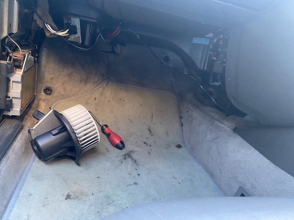

New Blower arrived, easier job than I thought and what a difference that has made!

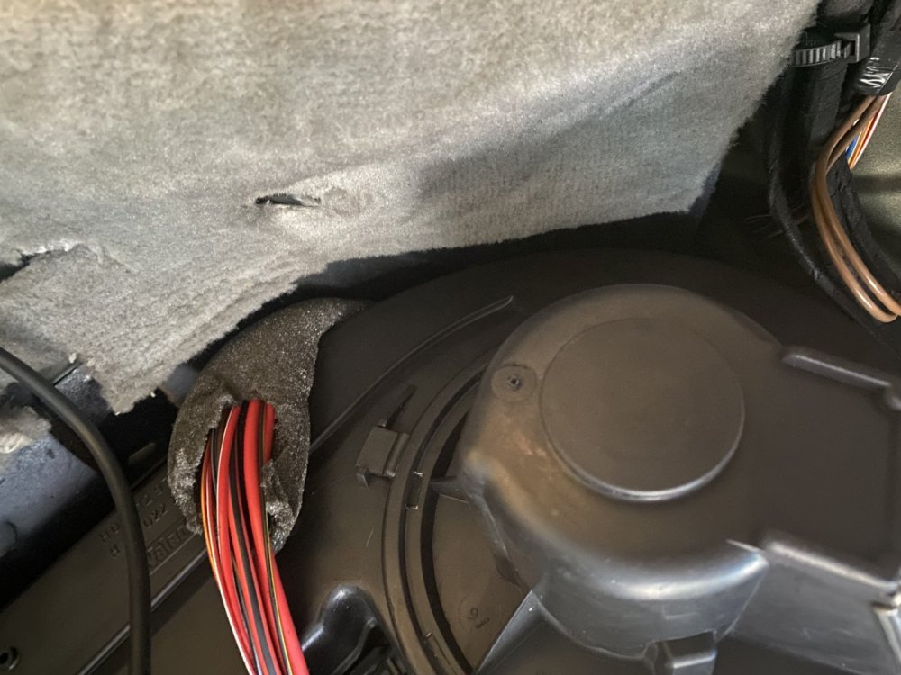

Just done mine remove side foot panel, bottom shelf passenger side, disconnect blower, hardest part of removing blower is lifting the clip at back of blower like in picture near red wires , turn clockwise (right) 20 degrees , should fall out and do reverse to get new blower in …
so happy to have heat again and clear screens
