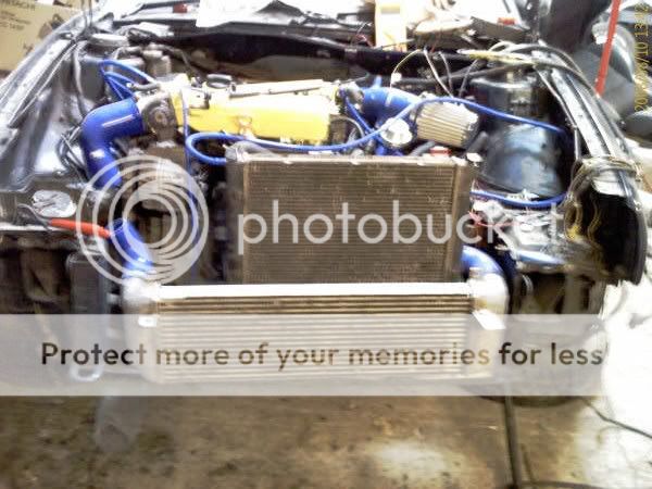

20vt 10 Posted December 16, 2010 I fitted a Land Rover TD5 intercooler on my 20vt conversion, fits perfect between the chassis legs and behind front bumper. Few rubbish camera phone pics to show fit Quote Share this post Link to post Share on other sites
Slimg60 0 Posted December 17, 2010 I used the TD5 intercooler too. As 20vt said, it fits perfect between the chassis legs and I mounted it so I didnt need to cut the slam panel either. Another popular choice is the Merc Sprinter intercooler. Quote Share this post Link to post Share on other sites

shaft69 10 Posted January 3, 2014 20vt said: I fitted a Land Rover TD5 intercooler on my 20vt conversion, fits perfect between the chassis legs and behind front bumper. Few rubbish camera phone pics to show fit Looking back at coolers for my corrado this isn't td5 but p38 good fitment too. Quote Share this post Link to post Share on other sites
carrots 1 Posted January 3, 2014 20vt said: I fitted a Land Rover TD5 intercooler on my 20vt conversion, fits perfect between the chassis legs and behind front bumper. Few rubbish camera phone pics to show fit it does look a nice fit,is that a 16v rad can you fit the fan in that gap Quote Share this post Link to post Share on other sites
redrado666 10 Posted January 5, 2014 i fitted a rangerover p38 intercooler on my 1.8t conversion. perfect fit. as for fitting fans in the gap you would need slimline fans. as said above a popular choice is merc sprinter but you will need to do a fair bit of cutting to fit. Quote Share this post Link to post Share on other sites
shaft69 10 Posted January 5, 2014 Im fitting td5 did you need move rad?? As need replace fan to sl9m type and not use original fan!! Quote Share this post Link to post Share on other sites
