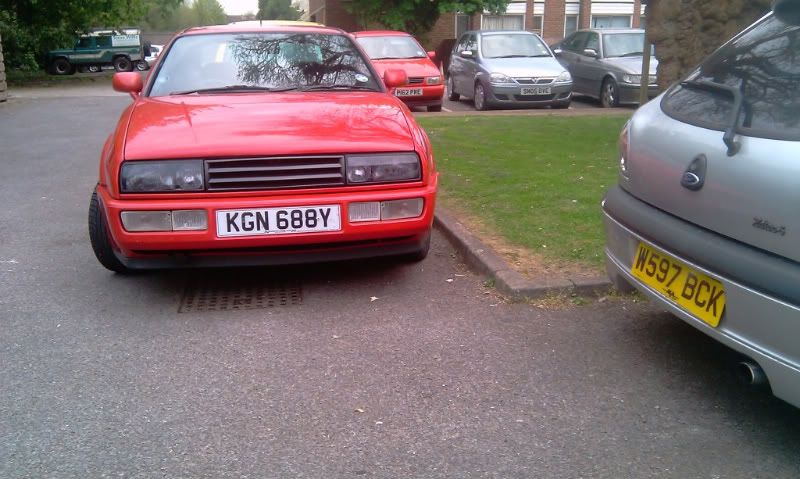

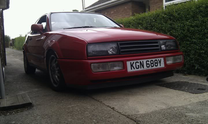

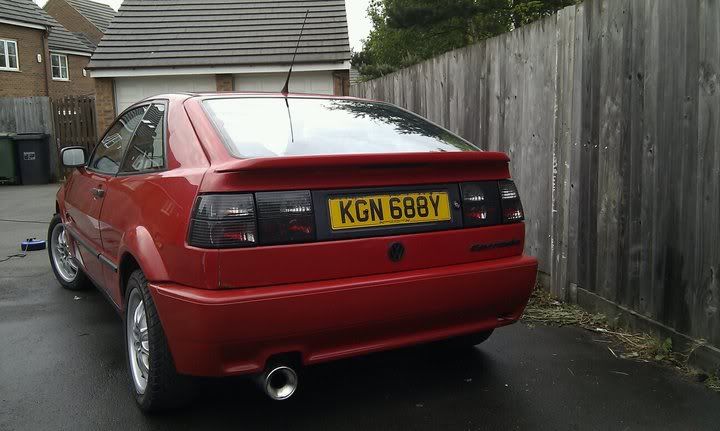

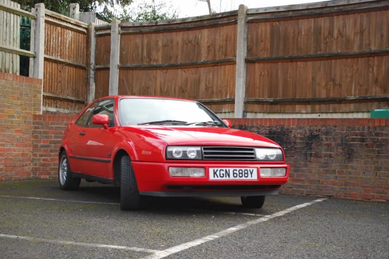

This is what she looked like when I bought her:
I didn't like the front lights, and there was a few things to tidy up...

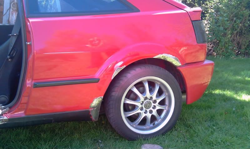

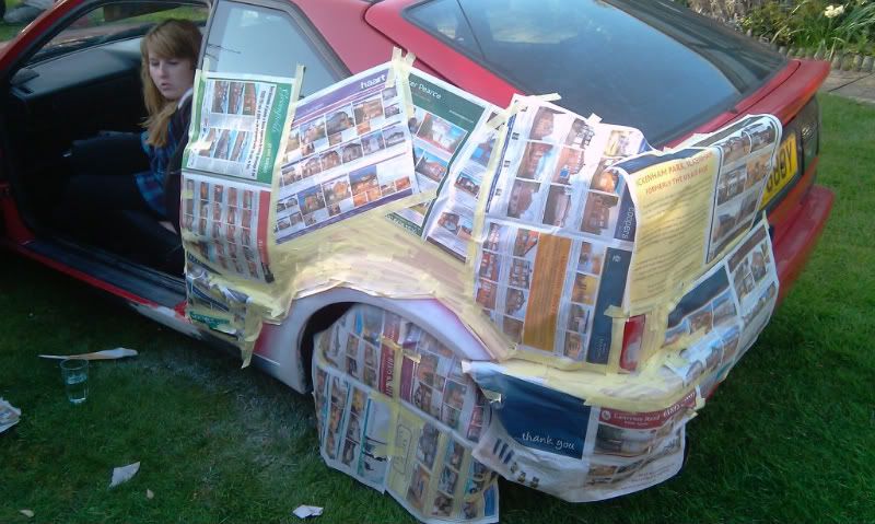

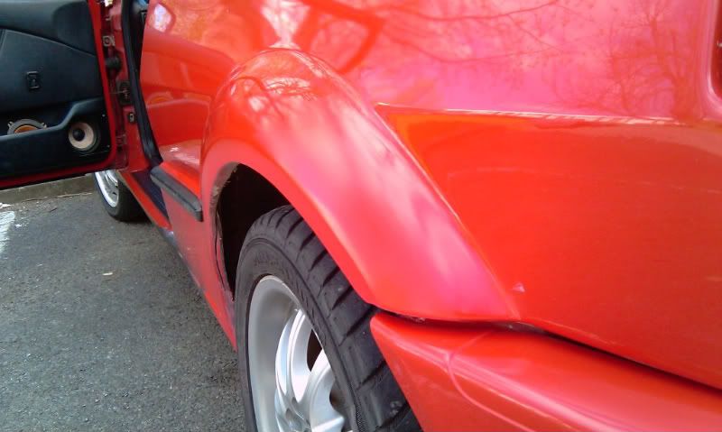

So i worked on the rust on the rear arch:
And the end result:

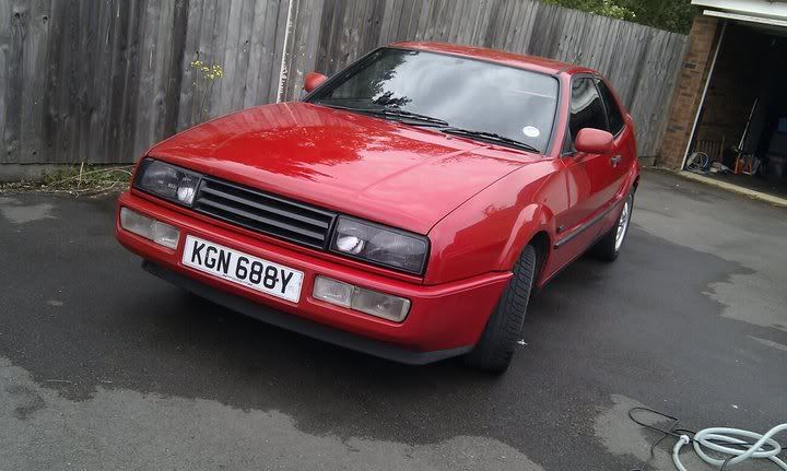

Swapped the lights:

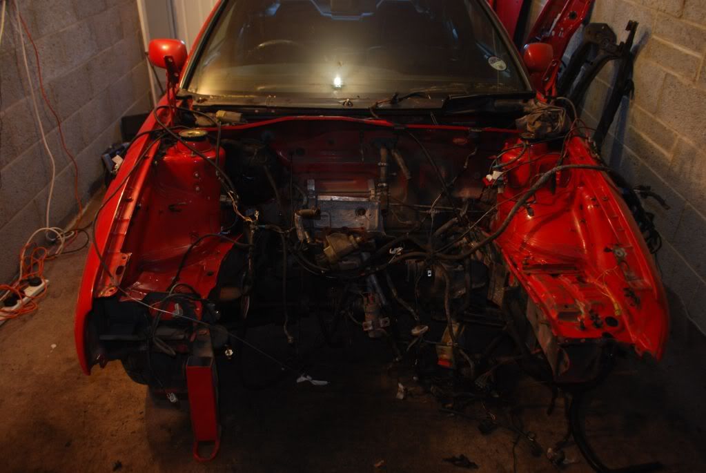

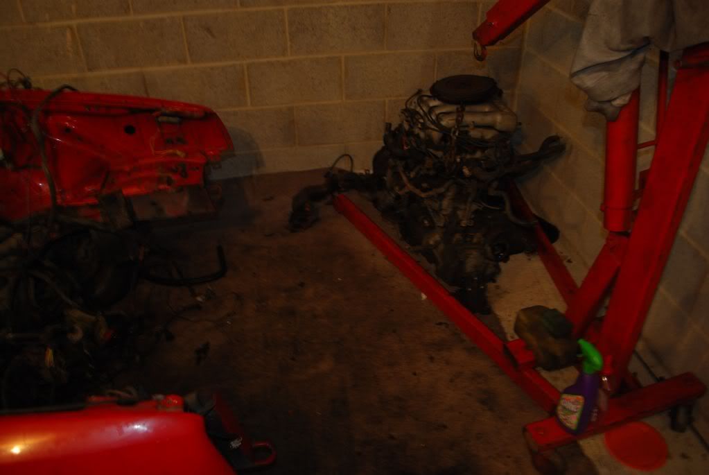

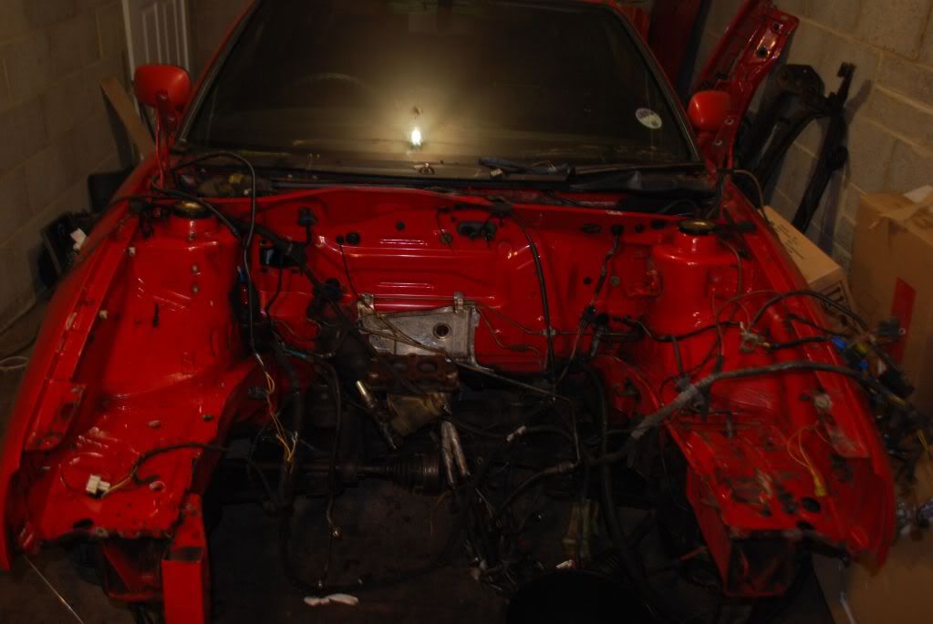

So the work began to strip the golf:
Thats where I am now, the golf is going this week, I need to fix the missus Polo, and then the Raddo is in for its love...

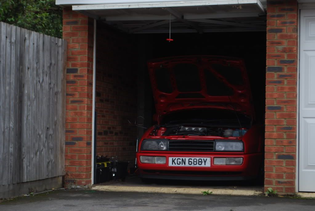

I can hardly wait.. The raddo goes into my garage tomorrow. The missus is out in the night so I have all afternoon, and night to get on with it :)
:clap:
I'm also off next week, going away on Wednesday, but have Sat, Sun, Mon, Tues to do it :)
So, unless I'm feeling lazy or something goes wrong, she should be firing by Tuesday :)

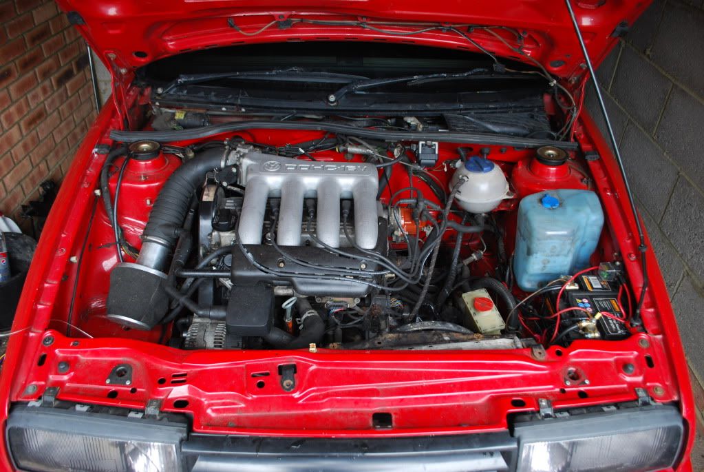

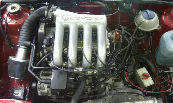

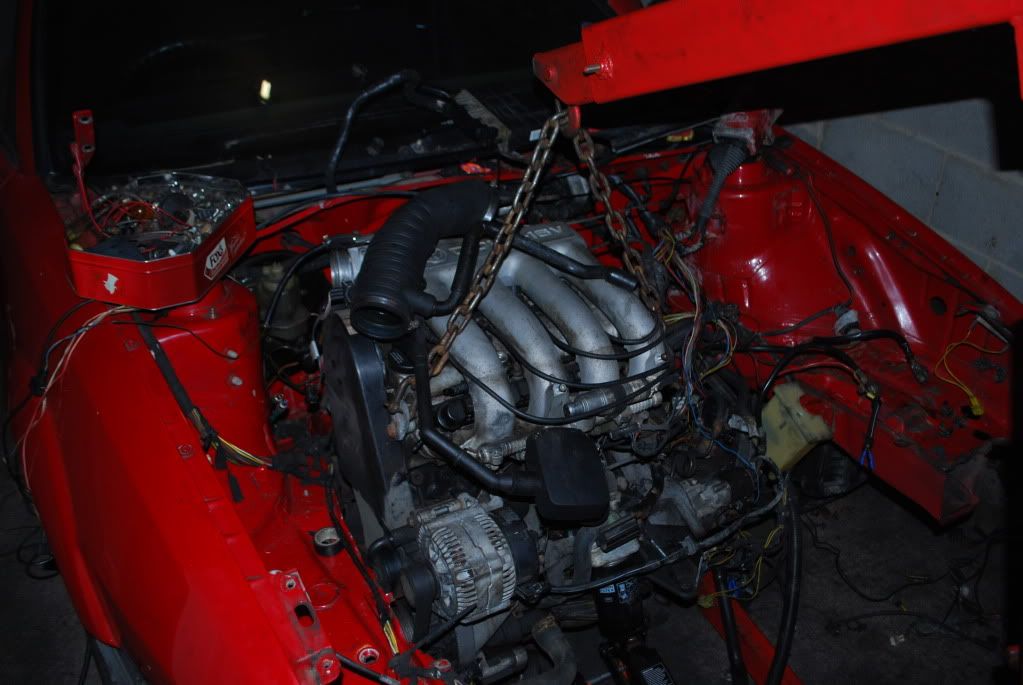

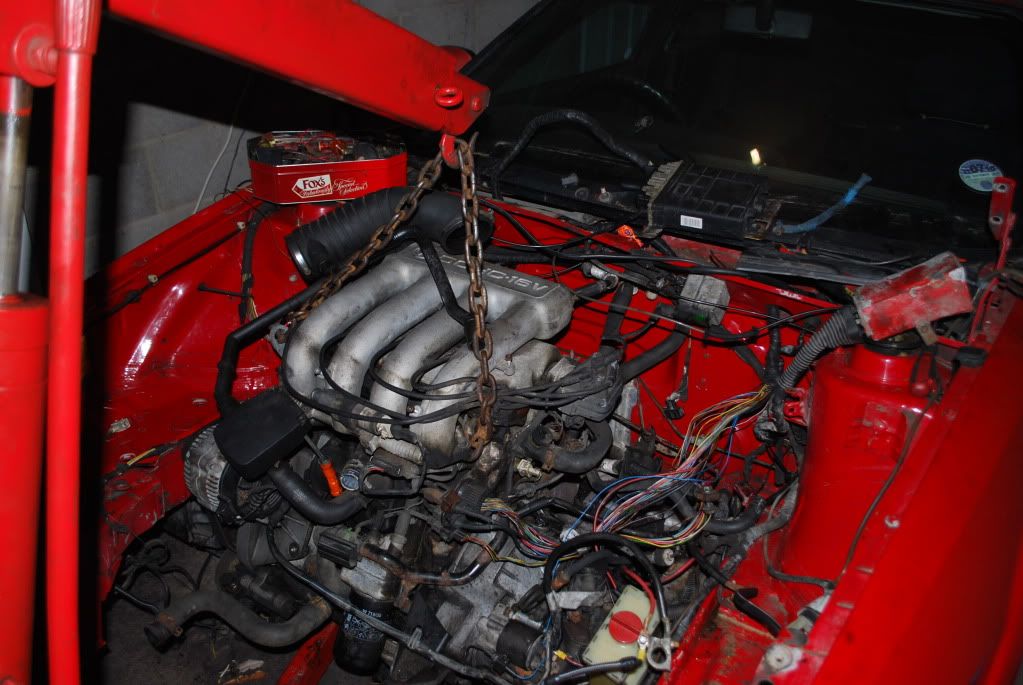

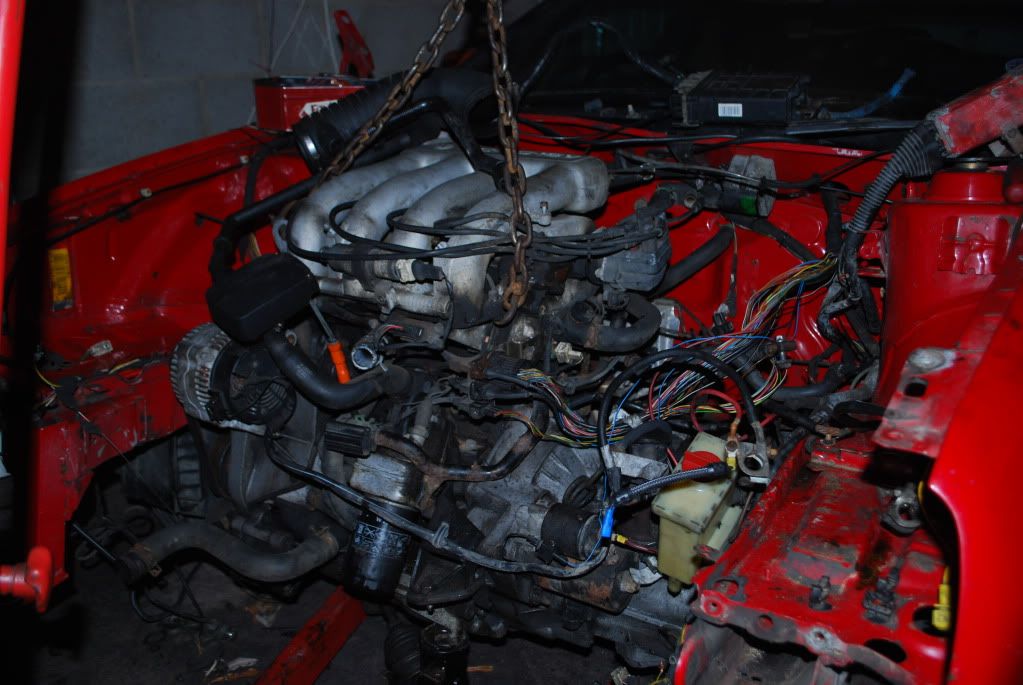

The new engine hadthe gearbox swapped, I got the wiring in, and engine in.. and start connecting **** up :)
Well, The gearbox off the raddo was put onto the ABF (as it was a AYK box) and bolted it all together and started to put the engine back in :D
Got the old loom out, took some bits off it I needed
Obviously I broke a bit :(

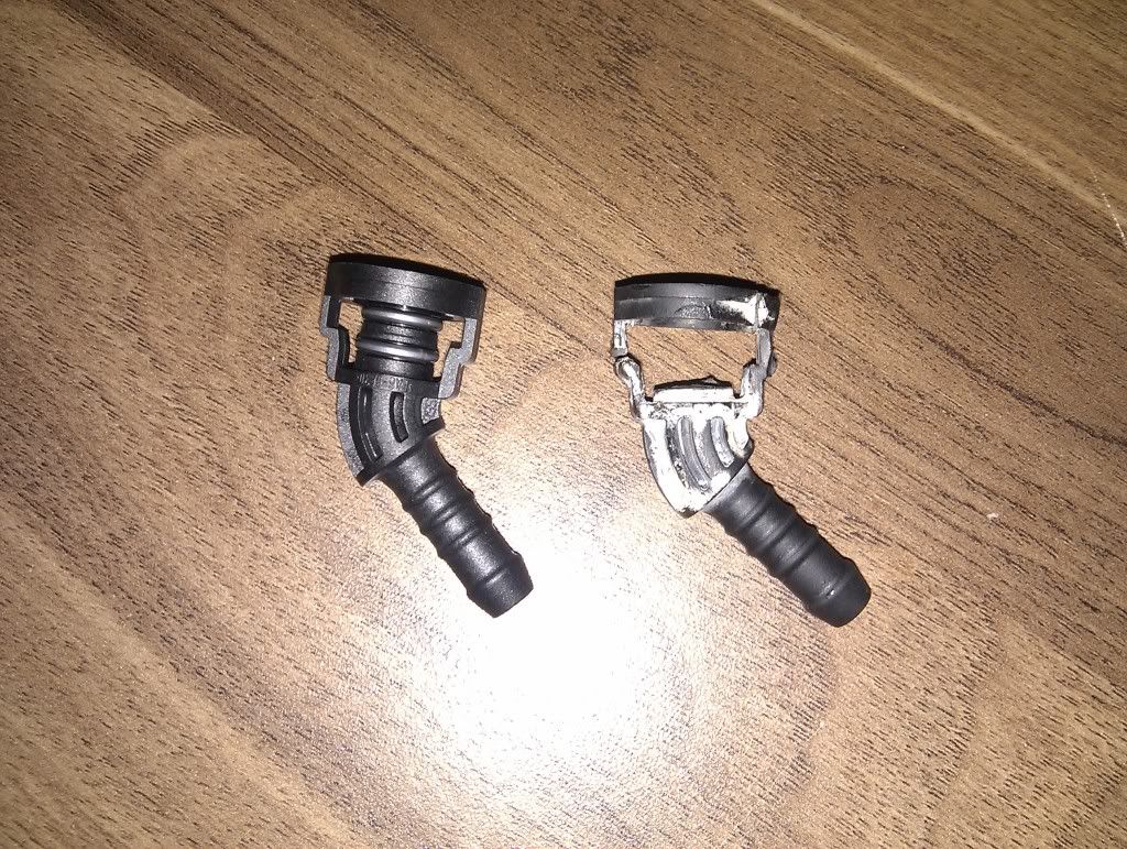

had to order the elbow that goes onto the fuel rail (off the fuel line).
037 133 992 C - abf fuel rail elbow - 10.25+VAT
Also bought some longer fuel lines, as mine were not long enough!
Finally, it has Fuel!!! and the cross member and front bumper are on :)

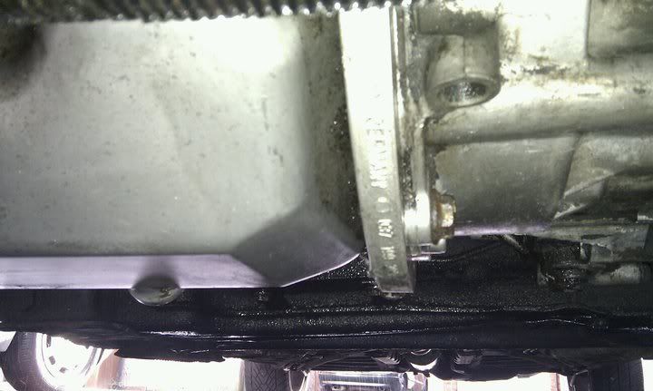

The broken part:
So i haven't attached the exuast properly, just wanted to see if the car turned over...
Click pics below to watch the VIIIDDEEEOOOSSS :)

Where did you buy the elbow from? Anywhere online, or dealership?
Did it come complete with the two O rings?
I'm converting my 9a to Megasquirt using ABF parts, and my fuel rail is missing both elbows.

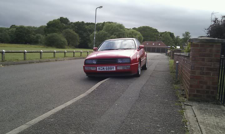

The garage did a great work, sorted out a crap exhaust and filled it up (need a new one really) and the MOT tester let it through with the sill bodged as it was. I will replace them both this year...
It then passed its MOT :)
