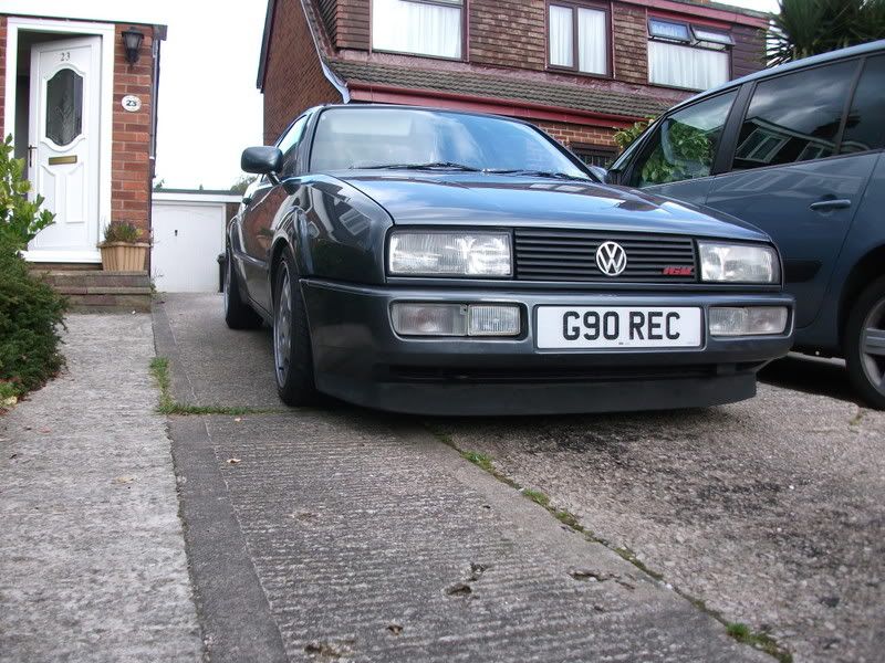

big ben 10 Posted March 30, 2011 My mate is picking up some D90's this weekend (16x8 and 16x7), so just wondering about tyre sizes and spacers at the moment... I know quite a few people are running on Porsche wheels or have done in the past so after some advice if possible! I also know this has been done to death over the years but pictures are missing from the old threads etc so its hard to find out the info and see how the car sits... The look he wants is low as possible but still driveable! wheels nearly flush with the arches so it looks nice and wide all round... Tyres nicely stretched but not silly! I had a set a while back but cannot remember what tyres and adapters i was using, also they were on a VR which may be slightly different? think i had 195/40 tyres on the 7's and 8's but cant remember, the stretch seemed about right to me though, heres a pic; So after searching around would 30mm spacers on the front and 35mm spacers on the back be ok? Or could he get away with an extra 5mm or 10mm? Alos what tyre stretch would be best like above, take it different sizes are needed for the front and back as well? (if only my memory was half decent i wouldnt even need to ask :scratch:) cheers Ben Quote Share this post Link to post Share on other sites

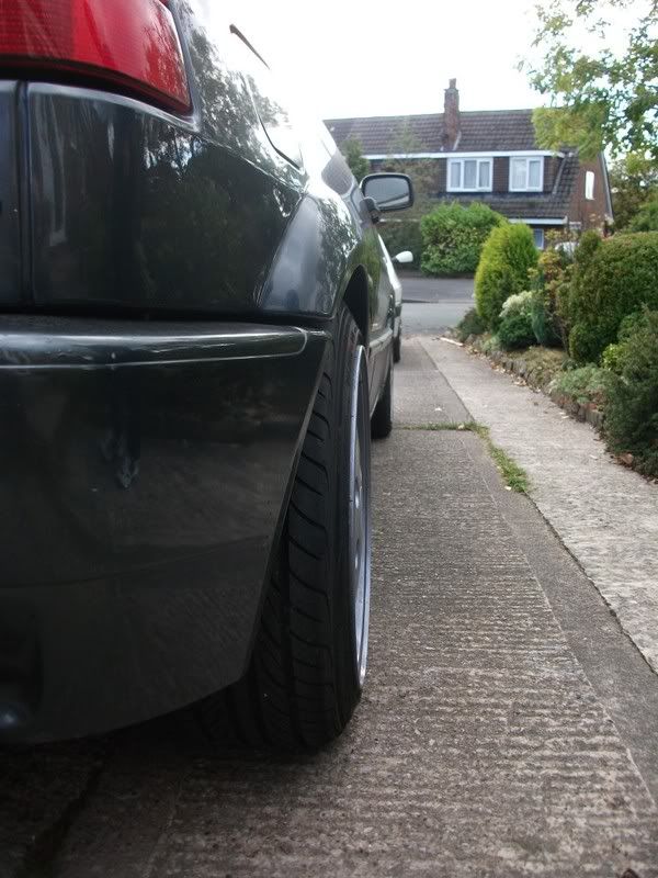

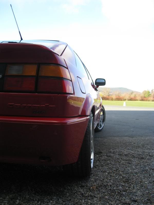

Mike2006 0 Posted March 30, 2011 Ben, I'm running D90s (8s) front and rear on 25mm H&R. I'll double check the tyres. See pics below from the link in my signature. Quote Share this post Link to post Share on other sites
big ben 10 Posted March 30, 2011 Ben, I'm running D90s (8s) front and rear on 25mm H&R. I'll double check the tyres. See pics below from the link in my signature. thanks mate! the stretch you have on them looks just like what i had, so be good if you could have a look! looking at yours, he could get away with another 10-15mm on the rear i would of thought, without too much of an issue? Quote Share this post Link to post Share on other sites
Abdul 0 Posted March 30, 2011 195/40 all round, will be a skinny but square sidewall up front with some stretch out back.. If he wants stretch up front too he'll need some 165's or something oh and rolled arches for uber lows. Adapator wise im not sure but i think you'll want 35mm+.... Quote Share this post Link to post Share on other sites
Mike2006 0 Posted March 30, 2011 Avon Zv 195x45 are the tyres. The lip of the rears are practically flush with the arch. My car is on a H&R Cup kit. Extra 10-15mm and he might be in bother ? Has he coilovers? Quote Share this post Link to post Share on other sites
