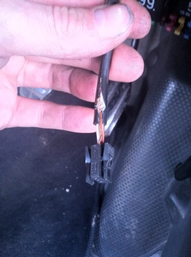

deanjames 0 Posted May 9, 2011 (edited) Hi Guys, Hope you can help with this really frustrating issue i am having and i am 100% sure now after my previous thread its now electrical immobilizer based. - Car was doing this before i had a new alarm fitted. - Fitted a new one hoping it was at fault and the car is still doing it. The issue is i got to start my car and its cuts out. The engine goes to crank and then nothing. I will try after a few attempts and then it will fire up like nothings happened Its 50/50 i could get into my car one morning and start it up and it starts fine first turn of the key and others it takes around 4-5 attempts. I have put the car on VAGcom and get the following code. Controller 021 906 258 co Coding: PMC 1HS 17978- Engine start blocked by immobiliser P1570-35-10 Intermittent When it cuts out i put the key into position one and it chirps so this leads me to believe its immobilisers related. When it starts it starts fine put key into position 1 and no chirps. Any ideas guys, or anyone i could take it to I am located in Milton Keynes http://www.youtube.com/watch?v=SkrU0tKz_xI Also found this Wire for the factory immobilizer not looking to good. Many thanks Edited May 9, 2011 by deanjames Quote Share this post Link to post Share on other sites
