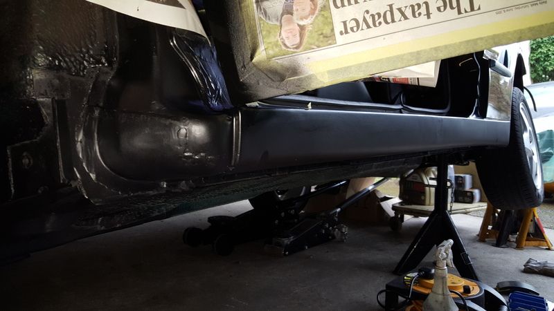

Jim Bowen 1 Posted September 9, 2016 repaired pic Quote Share this post Link to post Share on other sites

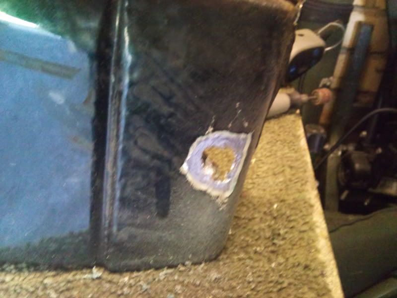

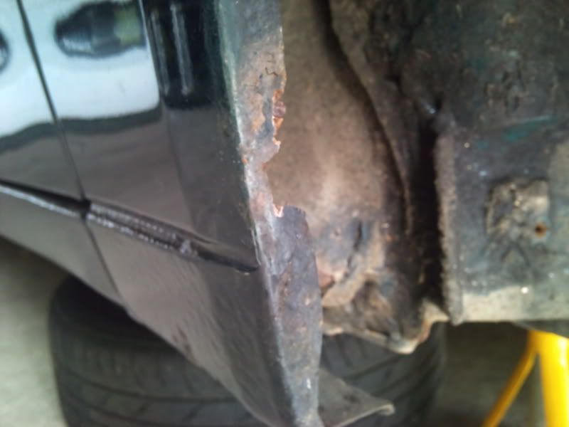

dr_mat 0 Posted September 9, 2016 Hmm, yes you may well be right there..! Looks like the bottom of the A pillar is more or less in contact with the lower section of the wing there then, so both pieces rust together? Quote Share this post Link to post Share on other sites
Jim Bowen 1 Posted September 9, 2016 Yeah the lower bit of the wings bolts upwards into the sill there, creates a bit of a dirt trap, one wing of mine was ok, the other was rusty and by the time i'd poked it a bit there was hole in it and the bottom edge needs a piece welded on. Quote Share this post Link to post Share on other sites
dr_mat 0 Posted September 9, 2016 Yes that's looking familiar. Doesn't need doing just yet but sometime.. Quote Share this post Link to post Share on other sites
