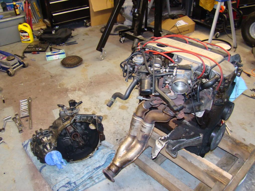

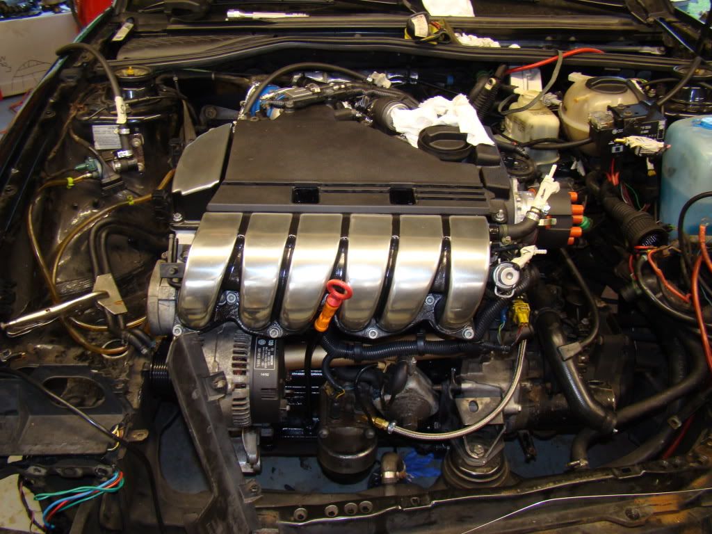

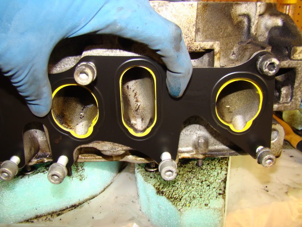

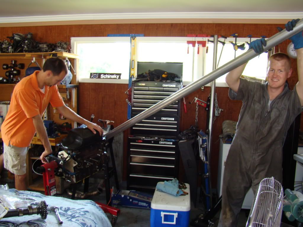

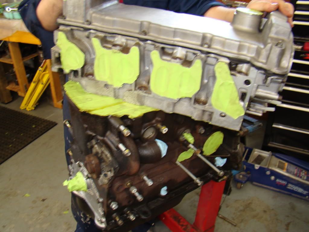

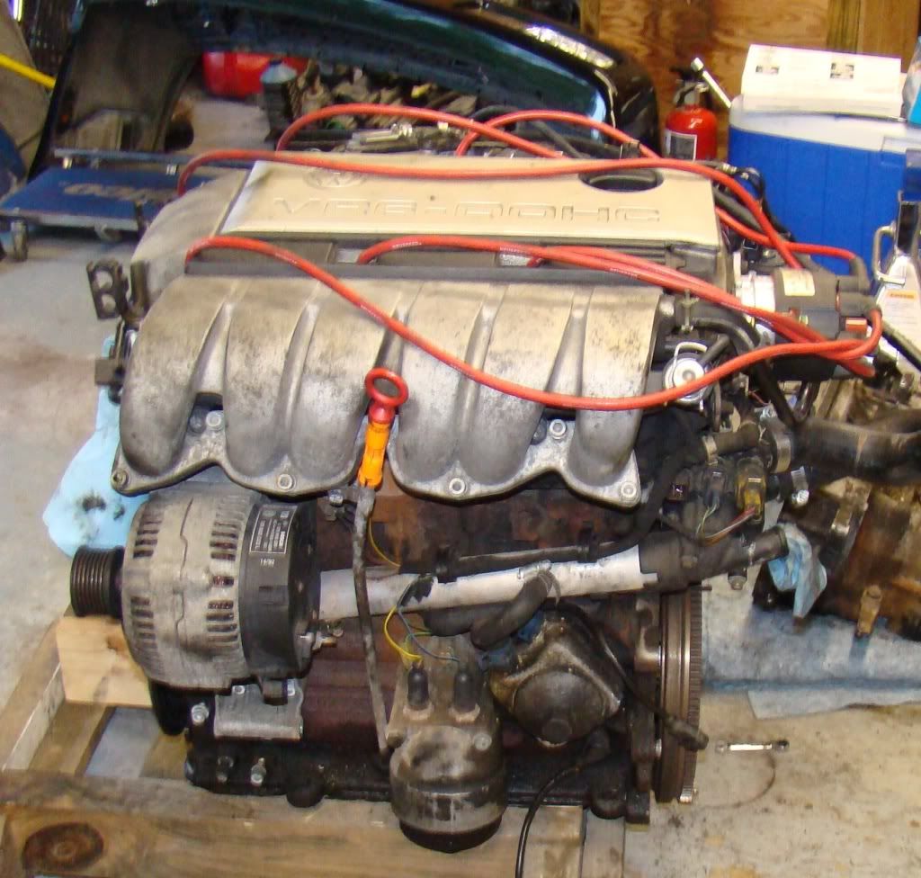

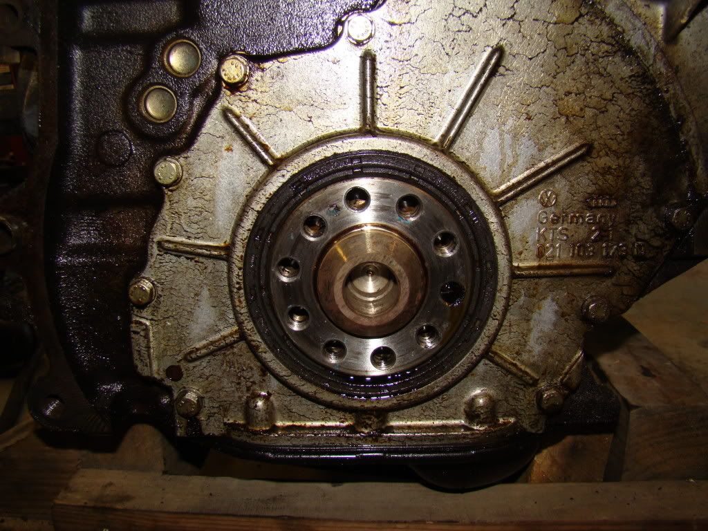

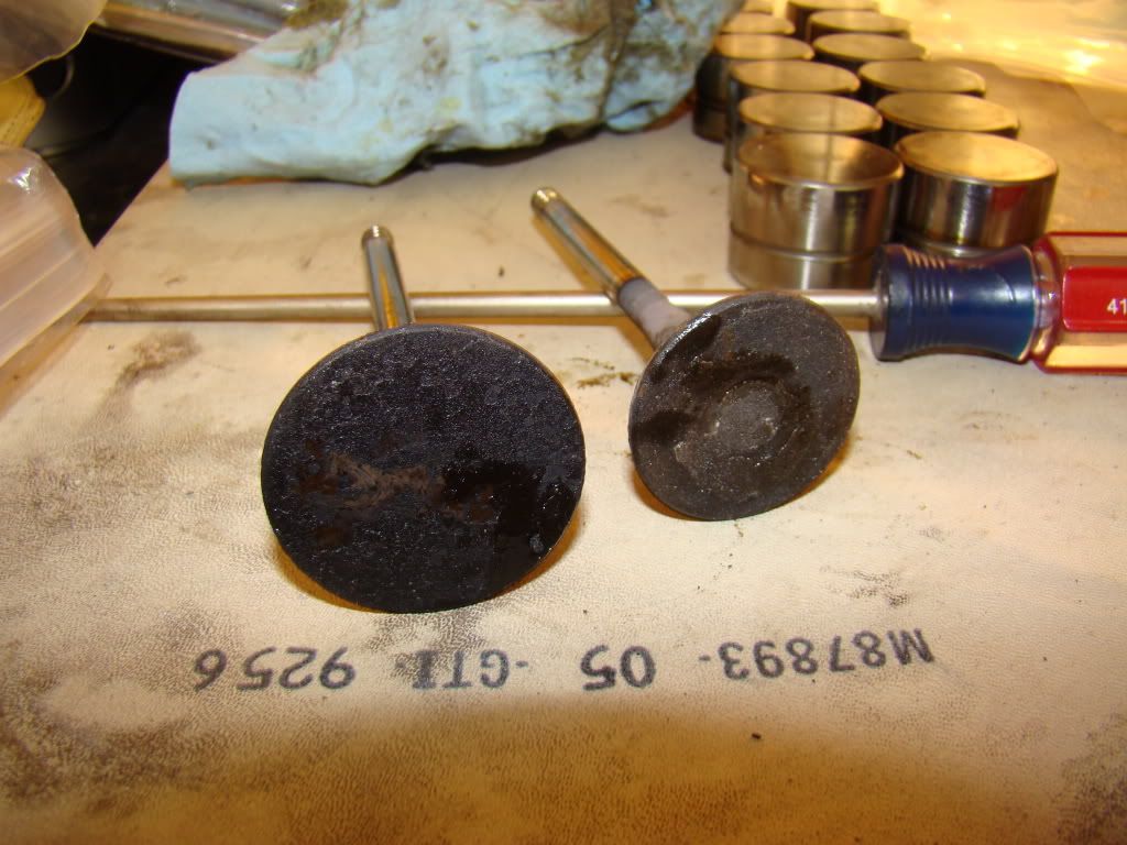

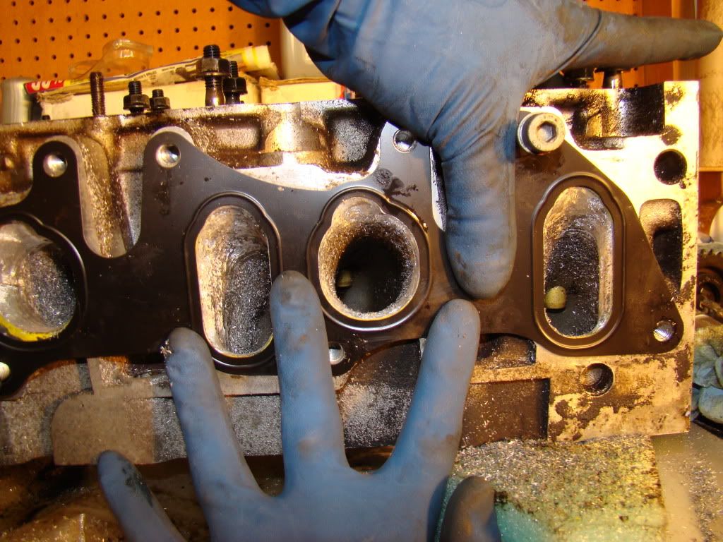

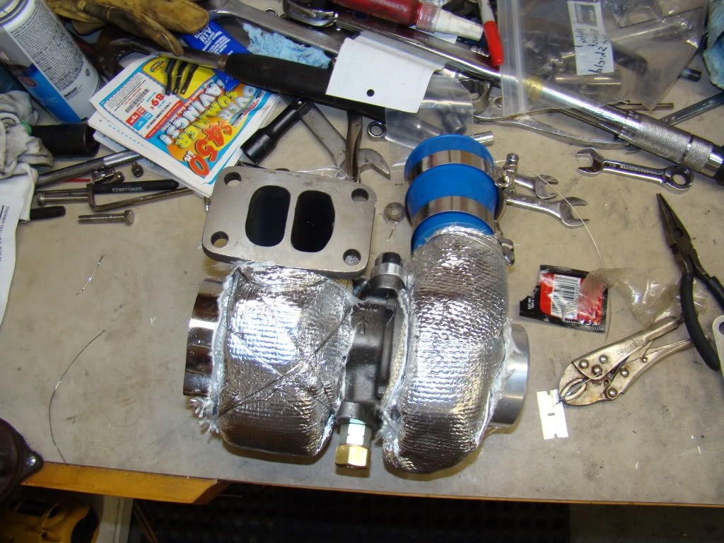

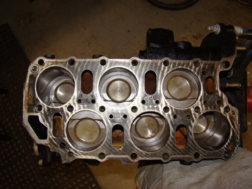

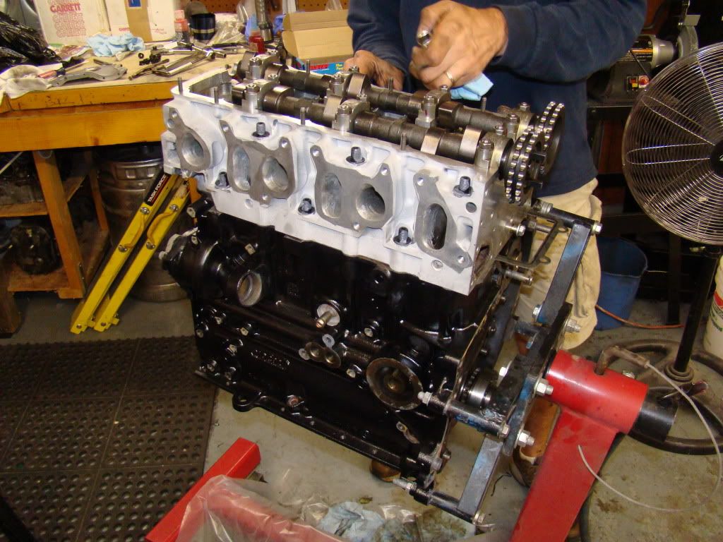

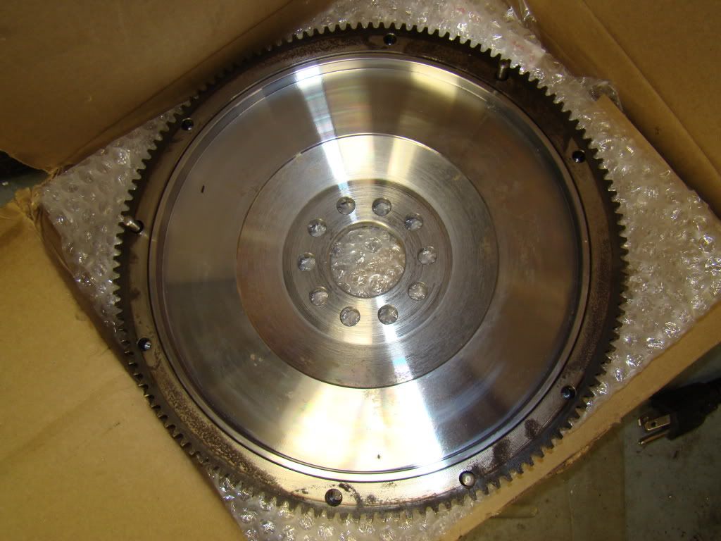

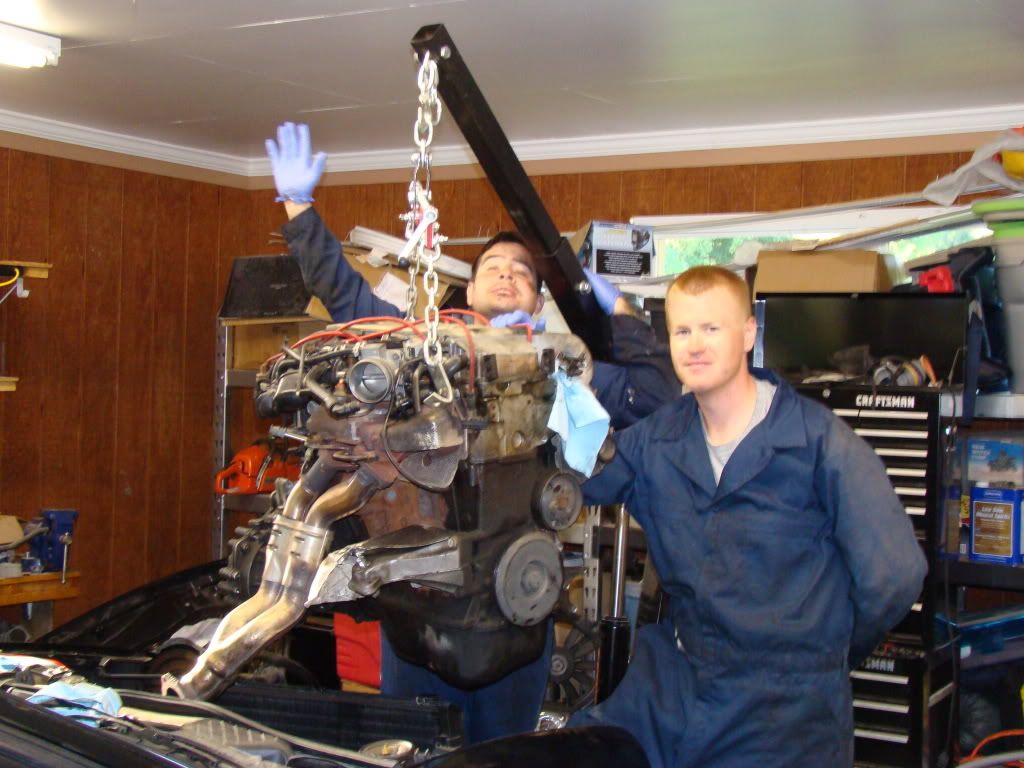

CVR6-T-HD 0 Posted July 21, 2011 Hi all! I've been meaning to post my project. I'm still new to turbos and could probably use some advice. If you have any ideas or comments I'd love to hear them. So it all started with me wanting to fix my oil leak. The project took a few months of hard work. It's still not done as it needs to be tuned properly and I want to re-do the interior and finally paint it. I talked to my best friend Scott to guide me through as we figured the leak was coming from the rear main seal. Up to this point I just knew how to change oil, work a tuneup, and tires. Talk about FULL IMMERSION! Pulled the 92 Corrado SLC into my buddy's garage and began preparation. As we got talking more about the car, I asked him how hard it would be to Turbo it..him being engineering minded person he is was like "Sure, no problem" Little did I know what was involved [LOL] Took us a while but we got it out. We had all the tools we needed luckily. If we needed anything for a job I bought what was needed and donated it to the cause. Immediately we could see where the oil leak was coming from. Replaced the Rear and Front Seals. Looked over and replaced suspect hoses and replaced ALL seals. Started with the head. Yea as expected after 100K miles carbon was everywhere. I began prepping the block for painting, while my friend worked on getting the head cleaned and parts replaced. We installed new piston rings, followers, chains, tensioner, 268 deg turbo cams, gaskets, etc. Only thing didn't replace were the rods and pistons.. I still pray don't regret that. We did run into some issues like removing the ##$@! Crank Bolt. It took my 215lb friend with super leverage to get it off. Crazy!! Who's your Daddy!! We took the liberty to port match the exhaust side of the house. My buddy meanwhile continued with the head. After some creative thinking we got the followers off and finished cleaning up the stems My vision for the car was for it to be my daily driver and provide me with quick sprints when needed. Not designed to be a track car, originally I didn't lower the compression. Was limited to 8PSI but it had great everyday driving feel using the lower rev power of the VR engine and then kicking in the Turbo at higher revs. Since then I've installed a spacer to lower to 8.1:1 mostly to see what the differences were and to see what she can do. I'll post some more soon.. Getting tired of typing Quote Share this post Link to post Share on other sites

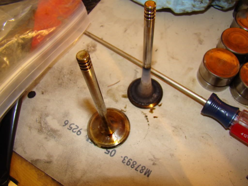

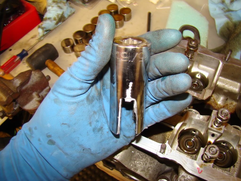

Yandards 0 Posted July 22, 2011 Straight into the heavy work then! The valve spring retainers can be removed by using a long reach valve spring tool, assuming you are still based in the UK in an airbase in Suffolk ;) then your local branch of Halfords will have one on the shelf. Quote Share this post Link to post Share on other sites

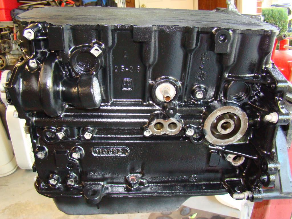

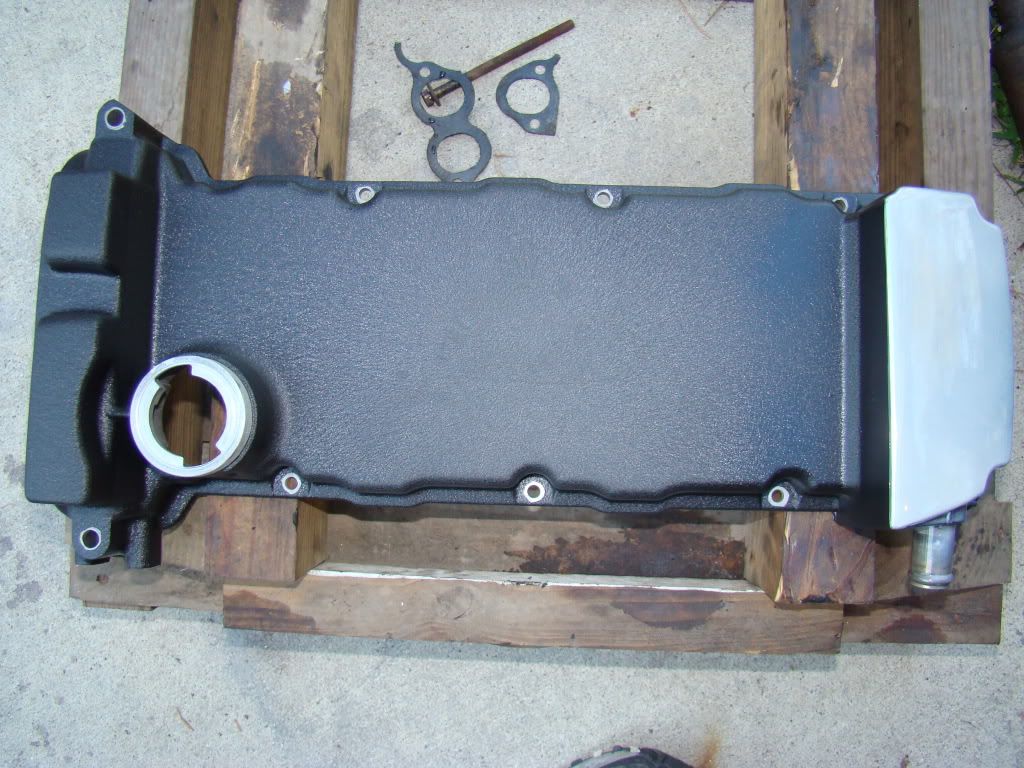

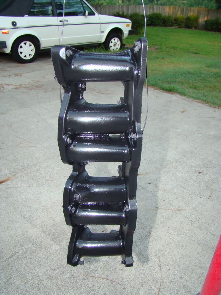

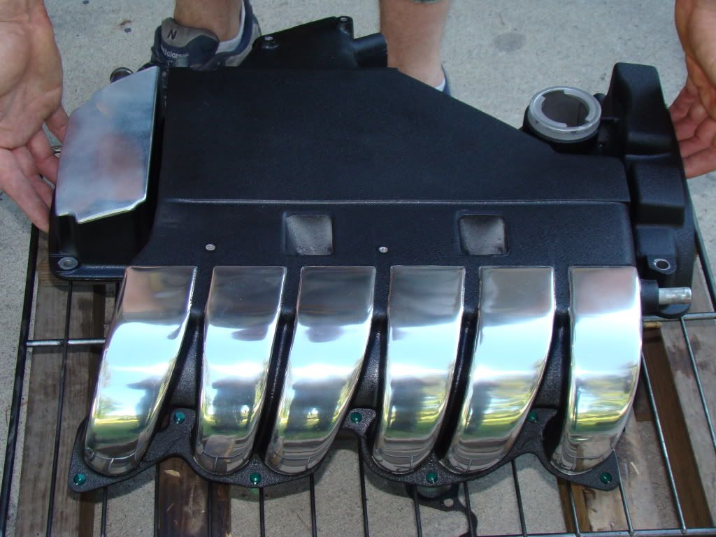

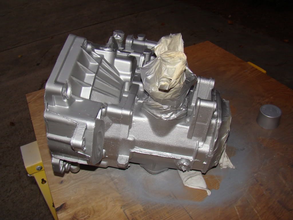

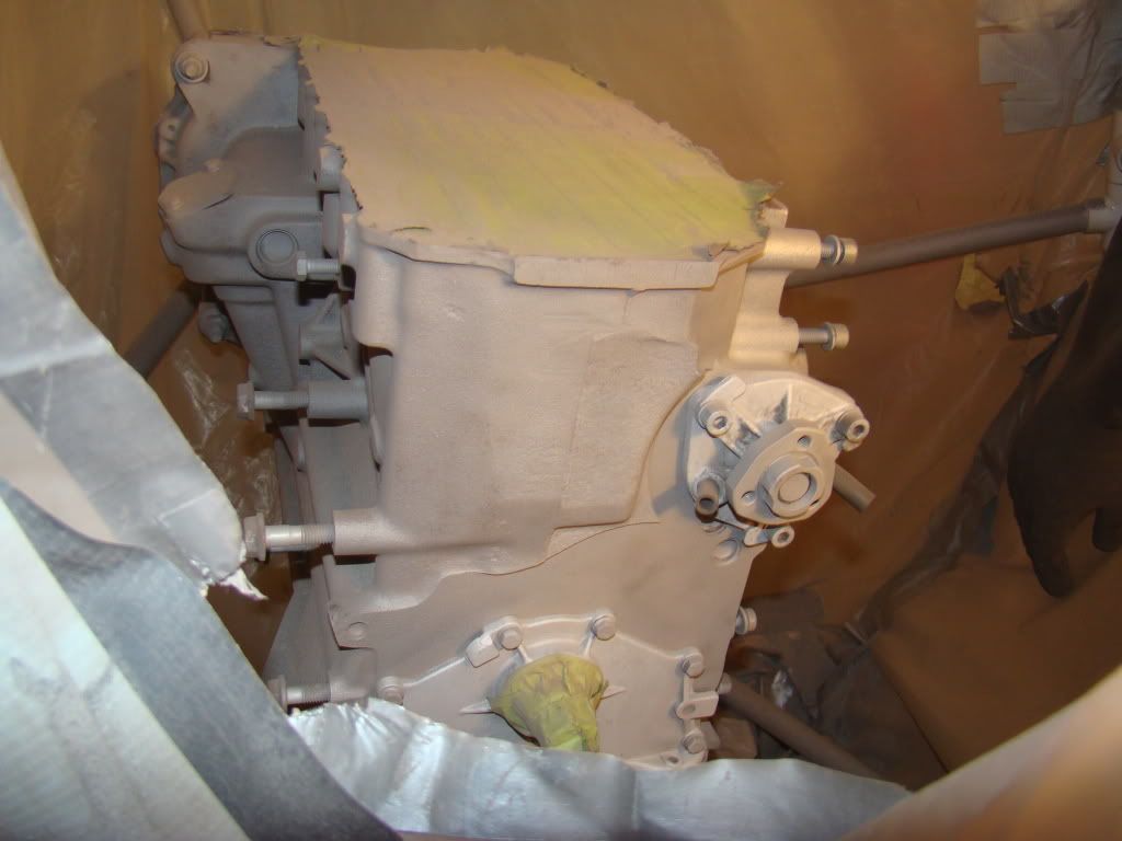

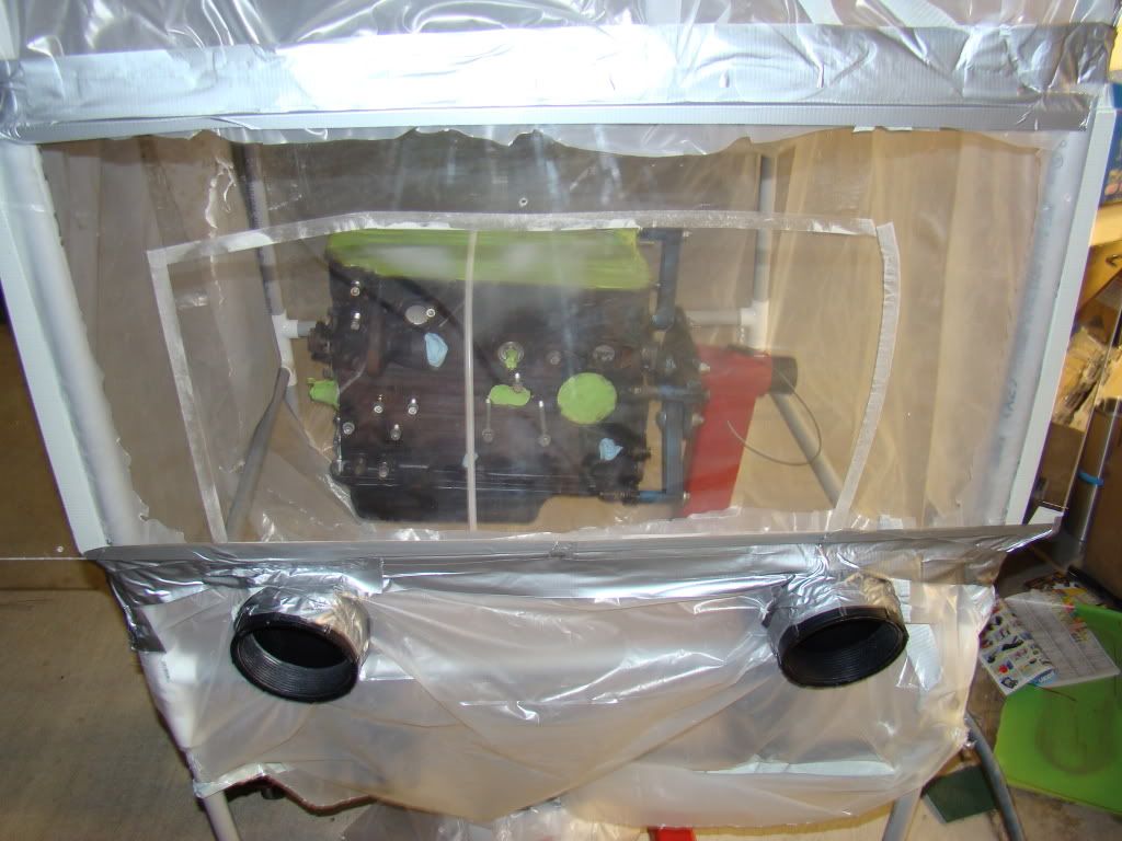

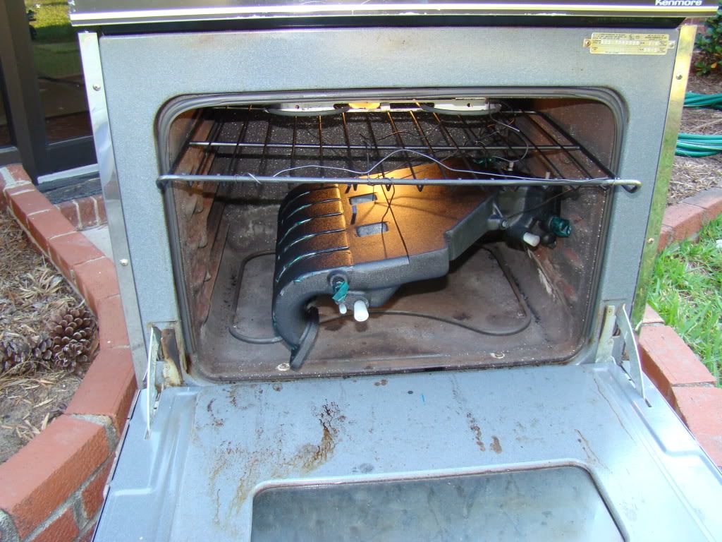

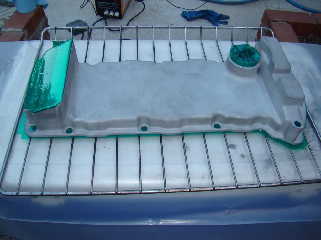

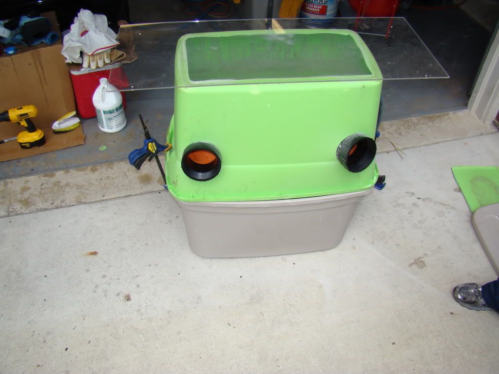

CVR6-T-HD 0 Posted July 22, 2011 Yea, my buddy had quite the shop. Of course I added to his extensive collection of tools. My plans for the future after I get some piping reworked is to get the interior donen by MJ Interiors. ---------- Post added at 10:45 PM ---------- Previous post was at 10:40 PM ---------- Ok.. CONTINUATION... So we continued to prep the block and head for sandblasting. [LOL] We had to fabricate our impromptu booths. Love it! It was a pain in the **** cause the beads weren't flowing with the weak compressor we had. It kept running out of pressure and we had to wait a bit.. but the beers in between made it all good ;-)We painted the block, manifold, tranny, and powdercoated intake manifold and valve cover. I was really impressed with the black wrinkle powercoat. The prepping for the powdercoat took some time.. had to tape everything precisely. It really is a kewl process using electrical charge and then an oven. But the Intake came out really awesome after we polished and powercoated. Quote Share this post Link to post Share on other sites

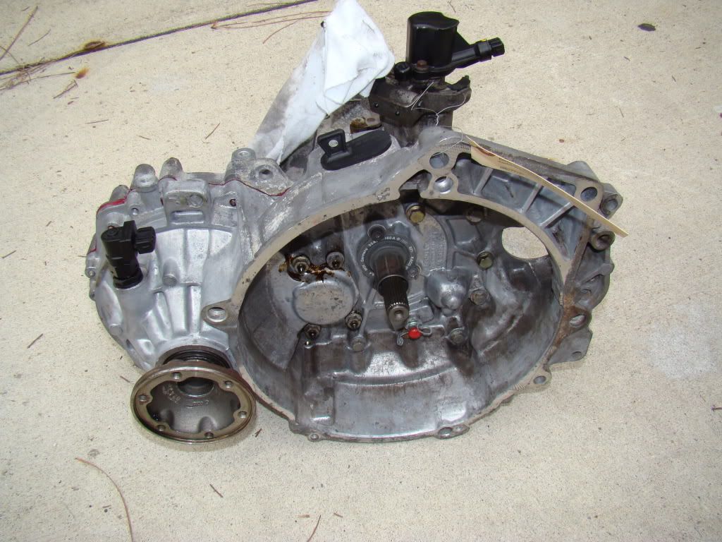

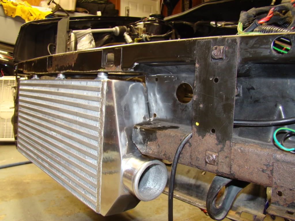

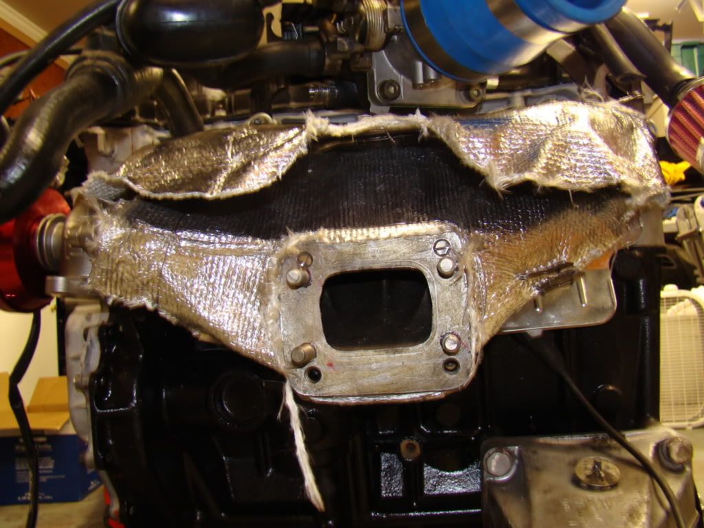

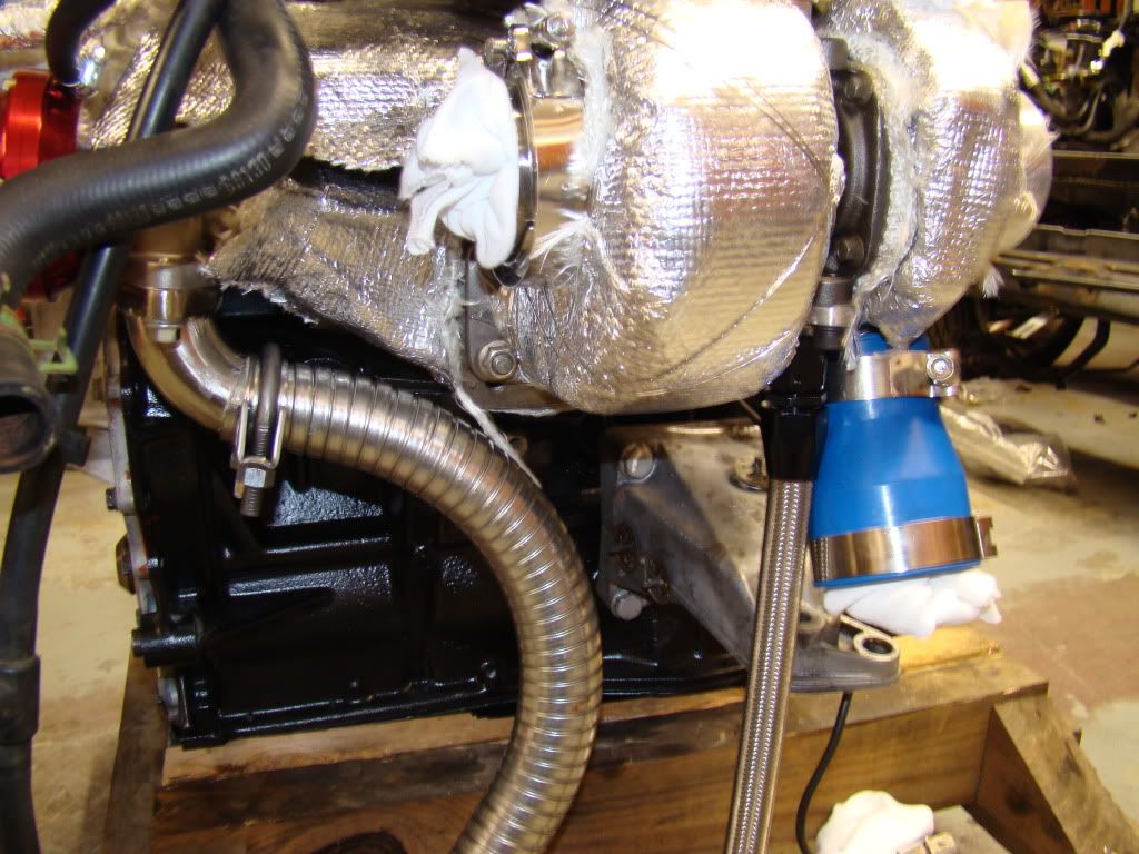

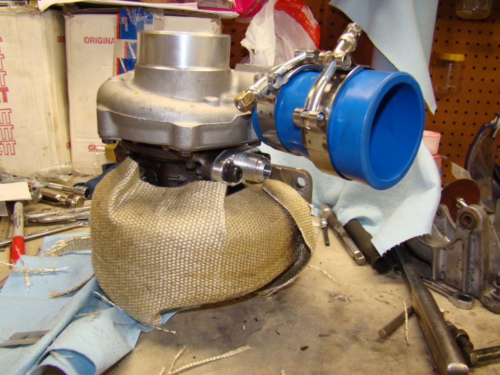

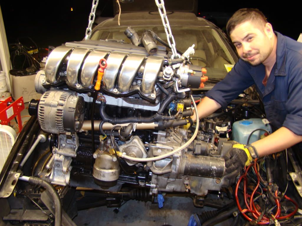

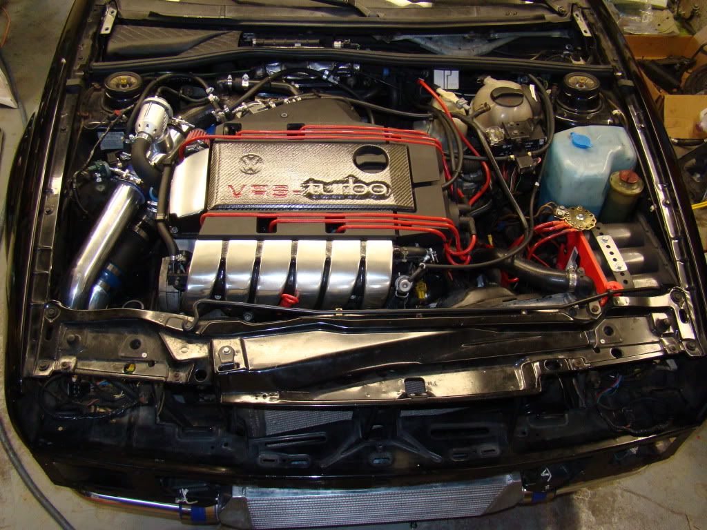

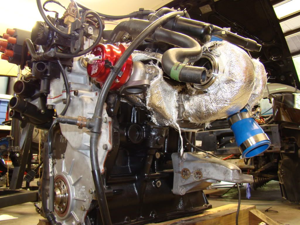

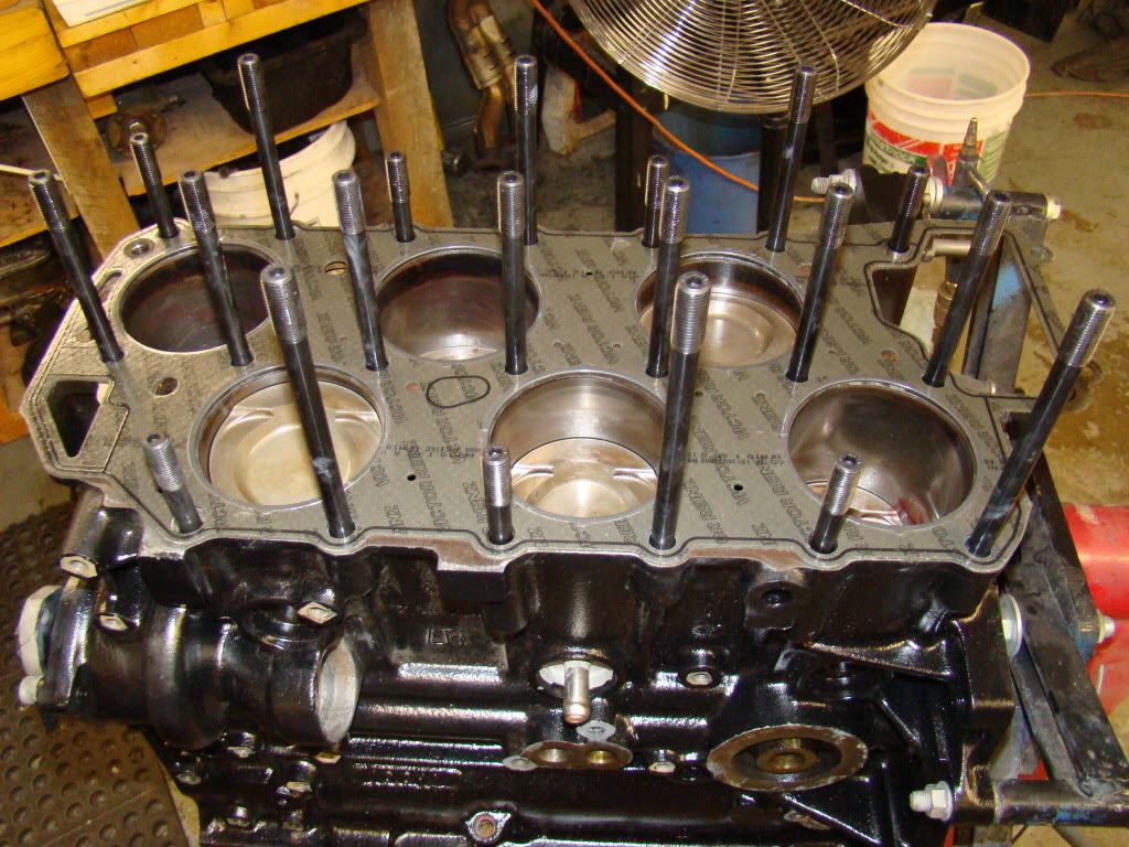

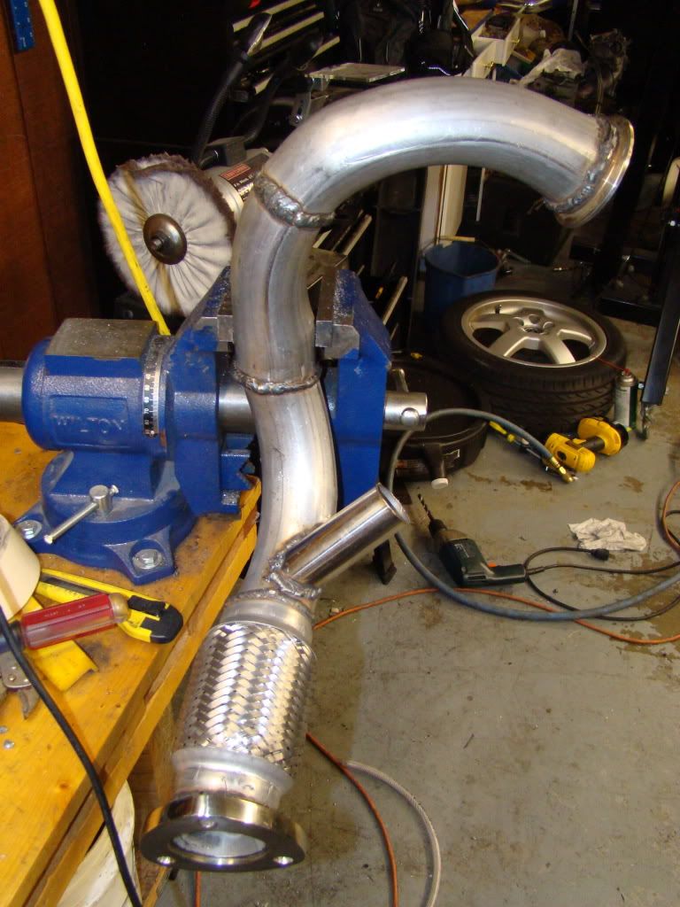

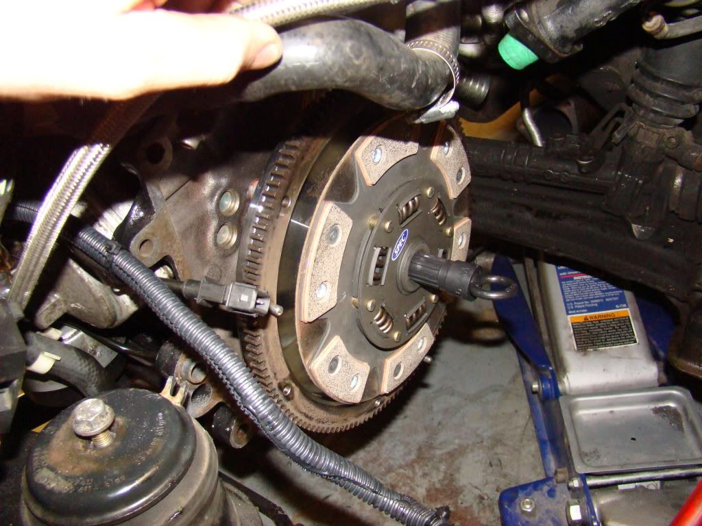

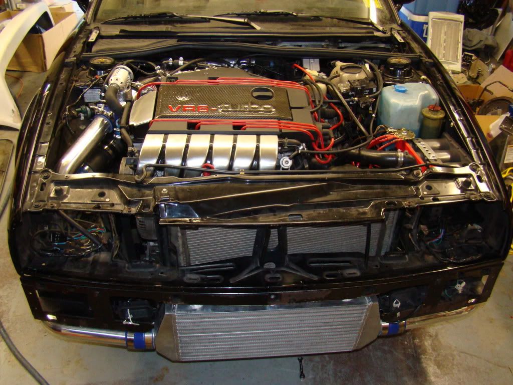

CVR6-T-HD 0 Posted July 22, 2011 Putting the engine back together...ARP bolts.. a must Now for the turbo and custom piping. Very important to heat proof your turbo and manifold and downpipe. Downpipe was a pain with its wicked twists. The Tranny back with new LSD installed. The clutch was crap so I installed a Spec Stage II+ and lightened flywheel. With the engine put back together we lowered her in nice and steady. If you notice closely, I painted the crack pipe gold and added clear coat of glitter... ahh yes the legendary Golden Crack Pipe of Antioch! Still had to get the intercooler fitted so cutting we went. And there you have it folks. I ran into some issues with my body kit coming in the post all cracked. Terrible company..never again as they never took calls and never got back to me. We fixed it ourselves. I'll post those pics later. As well as the specs for the car as it stands today. Quote Share this post Link to post Share on other sites

CVR6-T-HD 0 Posted September 3, 2011 (edited) Ohh she's been on the road for a while now. The car is running rich at the moment, but it hasn't been tuned. The C2 chip is doing an ok job but I will be taking it to Stealth to get it fully tuned and find out how much HP I'm getting. Since the build I've rebuilt my suspension and installed Koni Coilovers, had a head spacer installed to lower it to 8.6:1 compression ratio, installed rear and front anti-sway bars, and got me a pair of E-code headlights.. I'll install HID kit soon. Here is a list of what I have done so far: Borla 2.5" Cat-back Exhaust High Flow Catalytic Converter 5 pc. Polyurethane Motor Mounts Head Stud Kit, ARP Autotech 10lb Flywheel Spec Clutch Kit, Stage II+ (395 ft/lbs) Inconel Turbo Exhaust Manifold Timing Chain Kit, Dual Chain rebuilt w/upgraded tensioners Peloquin Planetary LSD Piston Ring Set, 81mm (Honed out cylinders by hand) Rod Bearing Set (OEM) Rod Bolt Set, Complete (Performance) Suspension Rebuild Kit w/ ZF Tie Rod (HD) Koni Sport Coilovers Radiator (OEM) OBD1 Turbo Software C2 Motorsports Holset H1C Turbo (Rebuilt in 2010) Tial Sport 38mm Waste Gate SSQ Blow Off Valve Profec B Spec II Boost Controller Neuspeed Power Pulleys (set of 3) Intercooler Custom Piping re-done (2012) Optima Battery (Redtop) Full Body Kit RS Style Neuspeed Spark 8mm Plug Wires Iridium Spark Plugs Samco Complete Coolant Hoses 30 lb Fuel Injectors Rear/Front Neuspeed anti-sway bars Oil Pressure/Boost Gauges O2 Wideband Sensor and AEM Gauge Grounding Kit 8.6:1 Compression Head Spacer 258 deg Turbo Cams Slimline fans Ported polished Throttle Body Shortrunner Oil Cooler Kit I've probably forgotten some other stuff, but this is the bulk of the upgrades. I've got a ported polished TB on its way as well. And now I'm thinking of changing out my turbo to a Garrett GTX30.. but I'm not sure which runs best in a VR6. Any recommendations?? Edited April 28, 2012 by CVR6-T-HD Quote Share this post Link to post Share on other sites
