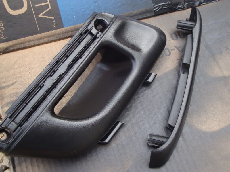

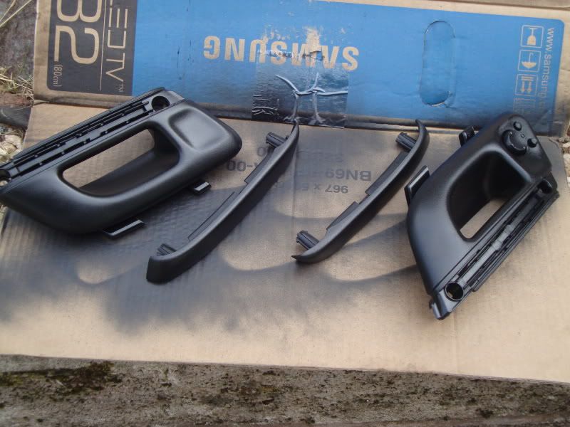

robrado974 1 Posted July 31, 2011 no biggy just wanted to show how they came up using halfrauds vinyl paint . Mine were covered in scratches by other owners holding keys while pulling the door to close it . They look 100% better .Will be doing all the plastics soon . Quote Share this post Link to post Share on other sites

robrado974 1 Posted July 31, 2011 Before they were faded by sun and marked as i said . Dont think they look painted [as long as you dont spray too thick or not enough drying time etc]. I put it on in thin coats and built it up ,they look natural. I put a post up a while back to ask how they were when the car was built , i knew plastic is plastic but you can have glossy ,satin, matt whatever from the factory . As for the mirror switch i masked up the left and right white bits . preparation was a good clean to get grease and polish off .regards rob Quote Share this post Link to post Share on other sites

Pete 0 Posted July 31, 2011 Looks great, did you use black or dark grey to match? Quote Share this post Link to post Share on other sites

robrado974 1 Posted August 1, 2011 thanks guys , pete ,i used black . regards rob Quote Share this post Link to post Share on other sites

robrado974 1 Posted August 4, 2011 The grab handles are held on by two screws that are behind the plastic cover which is pictured in spray pic .No need to remove panels . regards rob Quote Share this post Link to post Share on other sites
