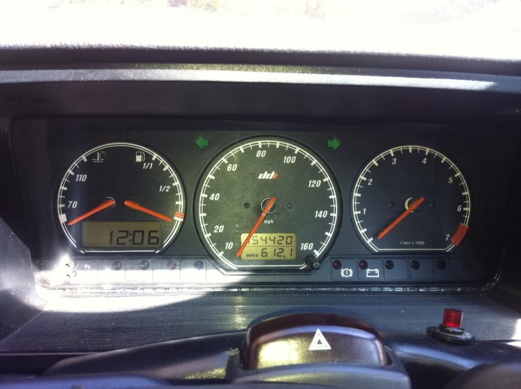

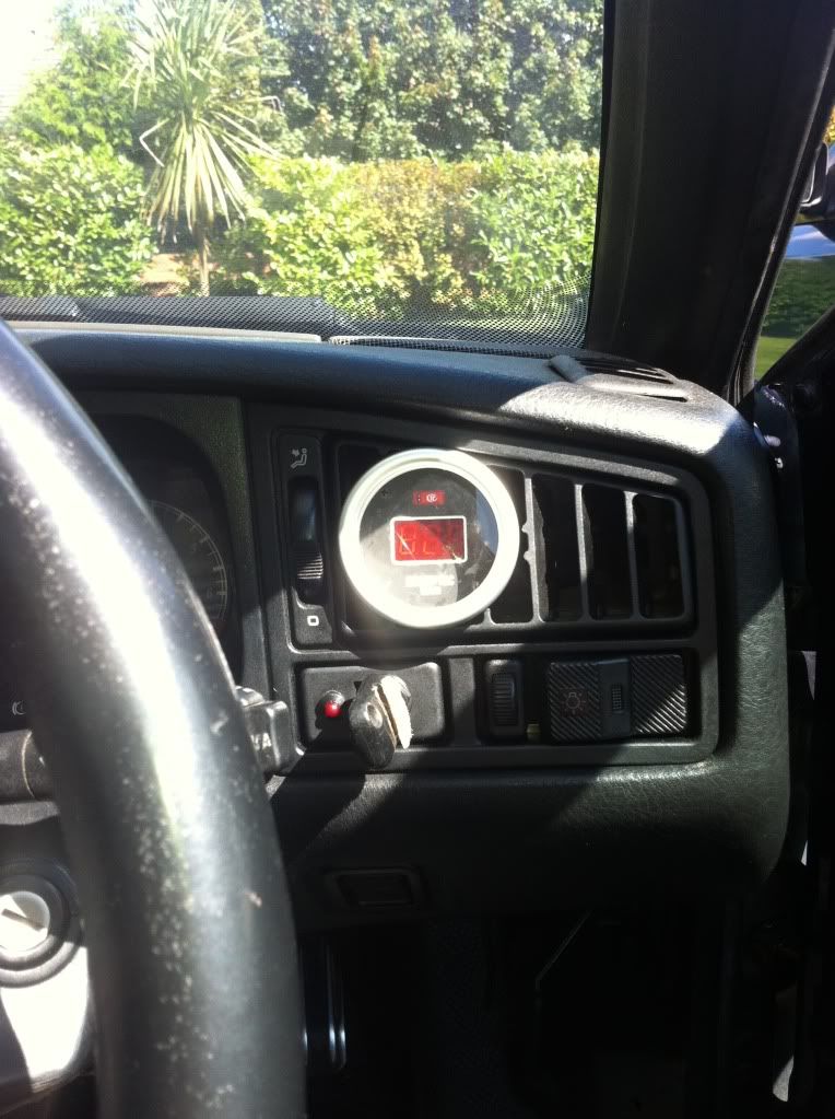

owen g60 10 Posted August 27, 2011 Late heated leather interior DDI dials Moved the boost gauge... was zip tied to the A pillar A few trim peices need tidying/replacing but an gradually mounting them all up to do in one big hit Quote Share this post Link to post Share on other sites

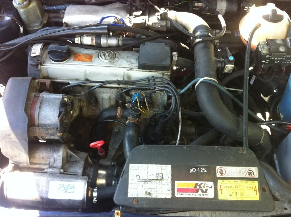

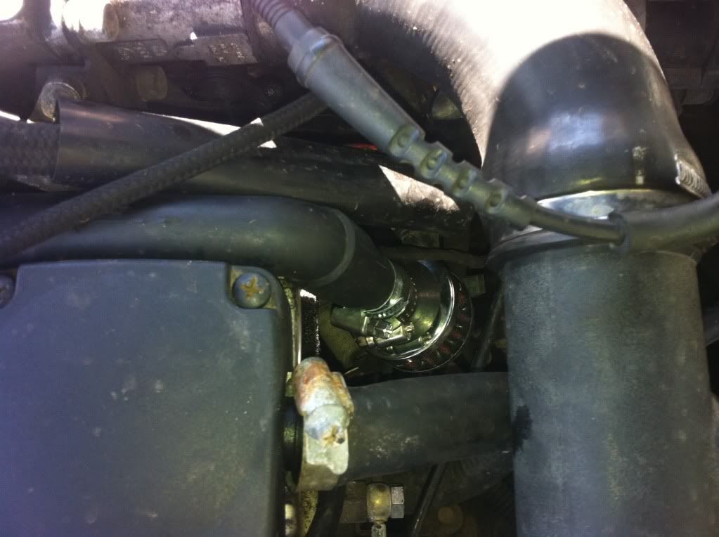

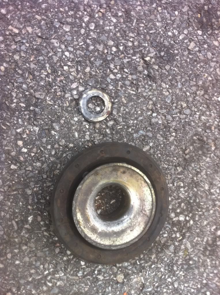

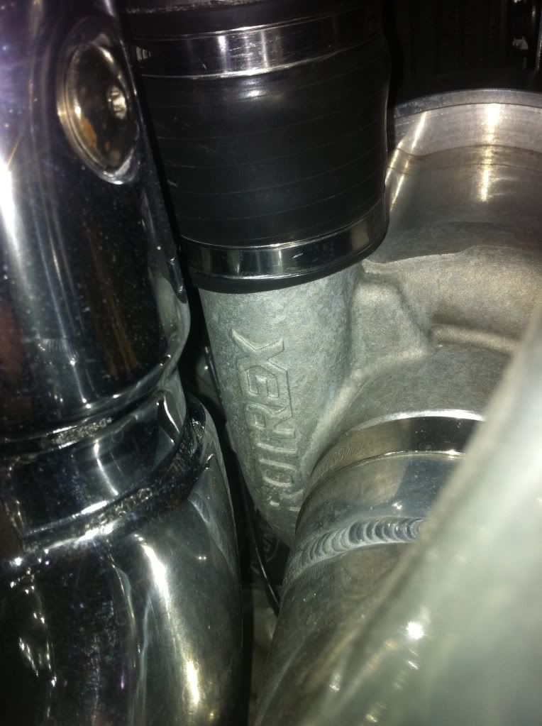

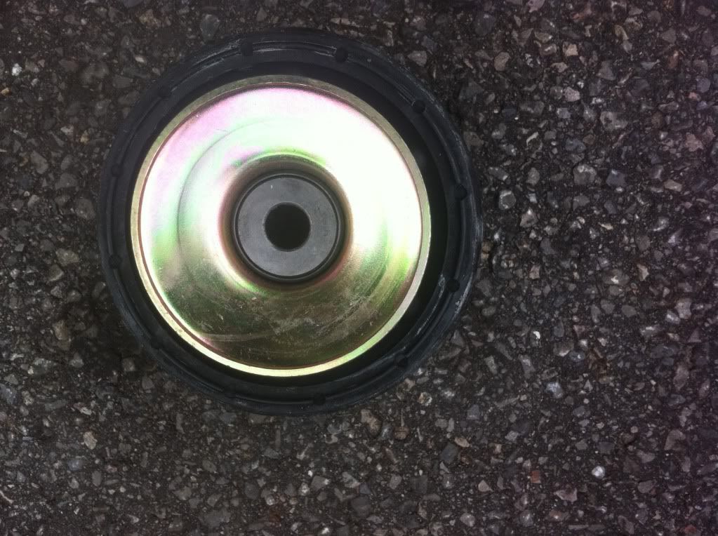

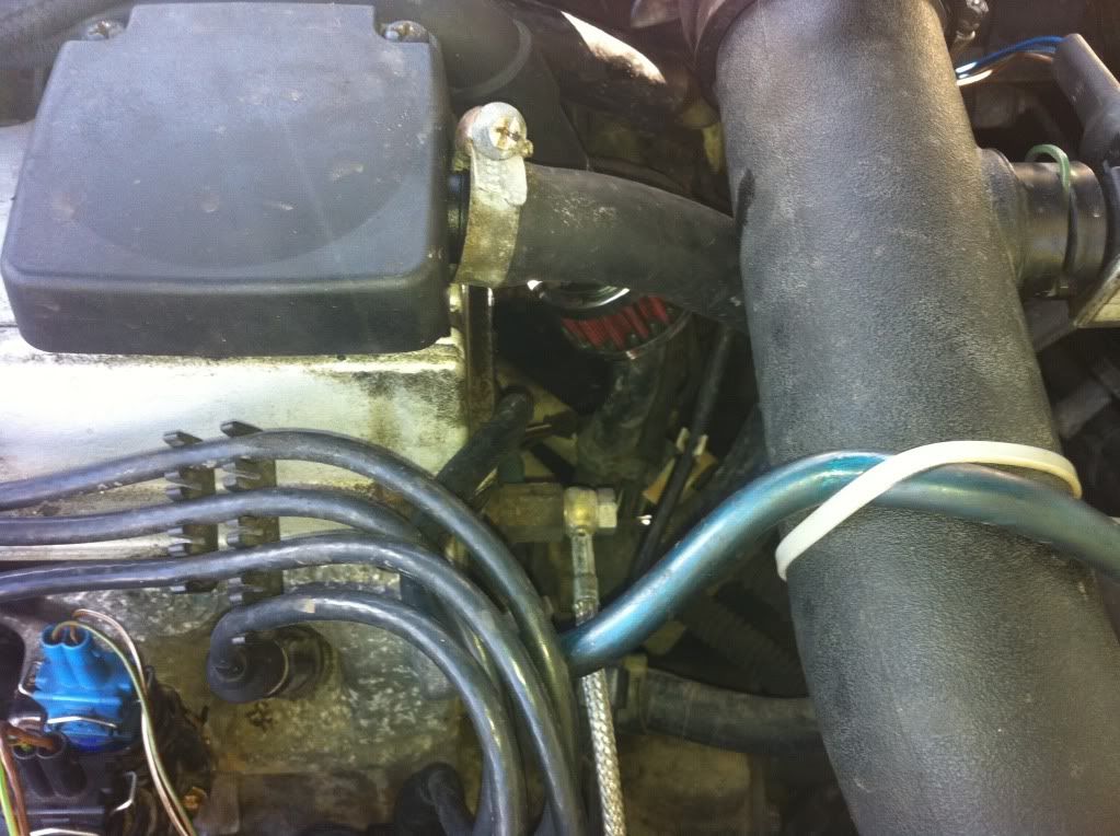

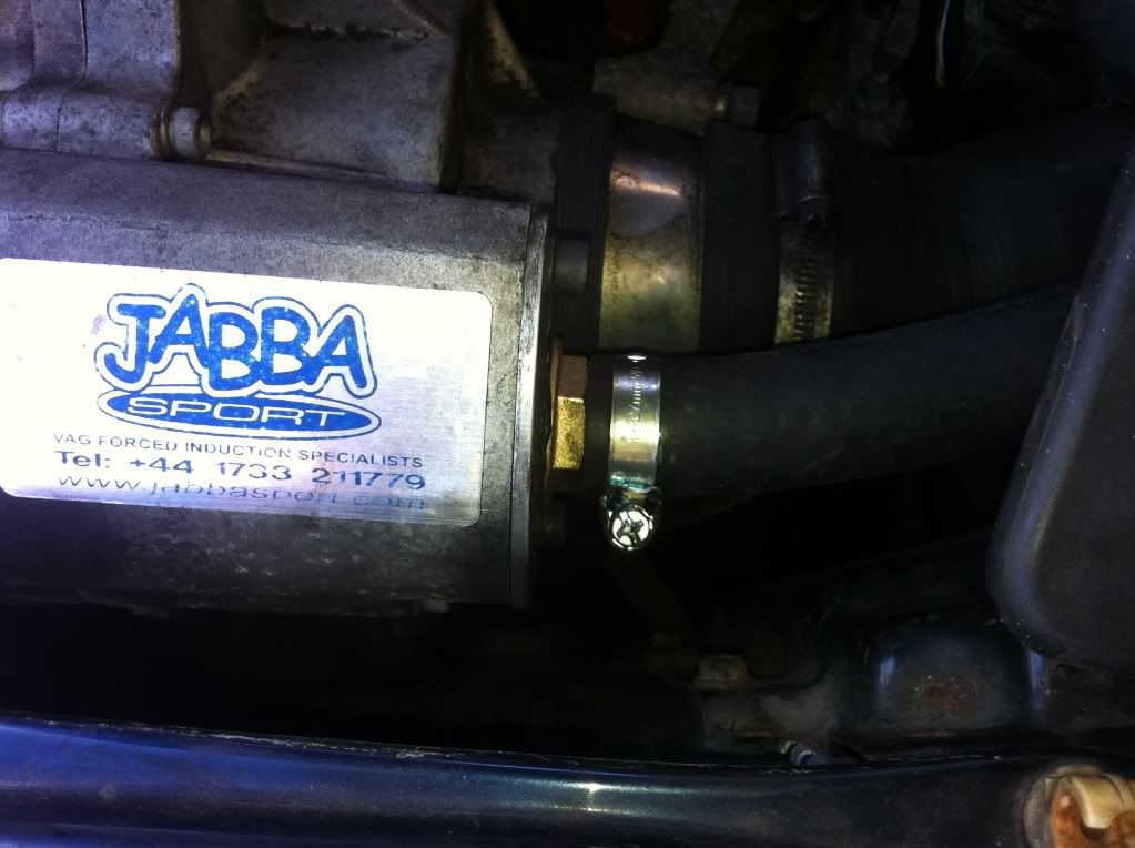

owen g60 10 Posted August 27, 2011 Boost return mod fitted last night Close up on the charger (stage 4 atm) ISV BREATHER FILTER After having terrible wheel wobble i had a look at my top mounts OLD ONE just slightly broken:bonk: What it should look like Quote Share this post Link to post Share on other sites
chefg60 0 Posted August 30, 2011 Hi like the thread what do you attach to the throttle body? ---------- Post added at 07:56 PM ---------- Previous post was at 07:54 PM ---------- just noticed you clocks too... just bought the same. do yours light up? Quote Share this post Link to post Share on other sites
owen g60 10 Posted August 30, 2011 i didnt attach anything to the throttle body... just adjusted the butterfly so that it is open for less time ---------- Post added at 08:28 PM ---------- Previous post was at 07:58 PM ---------- yes my clocks do light up... both the dials and the digital parts Quote Share this post Link to post Share on other sites
chefg60 0 Posted August 30, 2011 i cant get mine to light up :-( Quote Share this post Link to post Share on other sites
owen g60 10 Posted August 30, 2011 have you spliced the inverter into the loom in the correct place??? ignition live is where mine has gone Quote Share this post Link to post Share on other sites
chefg60 0 Posted August 30, 2011 ah i was told to link it up too head light switch Quote Share this post Link to post Share on other sites
owen g60 10 Posted August 30, 2011 that should work too.... any switchable 12V line is good... all down to personal preference Quote Share this post Link to post Share on other sites

owen g60 10 Posted September 27, 2011 New spec headlight switch in place now :) Finally managed to fit the new cross member, was far easier than i thought it was going to be. New 68mm pulley and belt fitted, feels so much more alive now ive done it (again) FMIC was a fail as the slam panel gets in the way of it and i dont want to cut into it. Will have to re-think this one. Managed to shear the banjo bolt for the charger whilst changing the copper washers due to it weeping :(, was lucky that it just unscrewed by hand... nowhere stocked one near me so it was into the shed to machine a replacement... all is good now so no down time for once :). Recieved my old spec sunroof motor today after months of trying to get one relatively cheap. First Aid kit should be here soon (old one got nicked at a car show). Finally a full clean out and wax and polish to make me feel better about it. Off to the body shop on friday to repair the N/S arch after a numpty reversed into me Quote Share this post Link to post Share on other sites

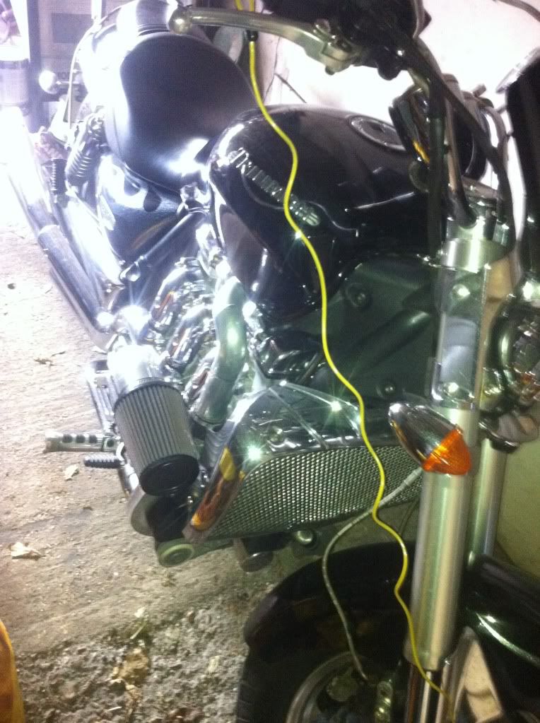

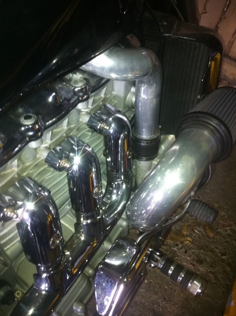

owen g60 10 Posted October 17, 2011 (edited) though i would add a couple of pics of the newest addition to the supercharged family :cheers: Was bought as a bit of fun...Triumph Rocket III and if you cant spot the charger yet :shrug: and for the super blind :bonk: im sure i saw a dyno print out in the box of reciepts for it approx 280 bhp ant the wheel if what i have been told is correct:dance: Edited October 21, 2011 by owen g60 Quote Share this post Link to post Share on other sites
Redfox 10 Posted October 19, 2011 Close to me there is a dealership wh had a demo day, and there's one guy who all the time entertained the crowd by wheeling forth and back on this supercharged model ;) Cheers, Redfox. Quote Share this post Link to post Share on other sites
