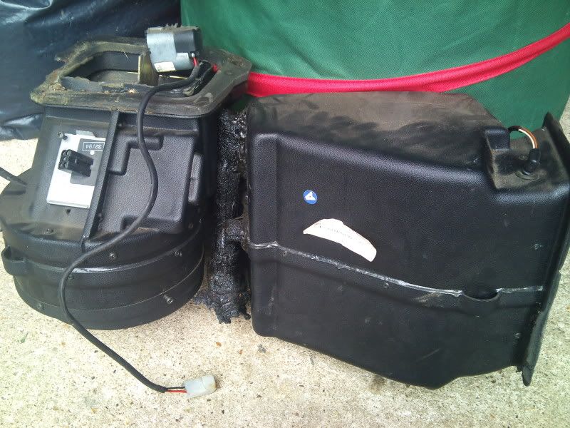

Jim Bowen 1 Posted October 11, 2011 do i need to take both these big bits out? pulled the hoses through and got them out now, its just the electrics to do. can't get to them very easily as they are behind that lot Quote Share this post Link to post Share on other sites
joebloggsVR69 0 Posted October 11, 2011 Yep, that whole blower needs to come out, along with the pipework in the middle of the pic. You'll need another blower box to replace it, one from a non -aircon car Quote Share this post Link to post Share on other sites
Jim Bowen 1 Posted October 11, 2011 Is the blower the round one on left? The box on right says diavia on it so taking that out. Also where is the heater matrix meant to be? learning as I go really. Sent from my X10i using Tapatalk Quote Share this post Link to post Share on other sites
fla 9 Posted October 11, 2011 yes, onl the left, but the remainder comprises the airbox. The heater matrix will be fitted to the back of the airbox, more likely inside it Quote Share this post Link to post Share on other sites

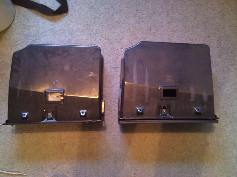

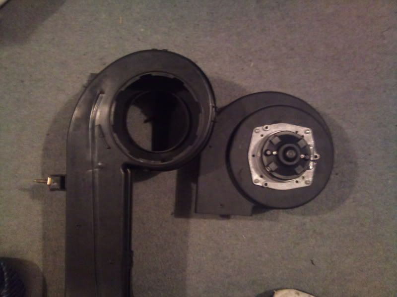

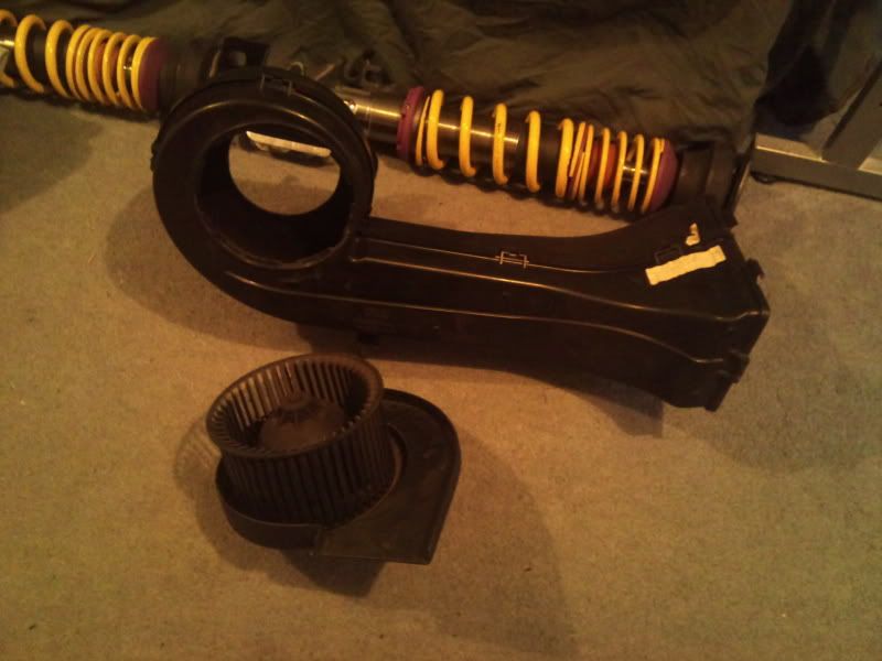

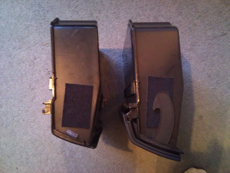

Jim Bowen 1 Posted June 22, 2012 Finally removed everything and looking to replace this bit now. Got the big duct bit (thanks to cazzaVR) and took the actual blower and motor out of original bit, but they don't seem to go together? Do i also need a new blower with motor? also just to add to the thread, i bought another corrado glovebox and its exactly the same as my aircon one. Quote Share this post Link to post Share on other sites
24V Renshaw 0 Posted June 23, 2012 Yeah fan is different too. You need everything for non aircon. Glovebox is never different, just the bottom shelf is butchered by the Diavia installers. Jay Quote Share this post Link to post Share on other sites
