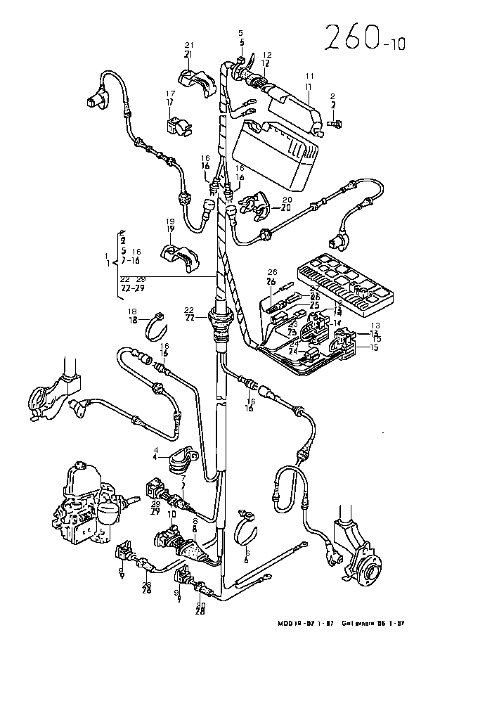

Have you got the part numbers and a pic as all my relays are in a box currently - or is it the big unit down to the left bolted onto the side of the foot well??
Is it any of the parts on here:
