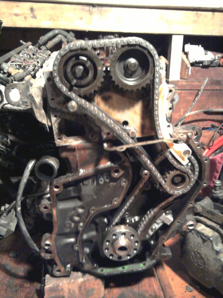

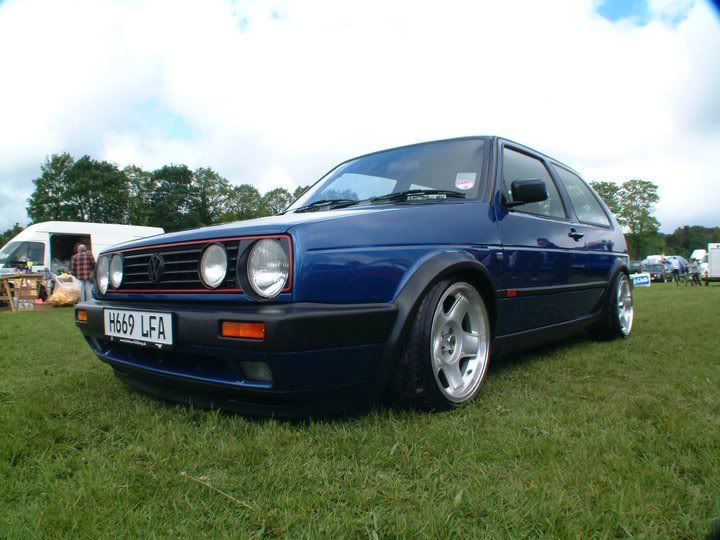

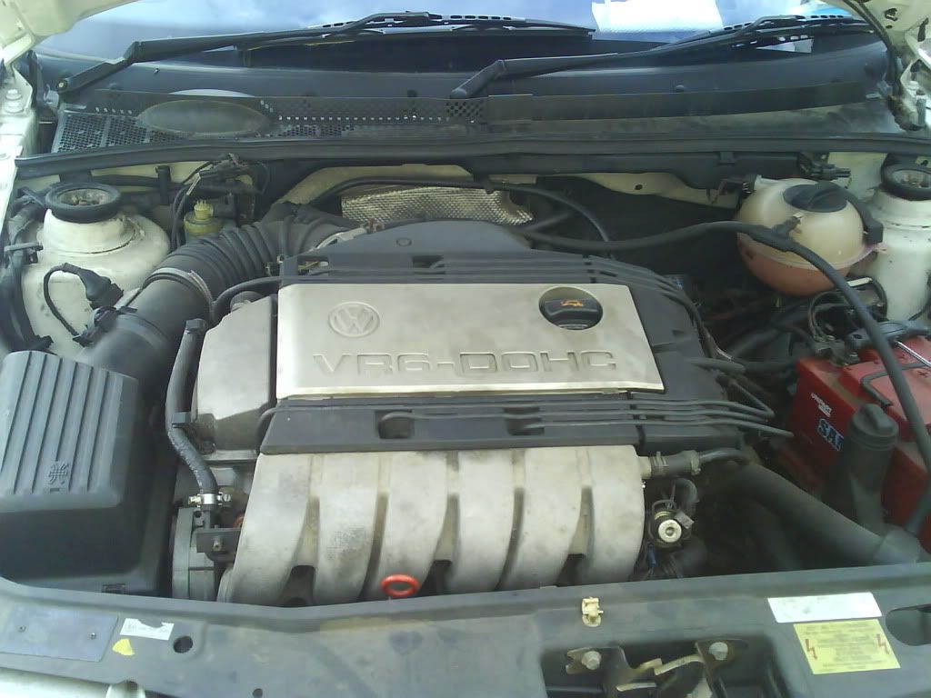

Hartosh1 10 Posted November 15, 2011 Well i know its not a Corrado but it is a VR6 hope nobody minds me putting this up Found a mk3 OBD1 with 139k on the clock for a good price but it did need some tidying up Bought a mk2 golf off my mate a few months back with the intention of dropping a vr6 into it. After around 2 months ownership i started the conversion with 2 mates. Got alot done the first weekend engine came out and sub frame etc. My mate cleaned up the bay for me but i dont have any pictures of it unfortunately I decided to go hydraulic clutch as finding a cable conversion kit was proving to be a nightmare and there was plenty of hydro set ups available. My mate did all the chains on this car as i dont trust myself with the timing side of things. I wasnt going to bother with the head gasket but after trying to get piston 1 to tdc and snapping a bit of copper rod in the cylinder :bonk: i decided it was best just to do it for piece of mind. Had the valve stem oil seals replaced, valves relapped and head skimmed. Got a victor reinz head gasket set including head bolts for a decent price. ---------- Post added at 03:09 PM ---------- Previous post was at 03:05 PM ---------- How it stands today Not quite finished yet still looking for a few bits but hoping to get it road worthy in the next 2 weeks None of this would have been possible without the help of my 2 mates so alot of credit goes to them but i reckon we all pitched in the same. Quote Share this post Link to post Share on other sites

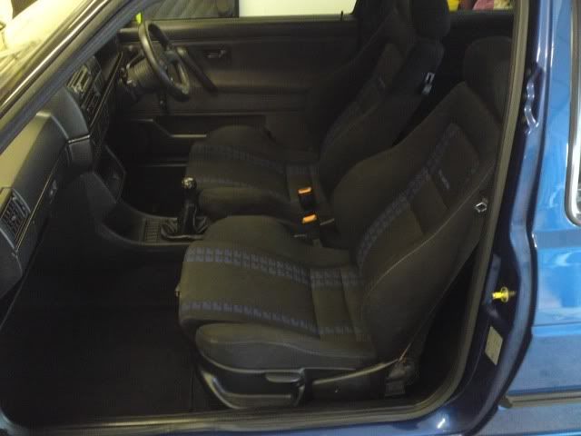

bristolbaron 11 Posted November 15, 2011 looks like an absolute beauty bud. whats the interior? Ultraviolet recaros would look stunning in that.. Quote Share this post Link to post Share on other sites
Hartosh1 10 Posted November 15, 2011 Interior is recaros mate it was my mate that had the car before me put them in Only pic i have of interior just now bud Quote Share this post Link to post Share on other sites

bristolbaron 11 Posted November 15, 2011 winner.. would still love to see ultraviolets in it, however mk3 gti editions work pretty damn well. good work, thats a really really nice mk2. Quote Share this post Link to post Share on other sites
