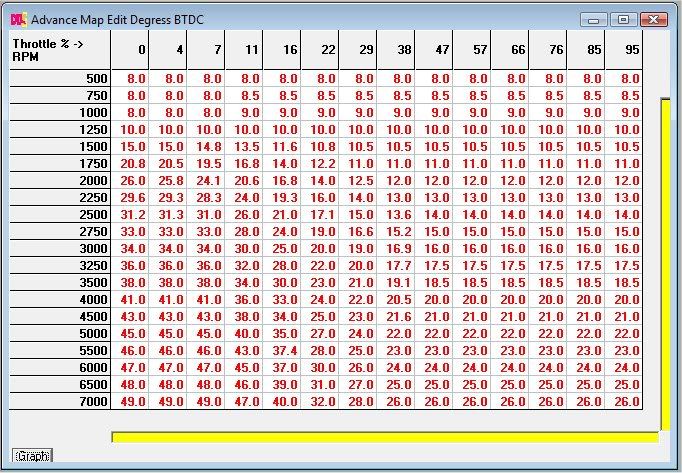

Kevin Bacon 5 Posted November 30, 2011 Is your intake switching? Mine's hooked up to AUX 3. On (torque mode) at 900rpm and off (Power mode) at 4100rpm. Mine's sequential injection and OEM coils and both cams are hooked up. My cams aren't yet mapped (running full retarded, or 'off') and it still pulls like a train low down. I'm using the OEM DBW throttle with a DTA controller. I will be mapping the cams on a dyno at some point in the future. I will send you a pic of the timing map I'm using. Quote Share this post Link to post Share on other sites
Kevin Bacon 5 Posted November 30, 2011 I will send you a pic of the timing map I'm using. As promised... Based on TPS v RPM + MAP compensation. Use at your own risk ;) Quote Share this post Link to post Share on other sites

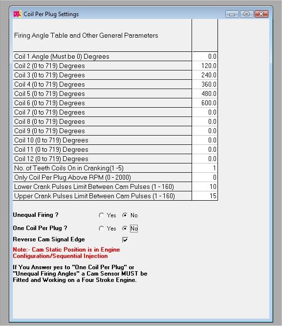

Kevin Bacon 5 Posted December 6, 2011 Here's as good a place as any ;) Setting the cams up is best done on the dyno really but it can also be done by looking at the lambda corrections. Start off with small PWMs in the cam table. The basic principal is to advance the inlet cam fully at low engine speeds to maximise cylinder filling, then slowing retard it back to zero as the rpms rise. The cam settings need to know the cam angles, so I would switch to flywheel mode 26 and then configure your coil-per-plug settings like this. The DTA will then give you a cam static position of around 90 degrees. Mine's 88. If you choose to run sequential fuel, these settings will keep the same cam tooth as the cams advance and retard. As for the solenoid noise, I don't get any from mine :D I run it at the maximum hz of 400. Quote Share this post Link to post Share on other sites
