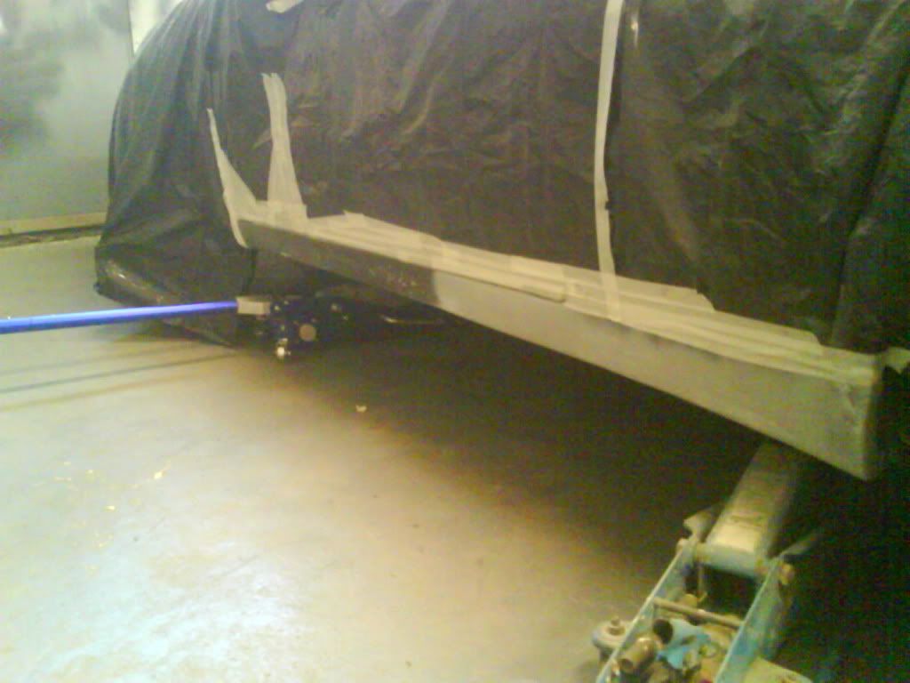

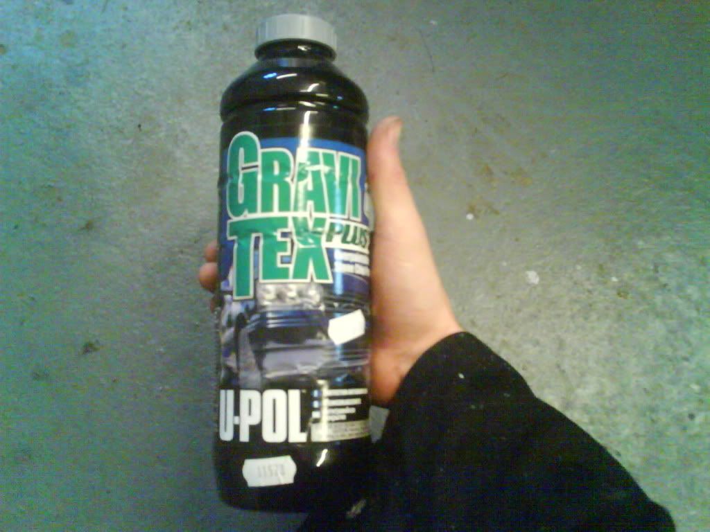

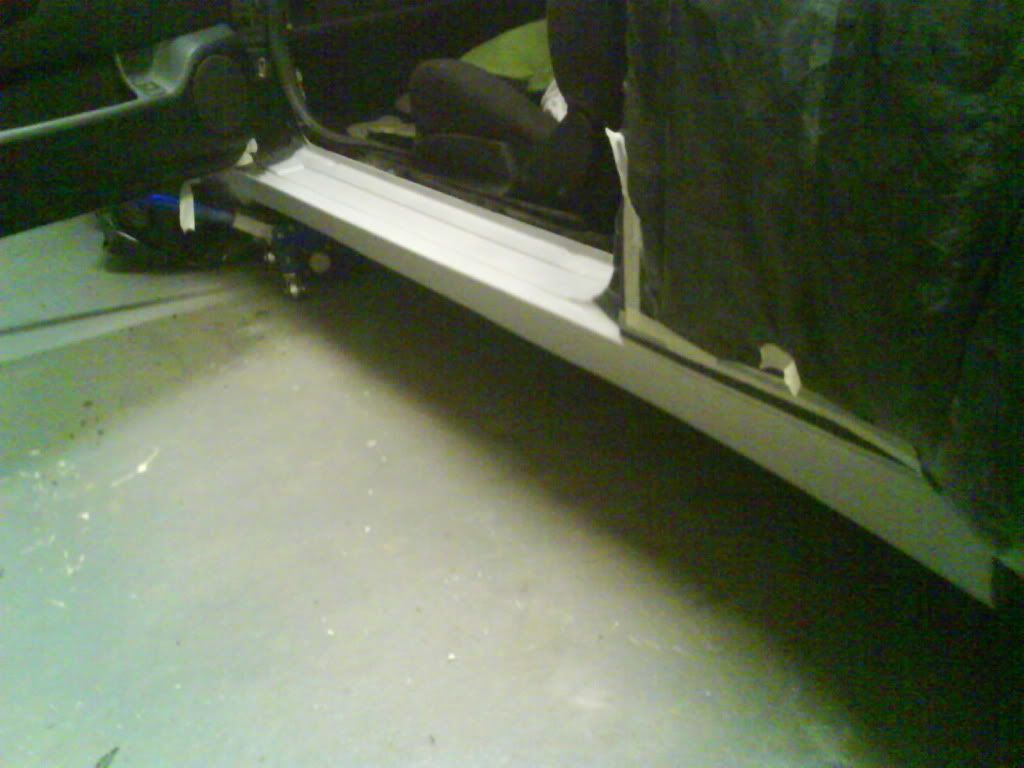

VW_OwneR_85 2 Posted February 1, 2012 (edited) scruff, i assume you mean light sanding? Where can i get this U-pols Gravitex from? how far up did you sand? just the swage line where the sill ends? yea but no, dont sand because you want to keep the rough texture and sand paper will only flatten that and also wont get into the low spots of the texture, use these green scotch pads and just rough/scuff it up for a good key for the colour coat to adhere, http://www.ebay.co.uk/itm/Starchem-Finishing-Pads-Starbrite-Scotch-Abrasive-mix-9-/300507552944?pt=UK_Body_Shop_Supplies_Paint&hash=item45f7a55cb0 also the first thing you need to do is clean the sills with hot soapy water and remove everything all the oil,tar dirt etc etc otherwise anything thats there will only get pushed and sanded further into the paint and when it comes paint time your get contamination everywhere.yea i only masked up just half way across that body line but my car was getting a full respray so it didnt matter to much to me but you should be able to do it and keep it lookn prety good, are you buying a compressor and paint gear? heres some pics, i sanded the lot flat because i had to reshape most of the sill i also wanted a consistant texture rather then the haveing the oem texture going into my new texture which would just stand out, its primed like that becuase i had to sand out surface rust right next to the sill protector ,you dont have to go that far.. Edited February 1, 2012 by VW_OwneR_85 added pics Quote Share this post Link to post Share on other sites
Critical_Mass 10 Posted February 1, 2012 Thanks for the pics mate, really helped. If it will give me a better finish ill consider getting a compressor and gun. In regards to how much of the sill you sanded back, what about under neath how far did you go. Was it to the lip the scissor jack stands on? Quote Share this post Link to post Share on other sites
VW_OwneR_85 2 Posted February 1, 2012 yea almost to the lip, but aslong as you go far enough to where you can see it ya know? you dont have to go that far, yea a compressor will be needed, you can try the aerosol cans out on a test peice and see what its like? but to spray that gravitex and get the texture it takes like 50psi, an aerosol cant realy put thick paint out like that,btw its **** easy to spray that gravitex, if you do buy a compressor get one with a high cfm something around 9-10 is good then you can spray stuff if you ever wanted to, this compressor is ideal!! with a 14 cfm! in fact the specs of this compared to mine kills mine!!! and i paid prety much the same price, damn!! http://www.ebay.co.uk/itm/BURISCH-Air-Compressor-3HP-90L-Belt-Drive-Twin-14CFM-Twin-Cylinder-/160721262092?pt=UK_Air_Tools_and_Compressors&hash=item256bbbd60c Quote Share this post Link to post Share on other sites
