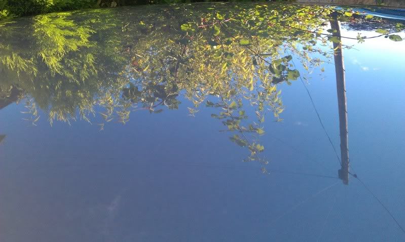

tim20vt 0 Posted February 3, 2012 (edited) are you sparaying it yourself? you mite be better with a paint supplier rather than ebay.autopaintsbrighton have a website they mite also be on ebay. alot of it comes down to what make you like to spray. mipa,ici nexa,standox,lechler all the base coats i have used have been fine id say ici nexa good coverage 2k clear i like u pol,hb body for the price, upol slightly easyer to work after for the price of upol on ebay may be worth a shot i have used it for years and always got good results and stayed in great shape over time. bumpers nexa thinned with mipa stabiliser then upol 20:80 sr super fast hardner body nexa thinned with mipa stabiliser then hb body 496 sr-polar hardner sprayed at around 20 degrees,air dry,stabiliser due to colour. below is gun finish and flat and buffed finish Edited February 3, 2012 by tim20vt Quote Share this post Link to post Share on other sites
VW_OwneR_85 2 Posted February 3, 2012 hi tim , which upol clear do you use? have you used either s2081 or s2080? was thinking about getting some awhile back as i can get upol stuff at trade price..those pics look amazing btw! Quote Share this post Link to post Share on other sites
carrots 1 Posted February 3, 2012 it does look good tim.we used to sell upol in work before we stopped selling paint a lot of people didnt like it.cant see why tho with that shine.is that the same thats for sale on ebay Quote Share this post Link to post Share on other sites
GlosterOx 0 Posted February 4, 2012 Bottom pic looks spot on Tim, what colour is it out of interest? Ian. Quote Share this post Link to post Share on other sites
