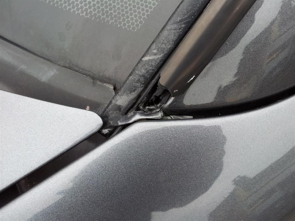

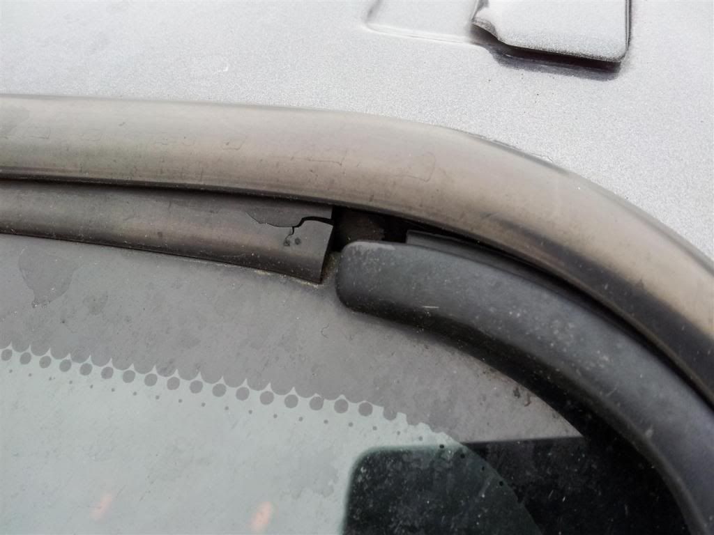

UseOnceDestroy 0 Posted February 6, 2012 I've seen a few threads posted about leaking problems recently... I have one of my own, just wondered if anyone could give me their opinion. My rear passenger footwell is sopping wet, the front passenger footwell is bone dry and so is everywhere else which seems odd to me. I've read a coupla of problems with windscreens recently, just wondered if this could be my problem too. The seals around the passengers side don't look great. Any chance the water could be finding its way in here, missing the front passenger footwell and running to the rear??? The paint sprays on the rubber doesn't actually look that visible in person, looks awful in that picture!! :eek: Quote Share this post Link to post Share on other sites
StueyB 0 Posted February 6, 2012 Well worth doing a little strip down and pull the carpet up. From the rear passenger footwell you should be able to trace the wet patch up to the source. Failing that after the strip down, shut the car up and spray the car with the garden hose with someone inside the car. Should find the culprit weak area. ---------- Post added at 12:55 PM ---------- Previous post was at 12:55 PM ---------- Oh and my monies on door seal. Quote Share this post Link to post Share on other sites

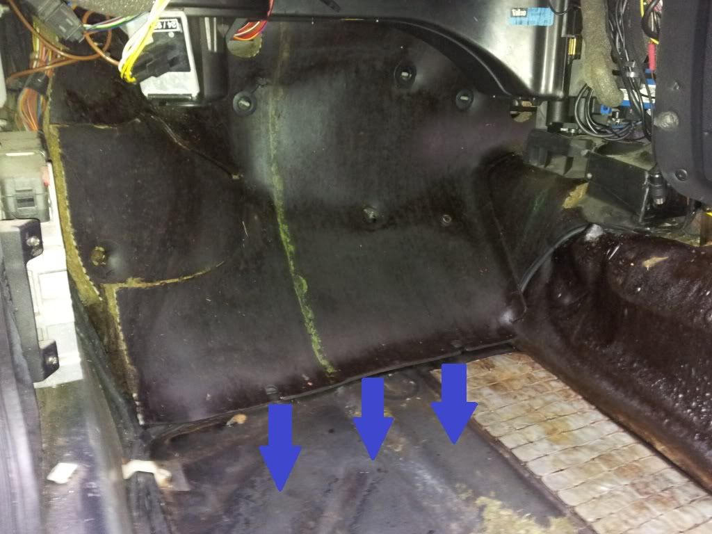

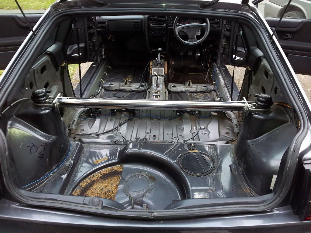

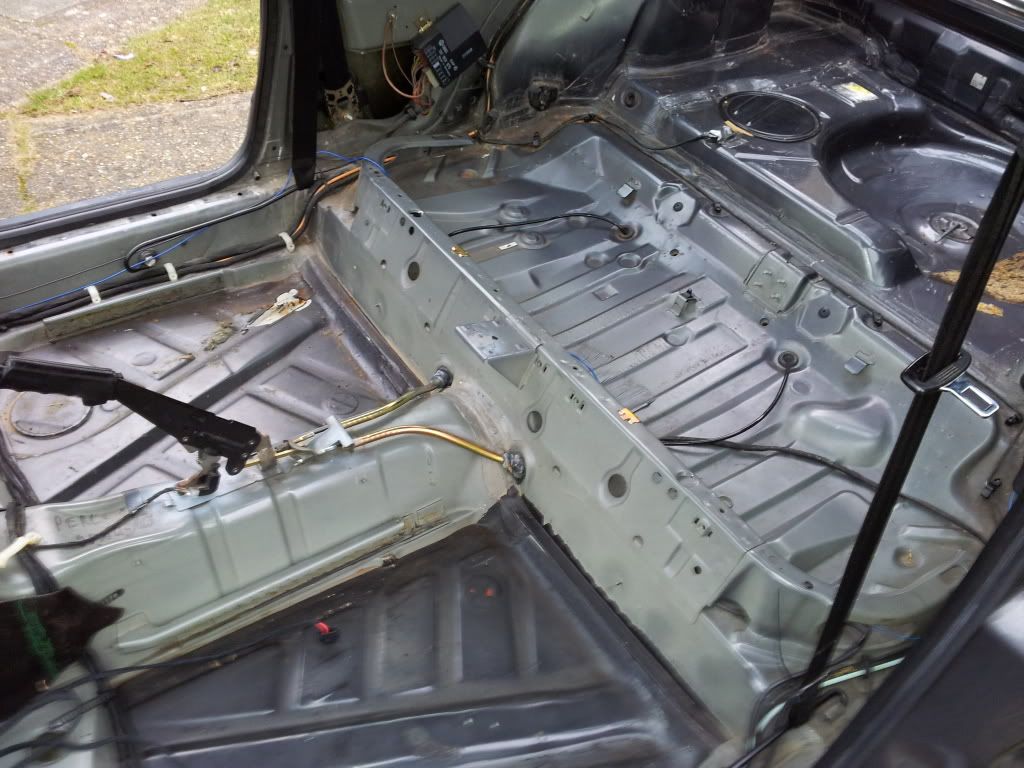

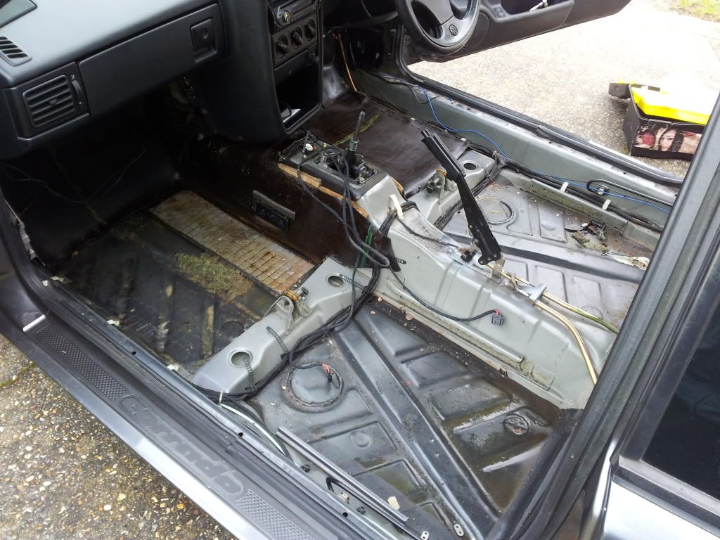

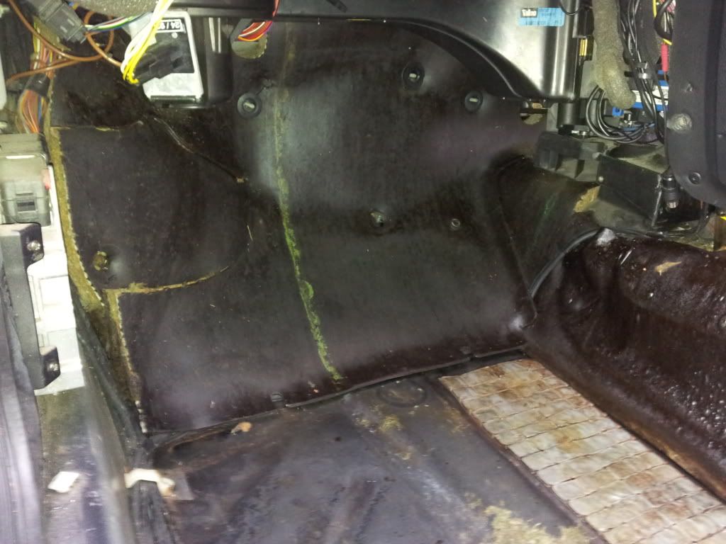

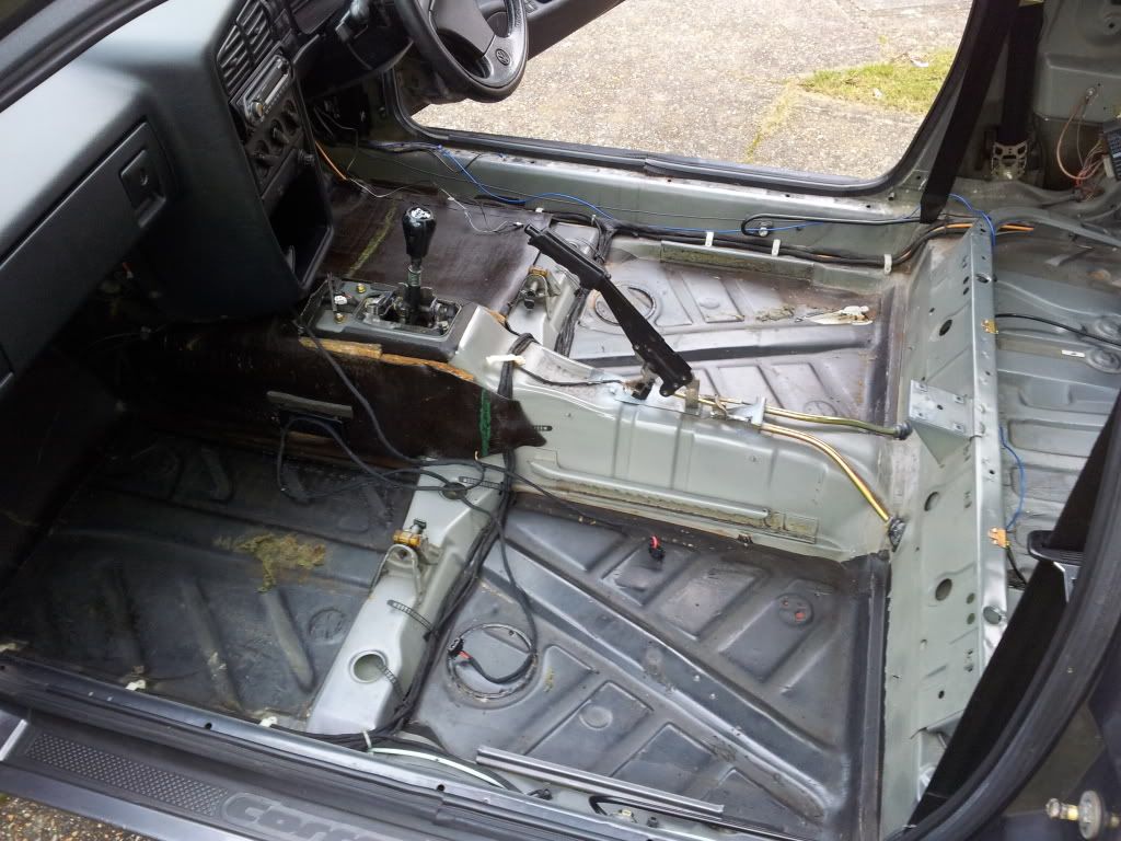

UseOnceDestroy 0 Posted February 12, 2012 (edited) So I stripped the interior of my car today... Good news is, there is no leak!... Bad news is, I was slightly (massively) mislead (lied to) by the garage that replaced by Heater Matrix over a year ago!! It blew about a year and a half ago and sent floods of liquid into the passenger footwells, had the garage replace it and they told me they replaced the soundproofing under the carper but the carpet was still wet so I'd have to dry it out. I left a heater in there for hours at a time and eventually, everything felt bone dry. The rear of my car has been stripped for ages so it isn't ever in use, it has probably been soaking ever since but I just didn't notice. The soundproofing that hadn't been replaced was absolutely dripping wet with antifreeze when I removed it... there was a large puddle beneath it too! So, I've stripped everything out... but the sound proofing behind the dash is still sopping. Going to remove the dash soon. Anyone know if it's possible/legal to drive without a dash? What would people recommend to replace all the factory soundproofing. I'm going to cover the entire inner shell with Fatmat while everything is out. Gonna do a proper job on it and bit my bit, get everything re trimmed and refitted. Would like to look into climate control while I've got everything out too I thinks. Any other jobs that are worth doing whilst everything is bare?? Cheers Edited March 14, 2012 by UseOnceDestroy Quote Share this post Link to post Share on other sites
RadoVirgin 0 Posted February 12, 2012 You're in the same place as me at the moment, but mine is leaking from the cabin filter area. I'm looking to replace all of the horrid soundproofing too and am really interested in what you're going to use and how much it'll cost. My car has been fitted with the diavia a/c System which I'm looking to remove and just put back the standard heater system. Good work and good luck mate Quote Share this post Link to post Share on other sites

VW_OwneR_85 2 Posted February 12, 2012 seems like you found the culprit, i wouldnt worry about leaks from the windscreen, those seals and trims are there just to fill the gap and make it look neat, the screens actualy glued in. Quote Share this post Link to post Share on other sites

UseOnceDestroy 0 Posted March 5, 2012 So...... I thought I'd found the problem and buried it... However, after it p1ssed it down the other night, I saw water coming down from behind the sound proofing in the passengers footwell. I need to remove the rest of the sound proofing and maybe the dash to trace it properly... but before I do, any ideas people?? Quote Share this post Link to post Share on other sites
owen g60 10 Posted March 5, 2012 Are the rain channels on the edge of the scuttle panel clear? Also the seal over the heater motor is that sealed?? apart from that i can only think of the windscreen seal Quote Share this post Link to post Share on other sites
UseOnceDestroy 0 Posted March 5, 2012 As far as I'm aware, I think the scuttle panel is clear... and I wouldn't have a clue about the heater motor :/ Looks like its gonna be the screen :( How do people go about claiming on their windscreen cover? Pretty sure I've got it but does it not just cover cracks etc? Quote Share this post Link to post Share on other sites
Portent 0 Posted March 7, 2012 The heater motor is incredibly simple to check. It's literally on the left hand side under the passenger undertray. Once you remove the undertray it should be a white cylinder shaped item that sits below the scuttle. It might be black if it has been replaced. to remove it you just twist it right (I think) after gently prising a tab up behind it.However I doubt it's there. worth a quick check though.Maybe you should pop off the lower screen trim (carefully because the tabs break) and take a look at the bottom of the screen. It might be possible to find the leak there and seal it with some silicone? It's a bit of a bodge but it might be worth a try. Quote Share this post Link to post Share on other sites
StueyB 0 Posted March 7, 2012 I'd be very suprised if it was the windscreen seal, the sealant they use is incredibly tough and almost re-seal's itself after you poke a hole in it. My guess now would be the "Foliage Seal" for the heater motor cover. See here for details: http://wiki.the-corrado.net/changing_heater_scuttle_foliage_cover_seal.html Incredibly easy and satisfying to change & stopped my leak dead in it's tracks. Quote Share this post Link to post Share on other sites

OllieVR6 0 Posted March 7, 2012 For me, the water came in at the top of the windscreen in the corner on the passenger side. The difficulty in tracking it was caused by how the water was flowing once it was inside the car. I couldn't see it, but eventually discovered that it was flowing down the inside the A pillar to behind the dash (god knows where it went next) but it ended up looking like it was coming from behind the dash. After spending out to get the windscreen fixed I also discovered that one of the weather seals was fubar so make sure you do ALL the cheap/free jobs before paying out on the screen. Quote Share this post Link to post Share on other sites
