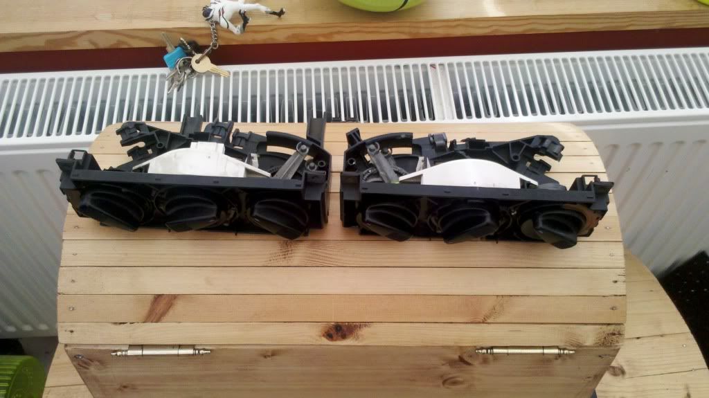

replaced the heater controls by utilising a mk3 set up and repairing the original controls:

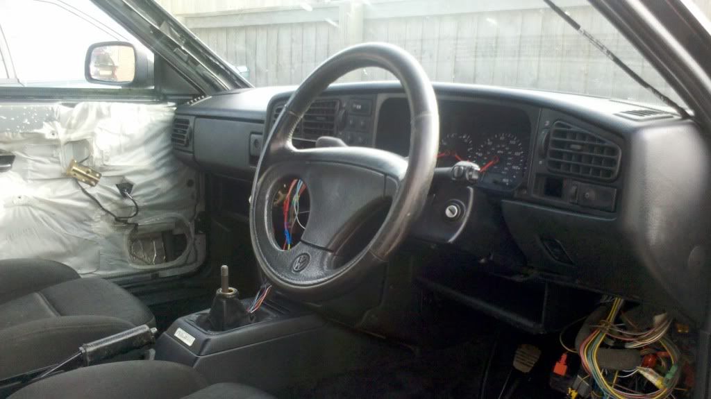

Got the interior back in once I replaced the complete wiring loom:

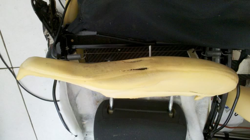

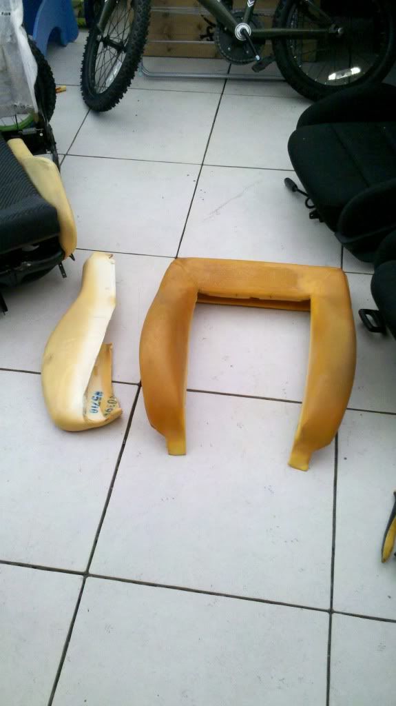

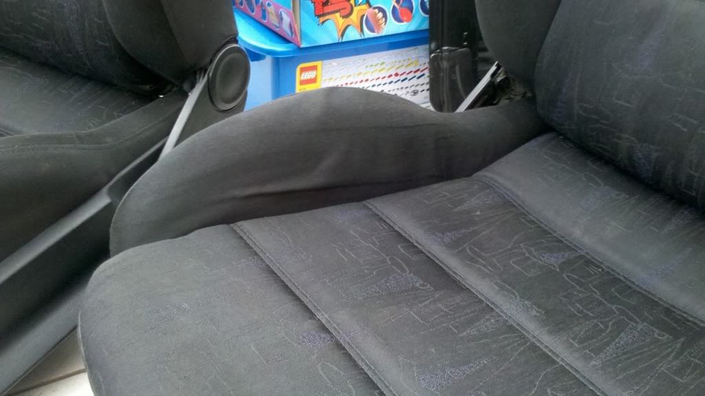

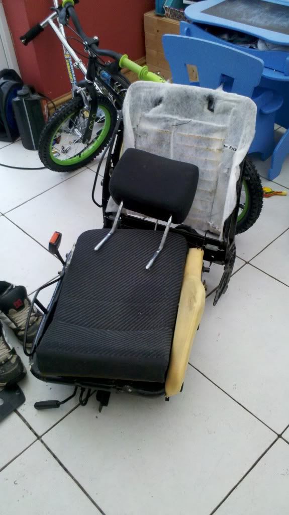

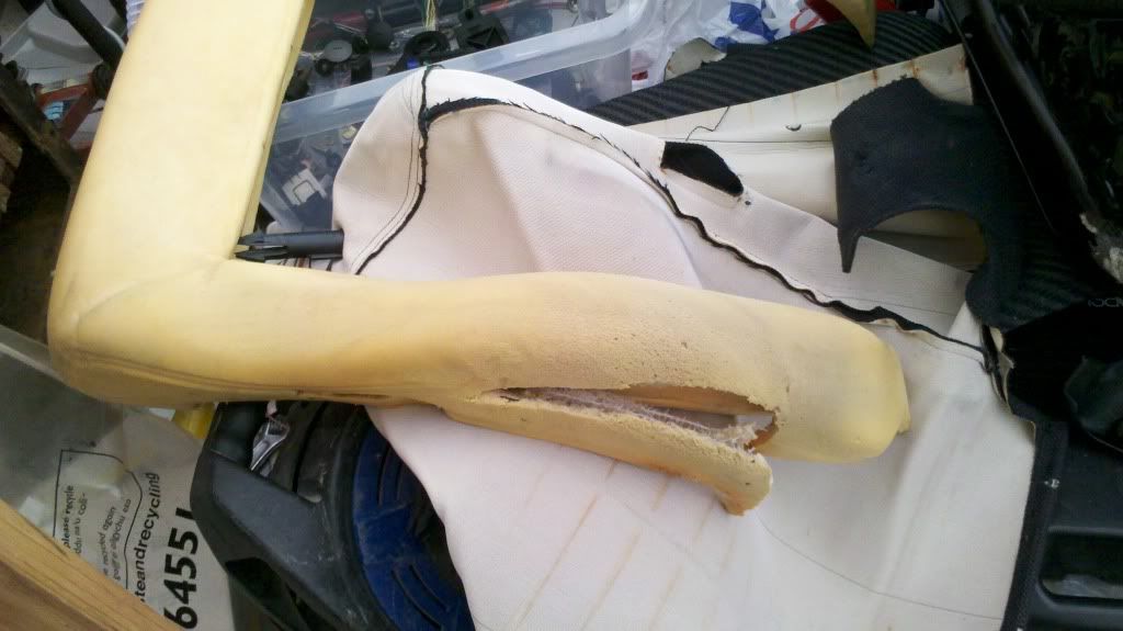

Repaired the drivers seat bolsters:
Before:
Replacement parts:

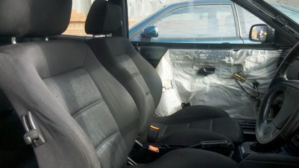

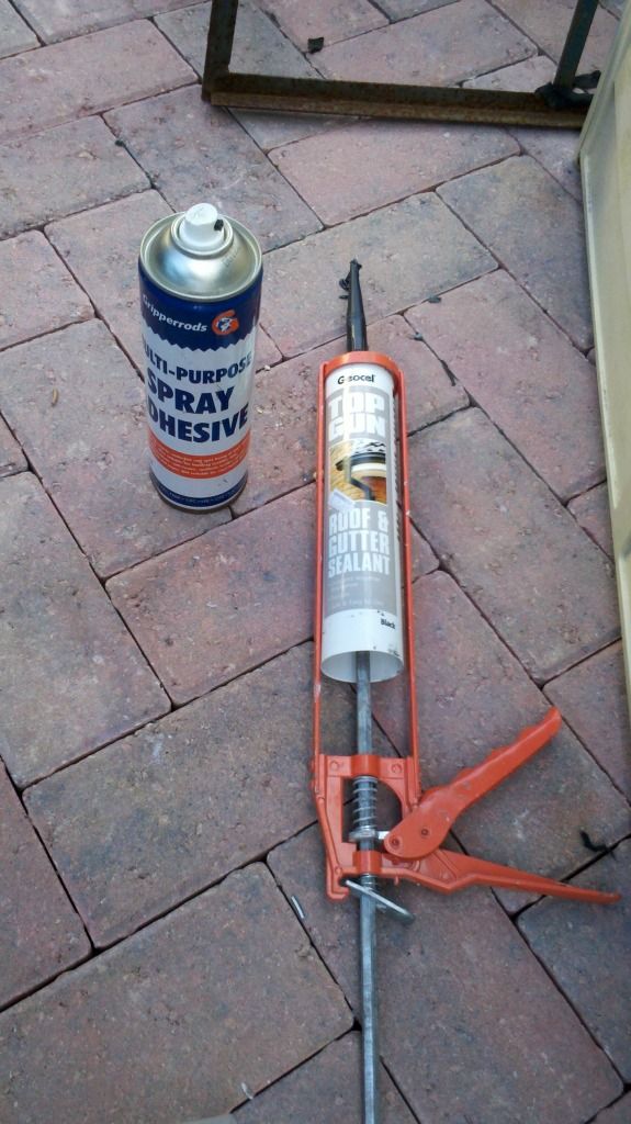

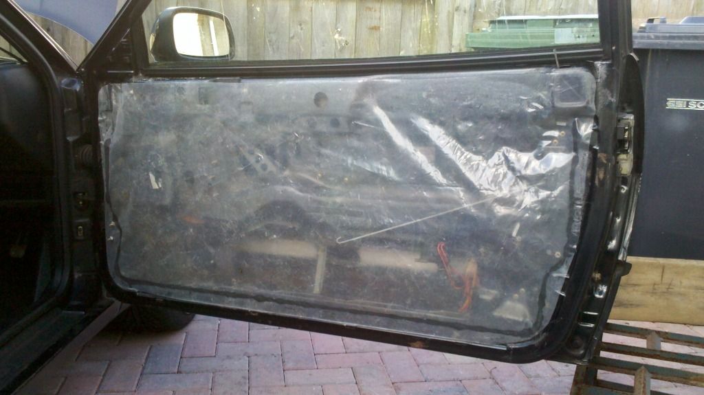

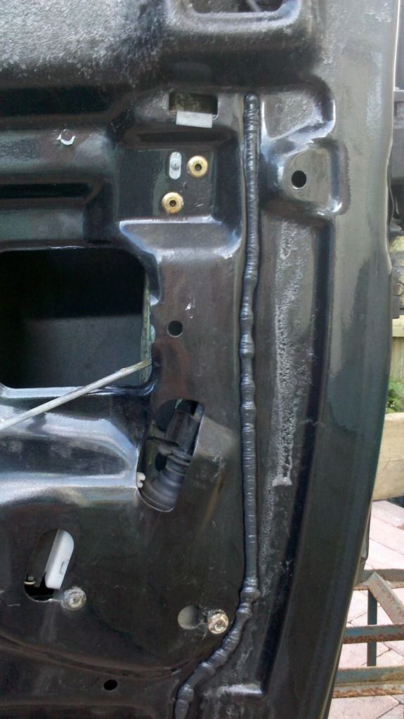

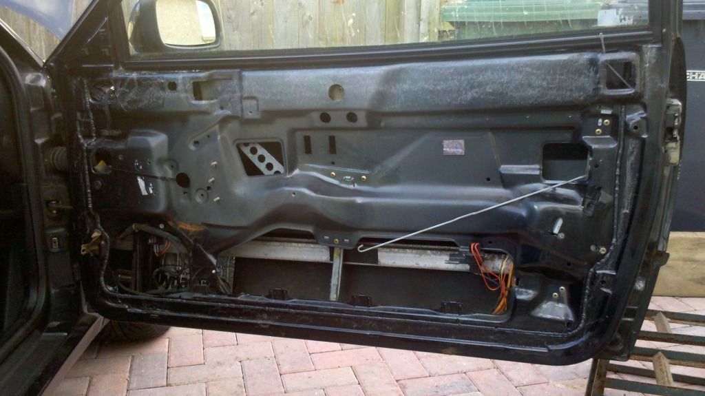

Replaced the door membranes:

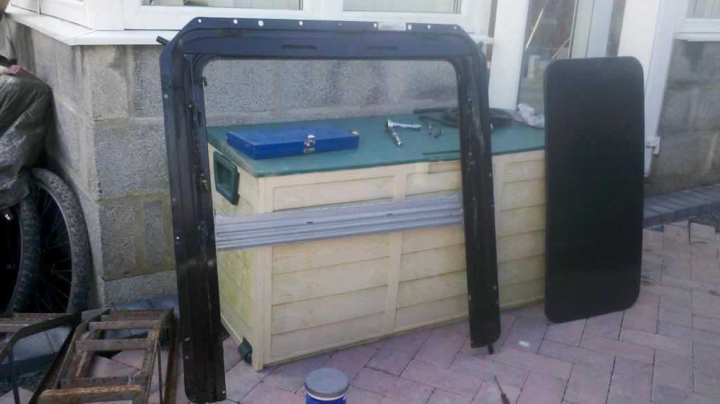

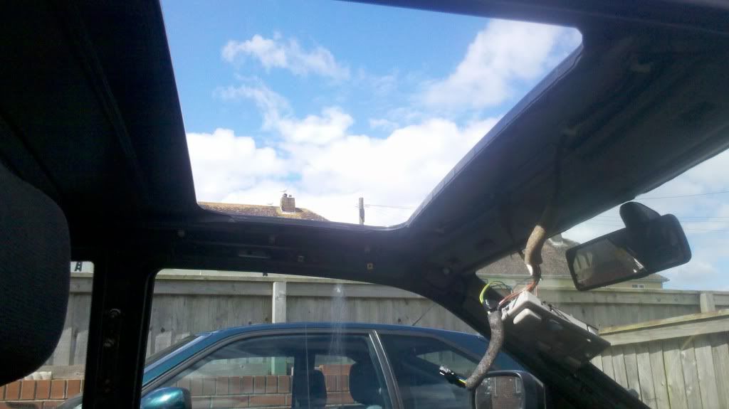

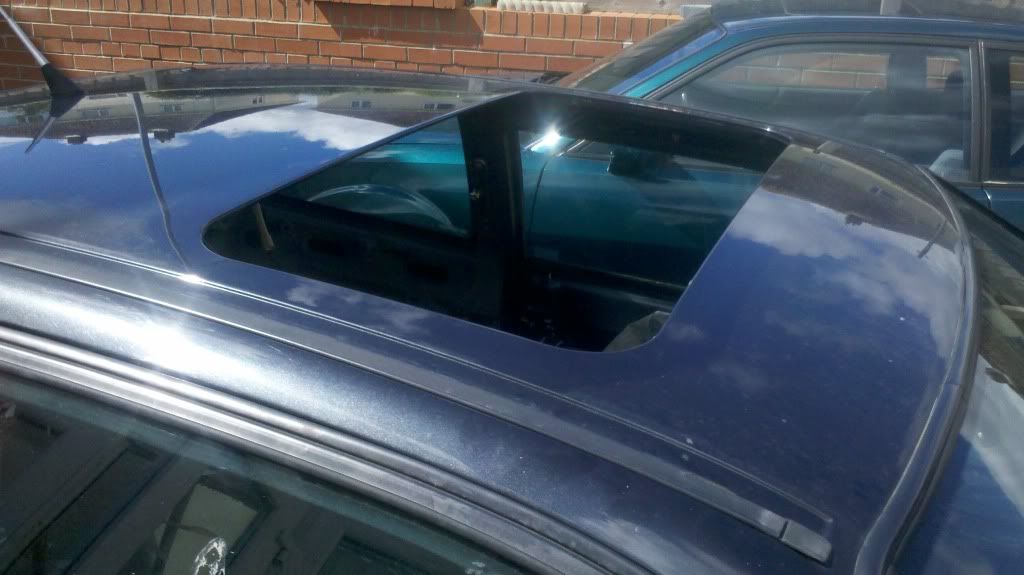

New sunroof mechanism:

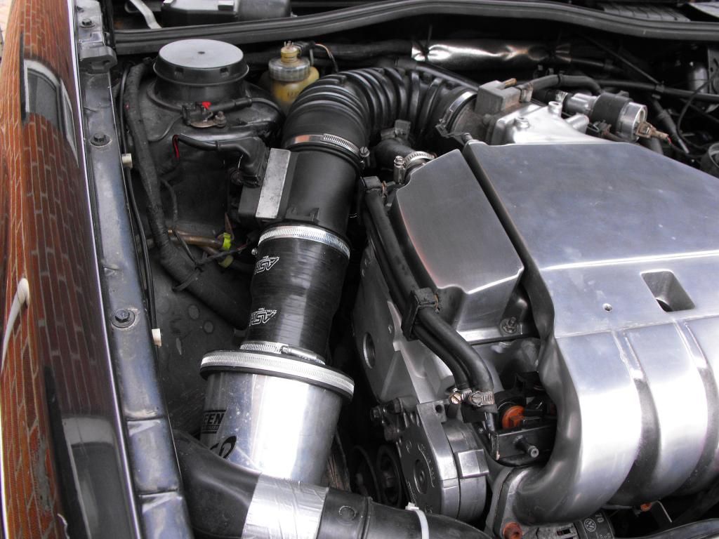

Ive still been busy as always, but mainly sorting out the tunes:

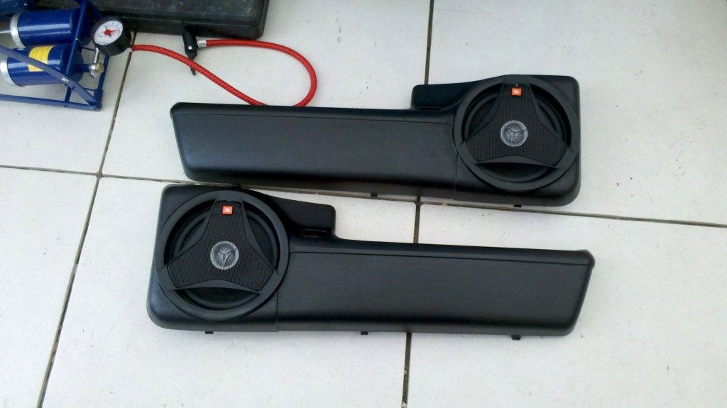

Made some new seaker pods:

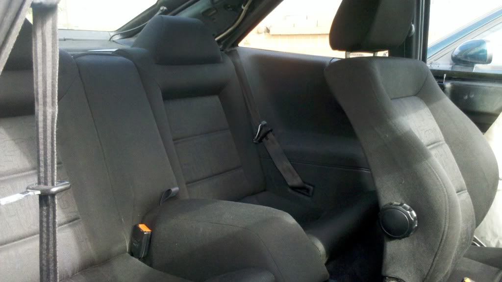

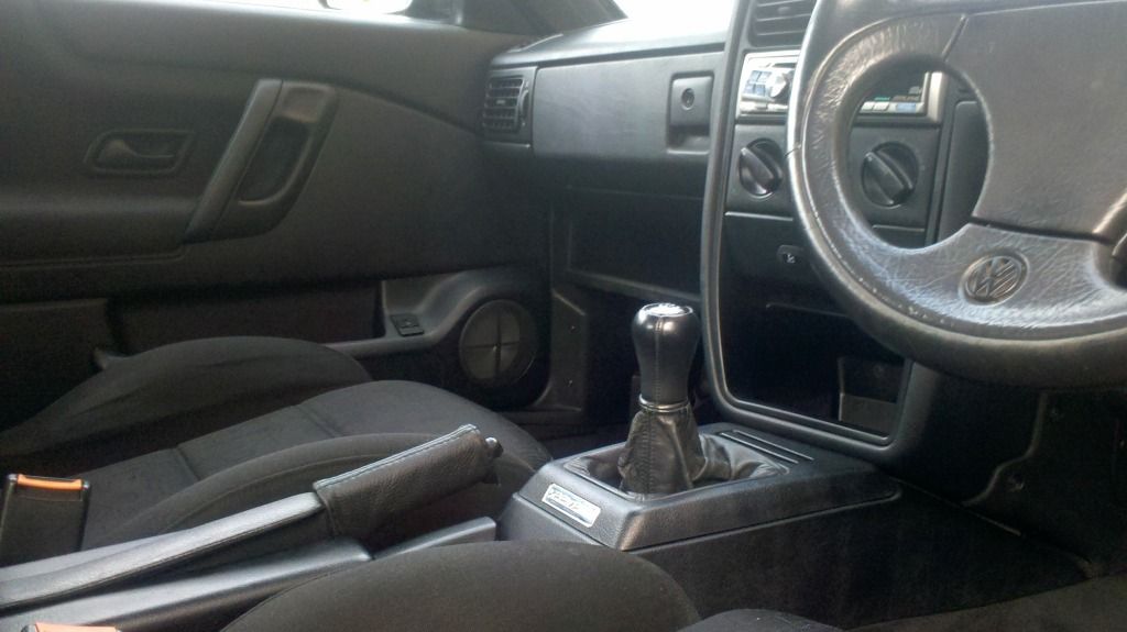

And refitted the rest of the interior, including new handbrake leather, gear knob, fuse board fixings and new A, B and C pillars:

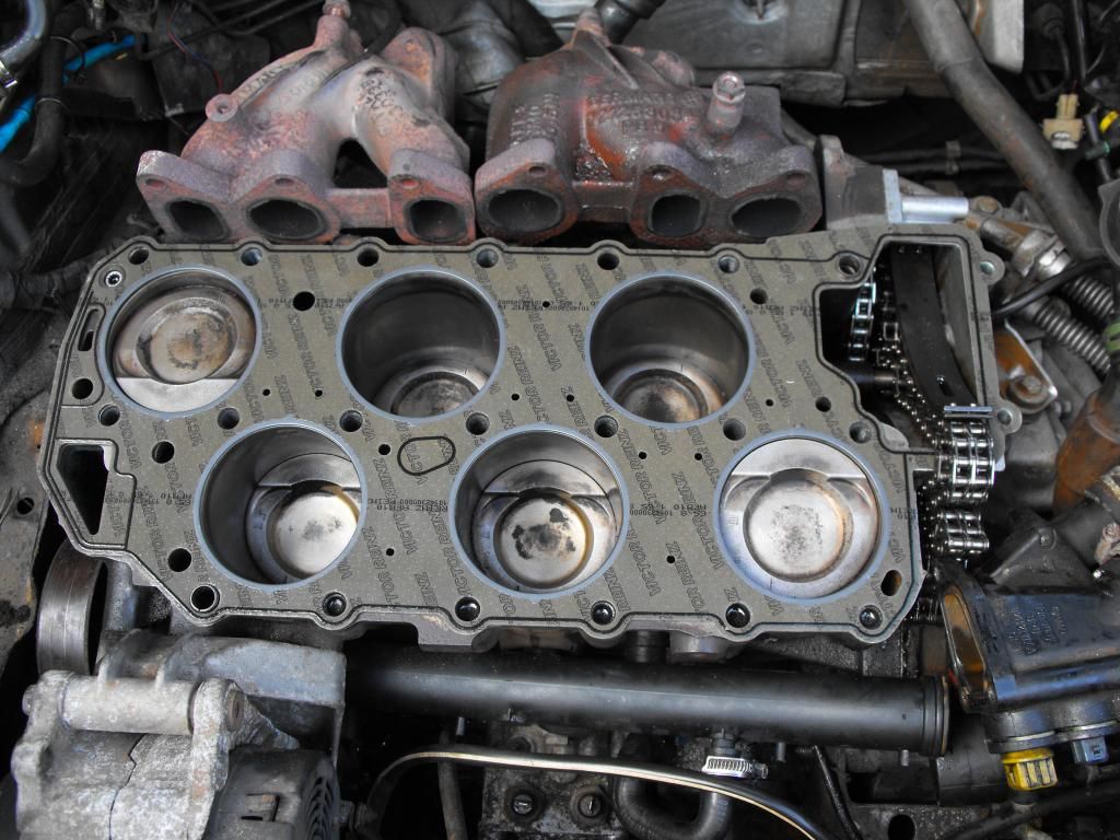

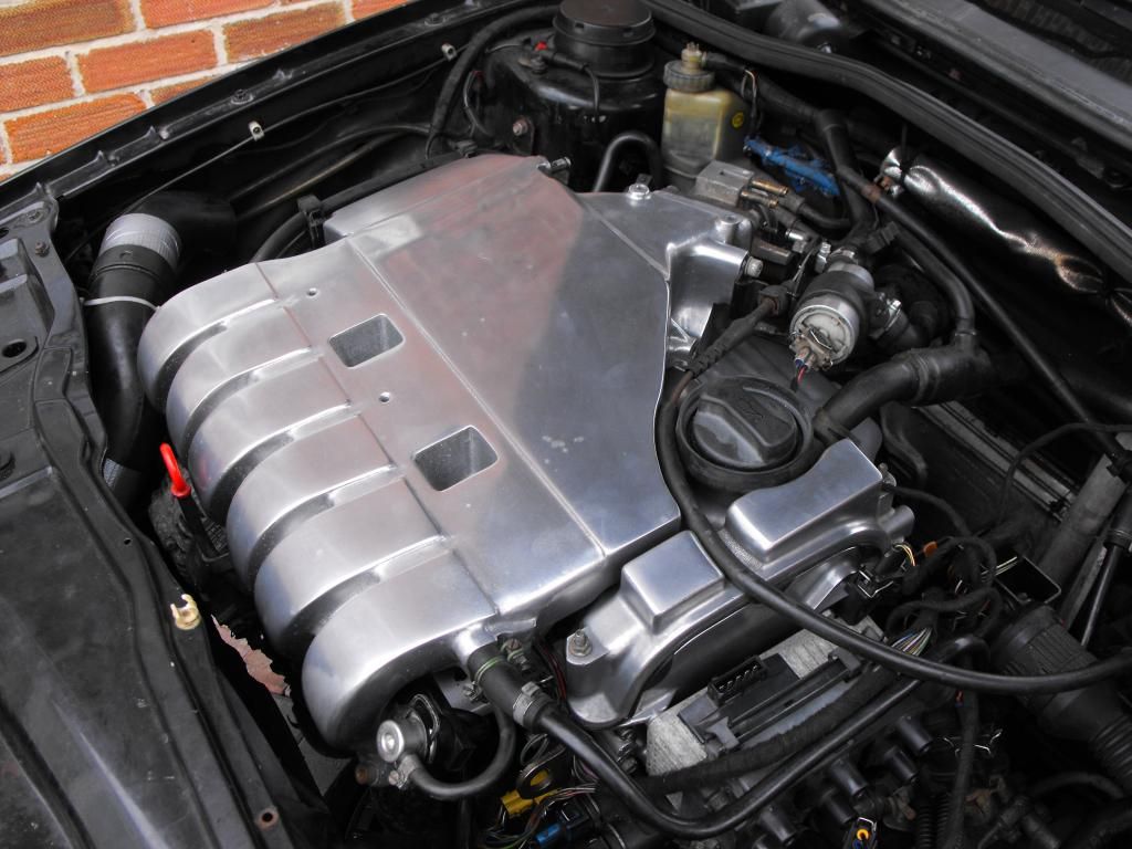

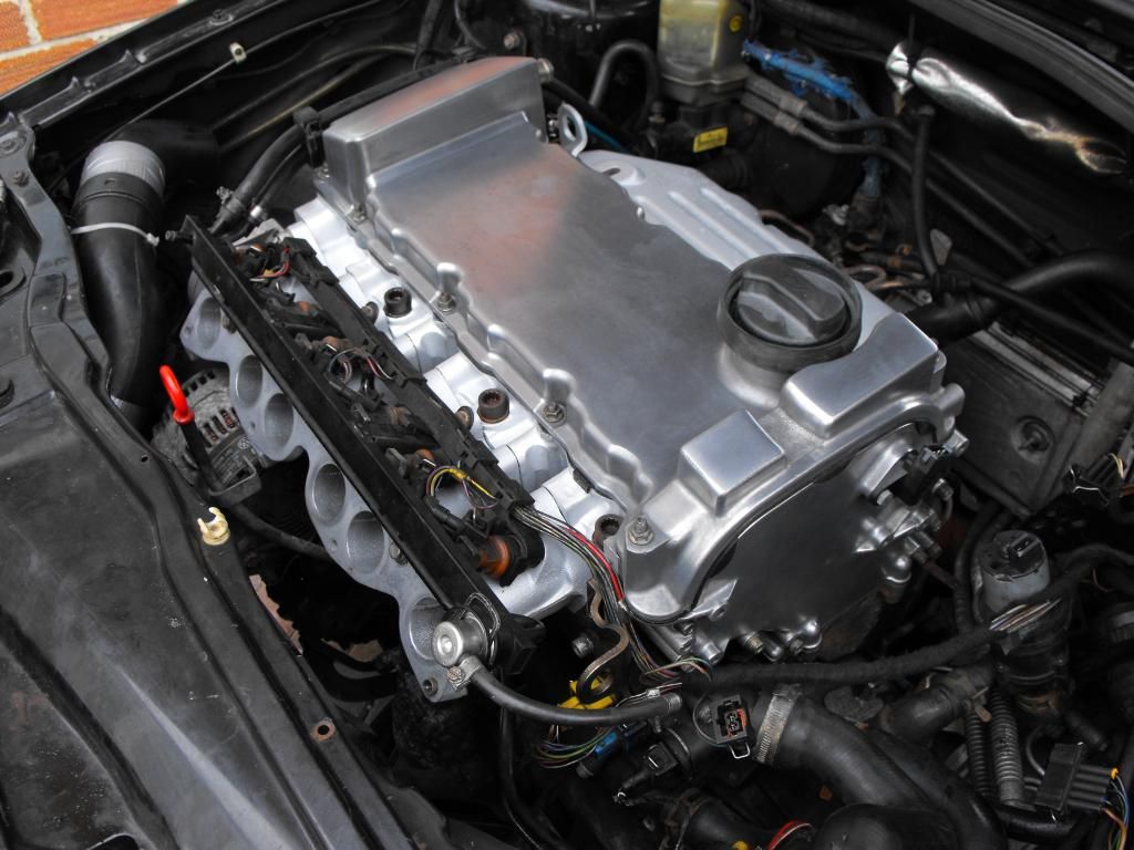

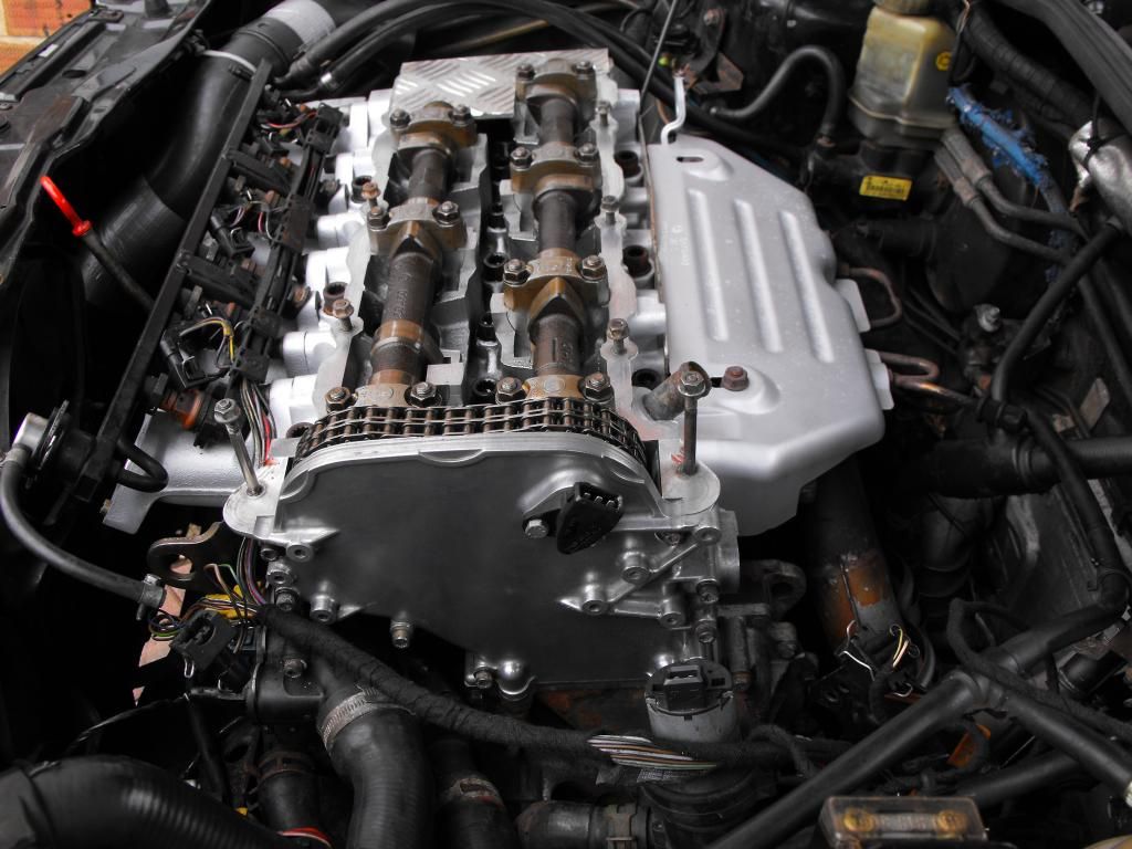

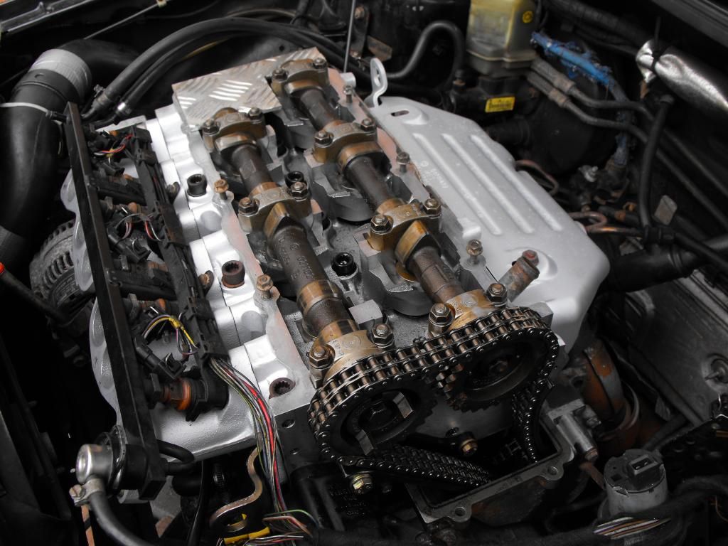

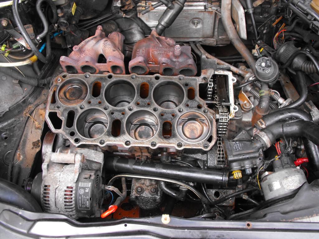

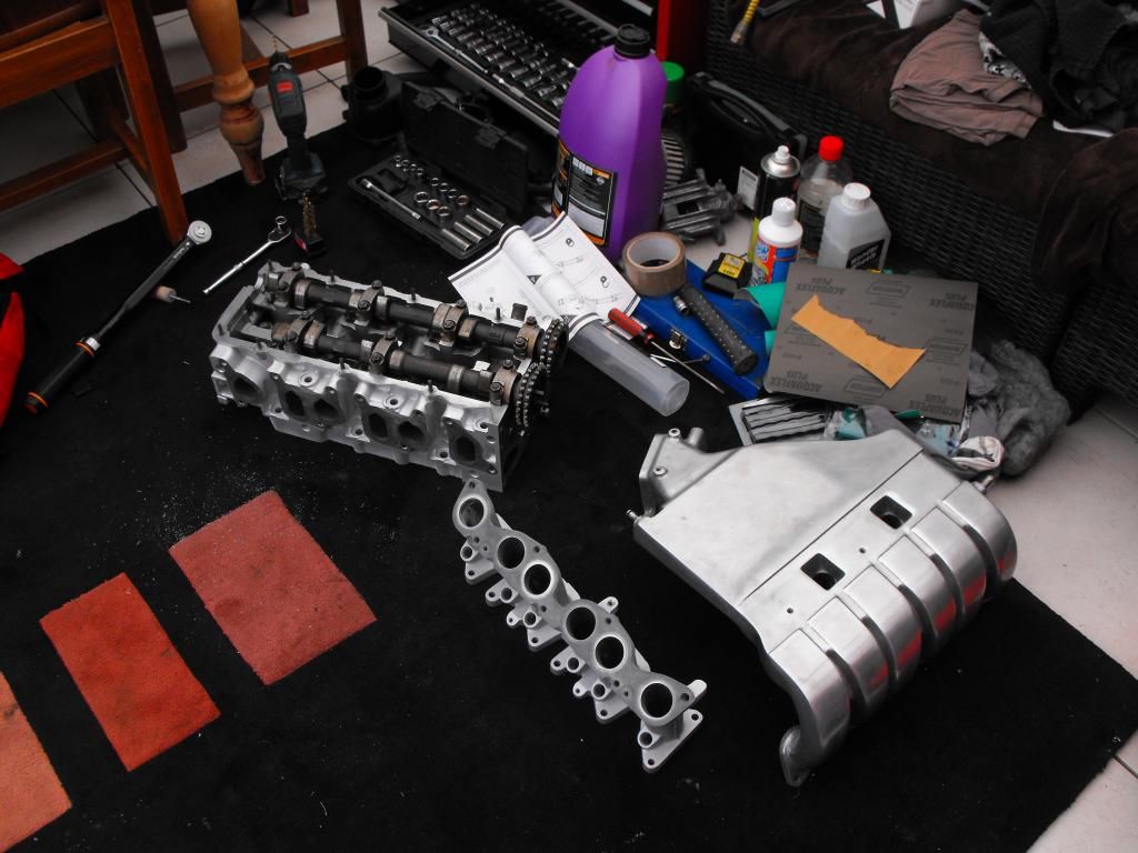

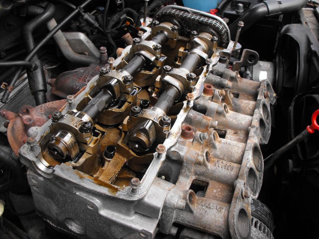

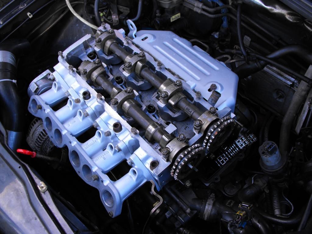

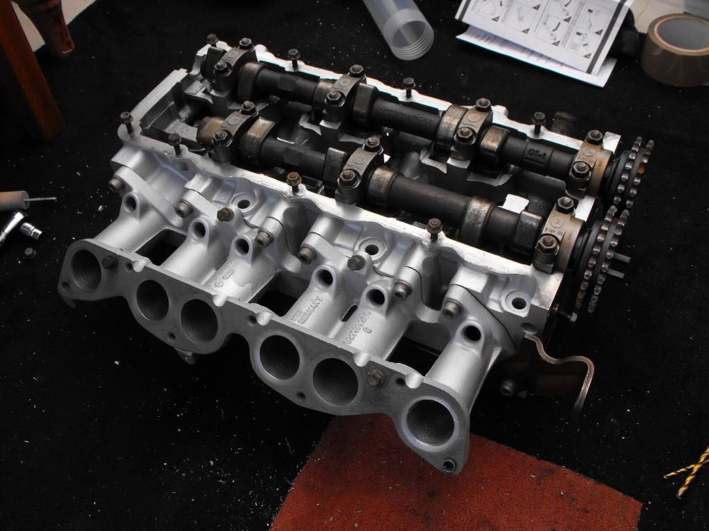

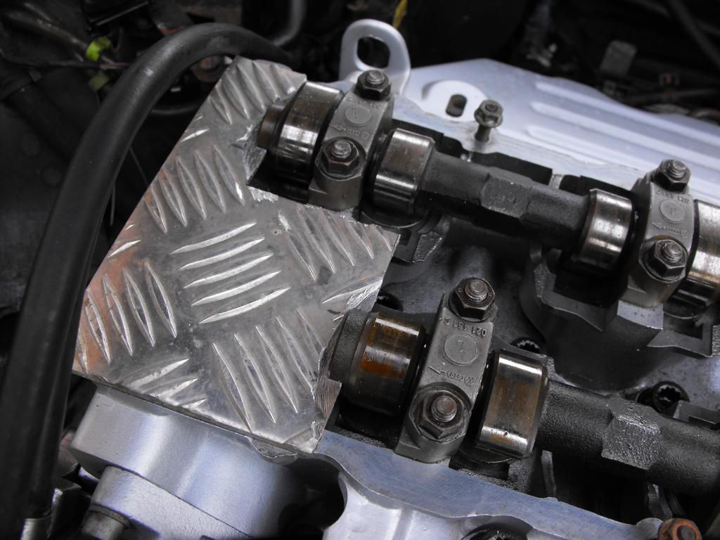

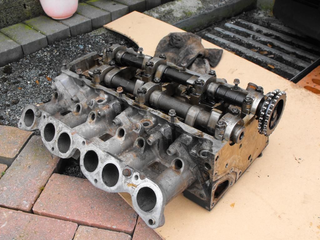

I decided to do a head rebuild as recently the Corrado had been kicking out black smoke and burning loads of oil, i've never done a head rebuild or headgasket change before so this was a nice little challenge for me, and all the information I needed for the build was sourced from the forum and google, the rebuild took me a weekend to complete:
New head gasket:
Old cylinder head:
New cylinder head etc:
new head on and torqued up:
homemade cam tool:
timing complete:

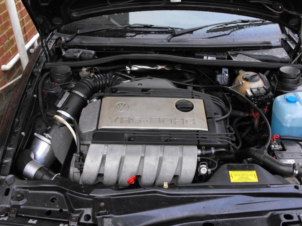

put it all back together now:
I finished connecting up the leads and fuel lines, when flushed the coolant system and refilled it with coolant antifreeze, and then dropped the oil and changed the filter.
The oil was well overdue a change!
Id turned the engine over by hand before I put the rocker cover and upper manifold back on, just to check that I had done the timing correctly and everything lined up just as it should.
So being confident that all was well I turned the key and the engine fired straight back into life, it was abit noisey for the first minute or so until the oil pressure built up, but as soon as id checked the coolant and oil was not leaking in anyway I took it for a drive. I cant believe the difference in the performance. Its much more responsive, smoother and quicker to drive.
Now ive just got to tidy the rest of the engine bay up and retape the wiring loom, hopefully when the weather warms up abit!

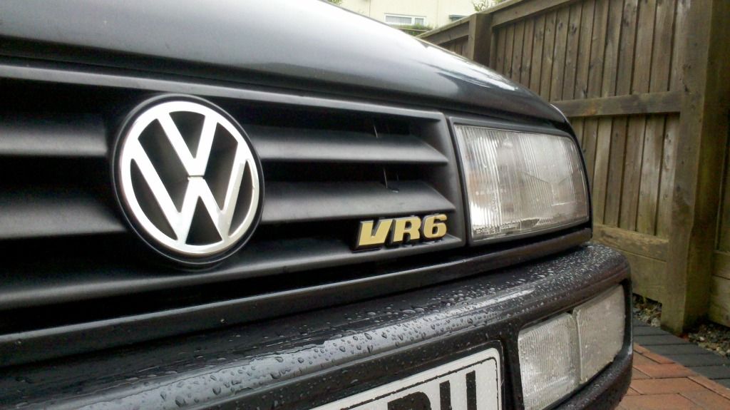

Gold VR badge:
You've got some skills, just read your thread. Particularly like the membrane sheeting on the doors.

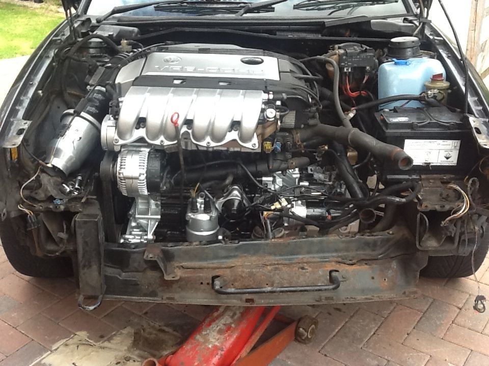

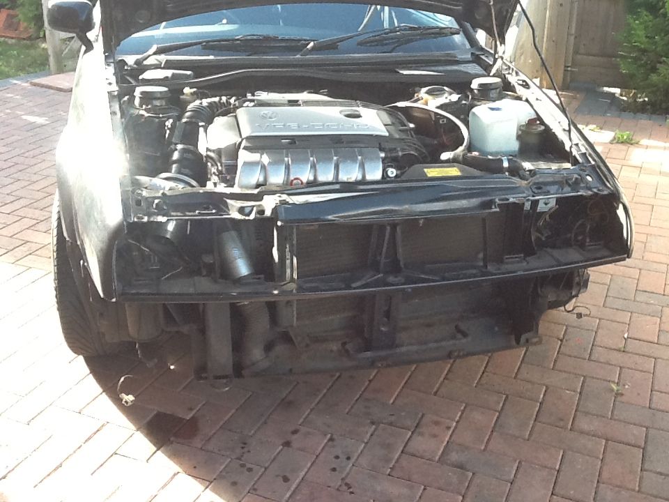

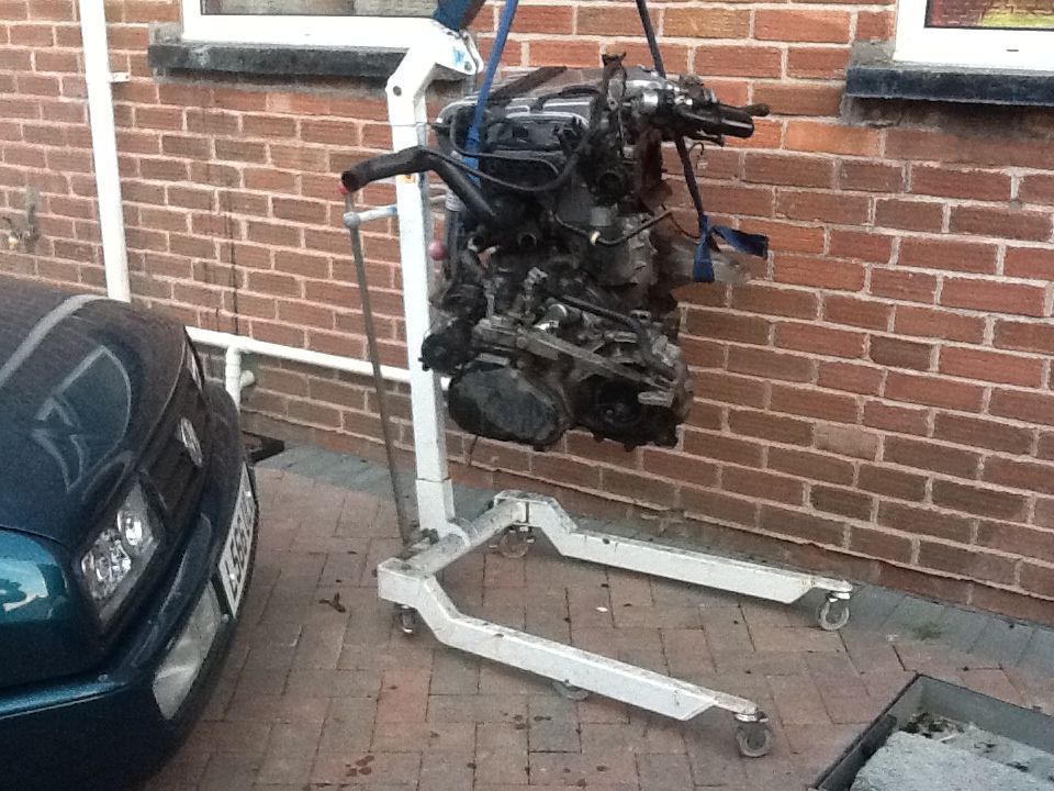

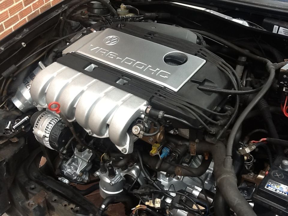

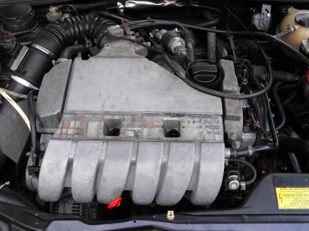

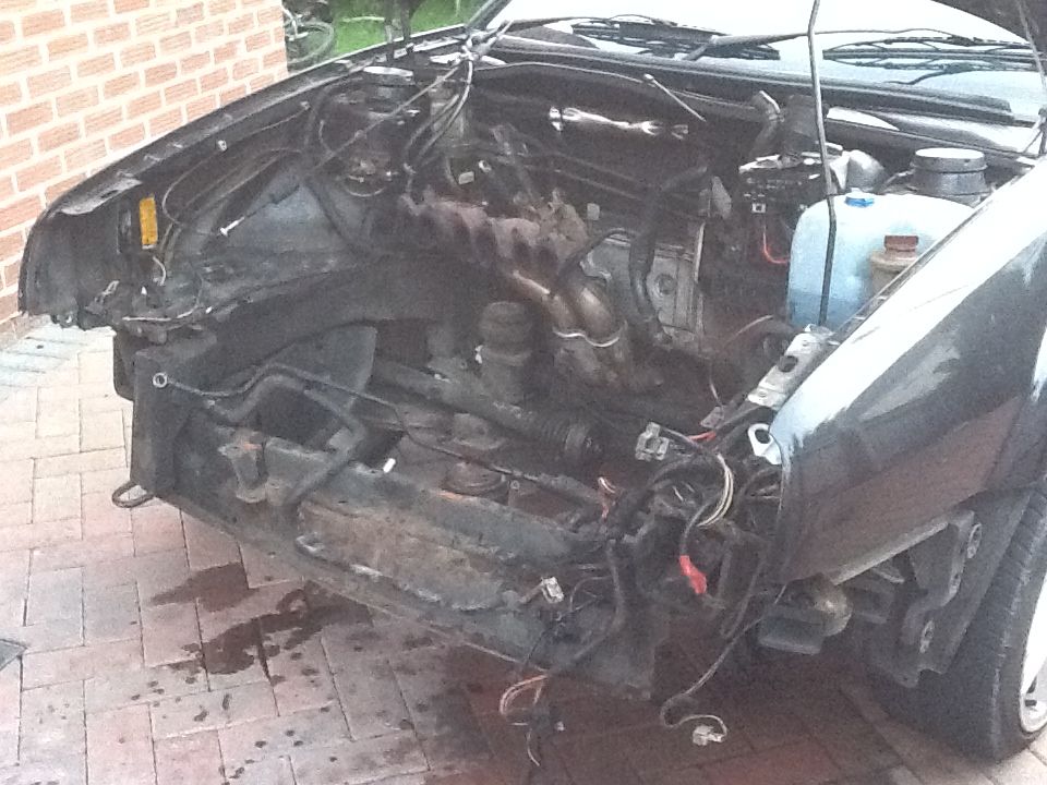

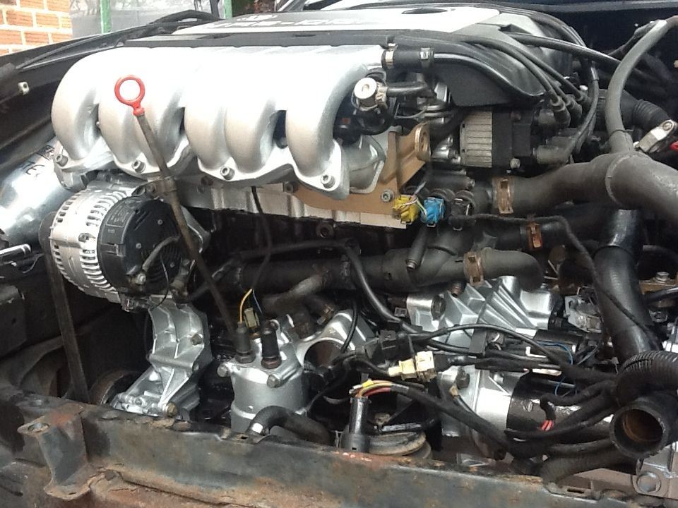

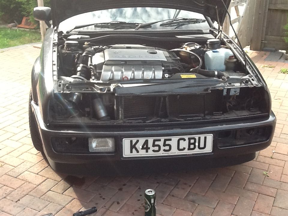

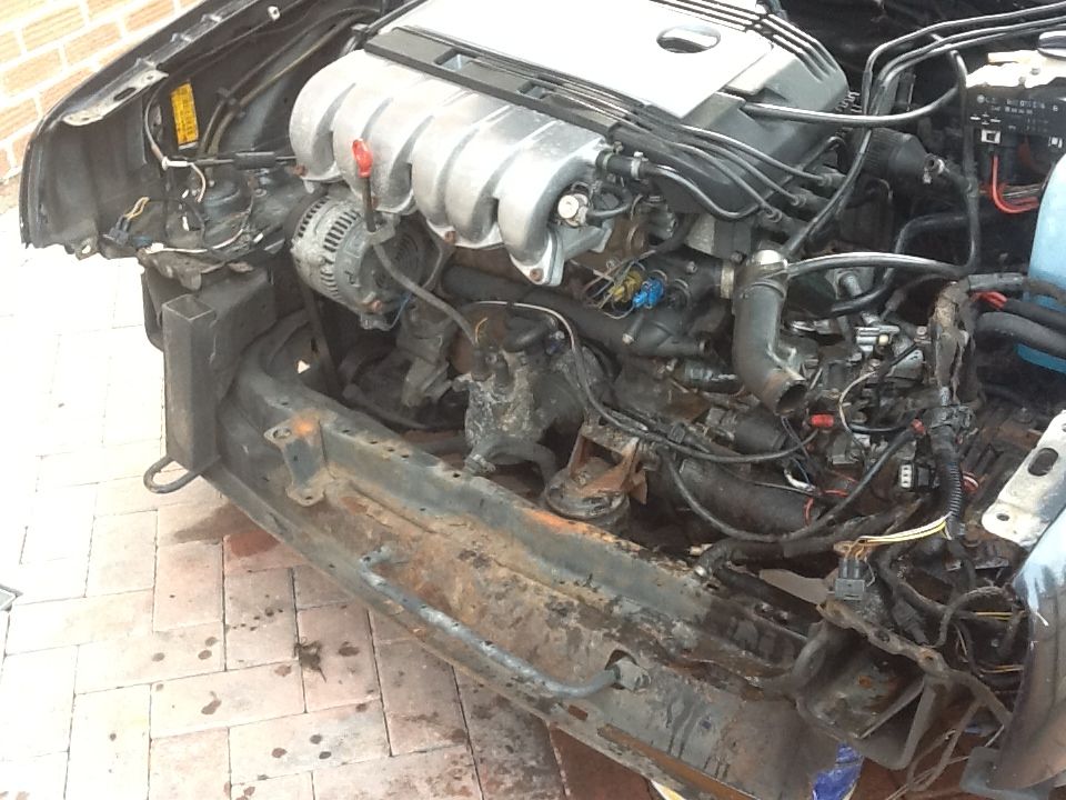

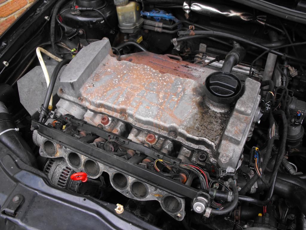

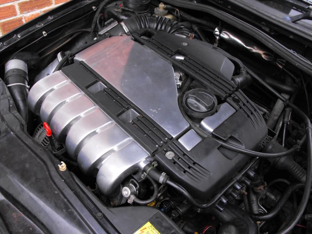

Ended up swapping the engine over for one off a Passat VR6 that I got for a bargain. Even though I replaced the cylinder head the car was still smoking, so I dropped the 2.8 in over a weekend and will rebuild the 2.9 over the winter months.
Strip down:
New engine:
I removed the engine after work on Friday, and had the new engine up and running by Sunday. The new engine feels a lot tighter and thankfully doesn't smoke now! I fitted the 2.9 upper manifold and throttle body and can honestly say that I can't notice any real difference in performance to the 2.9.
