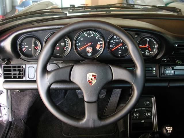

TheVims79 10 Posted April 28, 2012 bristolbaron said: keep your pants on!! Do you mean this style? [ATTACH=CONFIG]60849[/ATTACH] i've seen them in mk1 & 2 golfs so spline size should be the same or you may need an adaptor bought from vw for a few quid. personally, i think it would look terrible in a rado as they're massive. in a retro styled mk1 they look ok as its period to have a big wheel. give it a go, they're available cheap and sell it on E38 if you cant get it to work. Thanks man for the help but no that is not the wheel because your right that wheel is terribly ugly Lol! The Steering wheel is called a Porsche 930S Steering wheel they made them back in 1988 to 1989. I think they would fit in a V-Dub golf too your right. Believe me if i had the wheel i would have tried it on the Steering Column to see if it would fit but i don't yet because the wheel cost about $285.00 there not cheap. Here check out this picture this is the exact Porsche 930S steering wheel that im talking about. Personally i love this wheel and i think it looks awesome! Let me know your thoughts Thanks man :cheers: ---------- Post added at 8:26 PM ---------- Previous post was at 8:22 PM ---------- Stonejag said: Depending on year, Mk1 and Mk2 Golfs may need the smaller sized spline; VW changed the type in about 1989. Fret not, all Corrados use a small splined steering column, with an adapter ring that turns it into the large size :) Simply remove the adapter and off you go - they're very tight so you'll need some WD40 and a gear puller, but they do come off. Alternatively, cut it off and buy a new one from VW if you go back to an original wheel, it's 191 419 514 and should be under a tenner. Since I've lovely (and I had a steering column to hand!), here's a picture: Stone Thanks Mate but at this point i dont even own the Car yet im actually planning out What Mods ill be doing to the car so i twill look nice and sweet by the time that its here hopefully ill have the Car by this Summer time that's my Goal. Im getting her Ready for the New Season so she will be nice and happy when she see all the goodies that i got for her lol! ---------- Post added at 8:28 PM ---------- Previous post was at 8:26 PM ---------- anne t said: do you not need a boss kit for this wheel,in which case try finding out if one is made for it ,if so it should fit "i think" Anne:scratch: The folks here basically say that it should fit right on the spline shaft is basically the same Quote Share this post Link to post Share on other sites
anne t 10 Posted April 28, 2012 wouldn,t say no tothis wheel dude,this is the wheel i seen when i googled it:thumbleft: Quote Share this post Link to post Share on other sites
