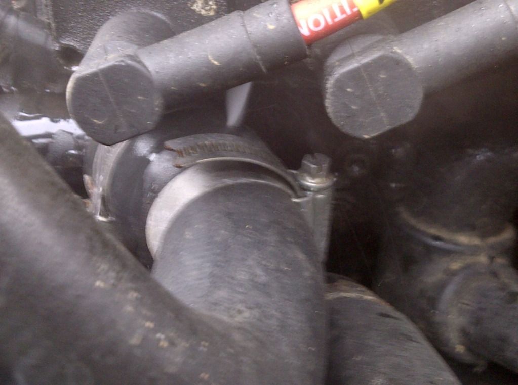

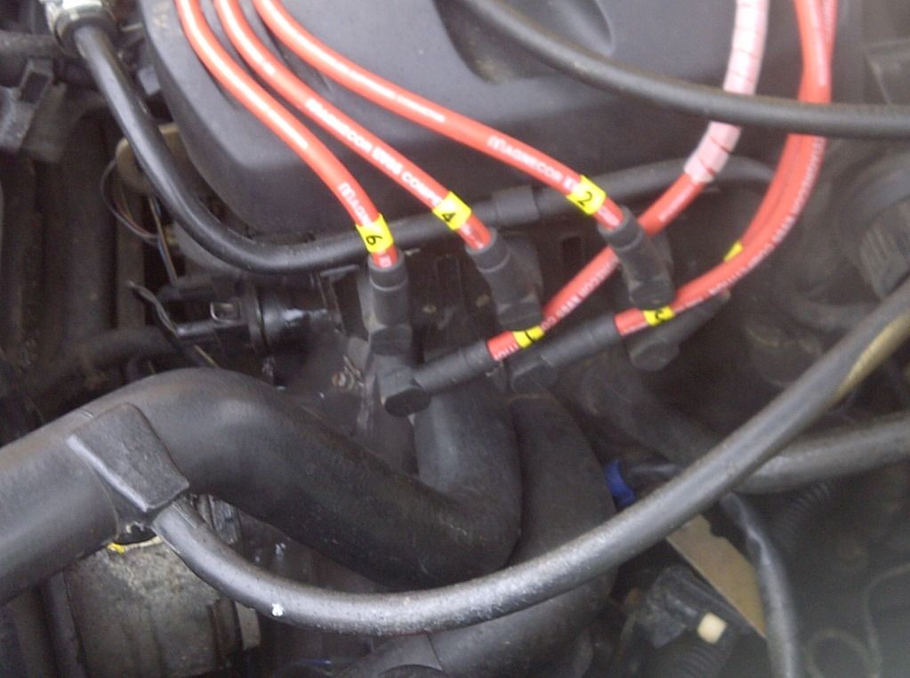

had a break through today. literaly. the top coolant hose has a small split in it and is shooting coolant out right at the coilpack.
so nows the time to get a hose kit. what colour would you say is best to go for?
---------- Post added at 5:19 PM ---------- Previous post was at 5:18 PM ----------
looks like somebody has been there before by the look of the random jubilee clip in the middle of the hose
you could be lucky then worth changing it,i thought mine had hose probs but it still turned out to be the head.the pressure was causeing mine to burst
