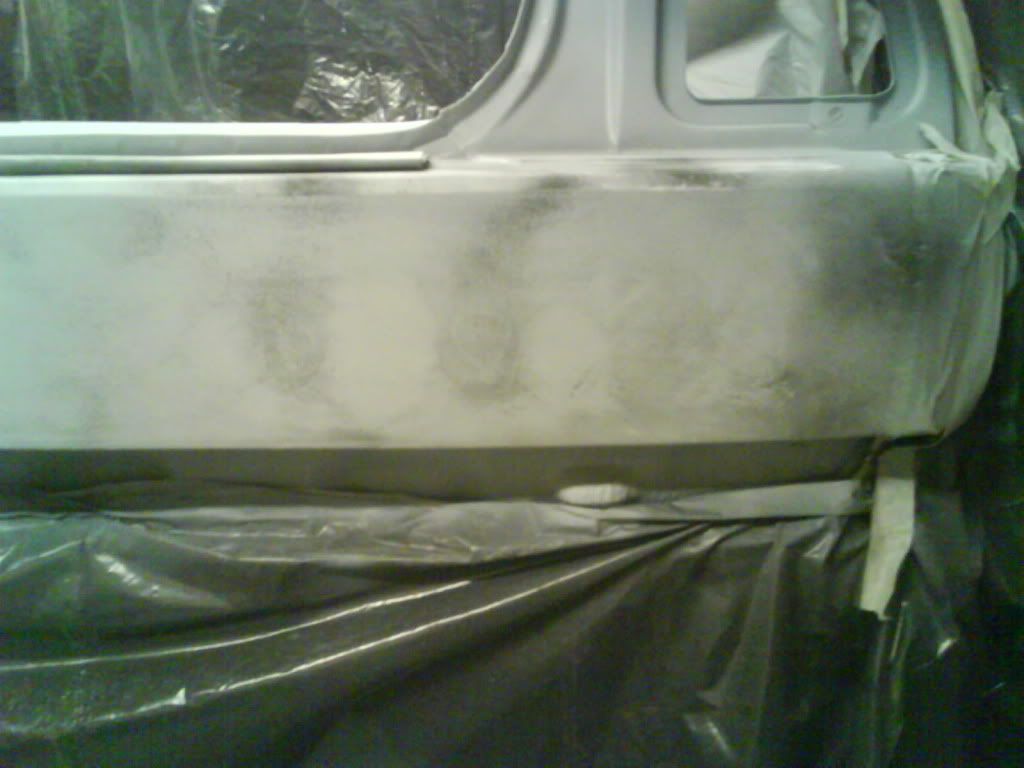

VW_OwneR_85 2 Posted July 21, 2012 Its is possible to blend out on a lot of areas on the Corrado, just need to know how ; ) We do a lots of Aston's and Jags at work and quite often blend on the pillar's if doing a rear quater or roof, we use a fade out blender, a bit like over reduced clear coat, Fade the last coat of clear out before you reach the soft edge of masking, it will be dry at the edges but lightly misting the fade out blender over the dry area will melt the old and new clear together. It will leave a small slightly dry dull edge when you remove the masking but this will polish up nicely with a bit of 2000 and compound to leave an invisible blend with no line or dry areas thanks, i recently did this on my audi a3 that had severe arch damage but i didnt want to re clear the whole panel i just wanted my repair area kept beneath the rear quarter trim peice so i blended the clear out i didnt use fade out thinners though but i get the idea behind, i wet sanded the blend out after and then buffed it back to gloss and its prety good, but the colour of the car is audi maya yellow LY1U dont know if thats a hard colour to match ? but looks like i should of faded out the colour further out into the rear quarter as now you can see its slightly darker then the rest, i only faded it out 3" or so , Gutted :( but my filler work turned out good, so in a few weeks i might just scotch the whole rear quarter and blend it out properly , its not realy noticable against the door which is good, Quote Share this post Link to post Share on other sites
VAG-hag 0 Posted July 22, 2012 How did it go fay? Quote Share this post Link to post Share on other sites
Emkayvr6 0 Posted July 23, 2012 thanks, i recently did this on my audi a3 that had severe arch damage but i didnt want to re clear the whole panel i just wanted my repair area kept beneath the rear quarter trim peice so i blended the clear out i didnt use fade out thinners though but i get the idea behind, i wet sanded the blend out after and then buffed it back to gloss and its prety good, but the colour of the car is audi maya yellow LY1U dont know if thats a hard colour to match ? but looks like i should of faded out the colour further out into the rear quarter as now you can see its slightly darker then the rest, i only faded it out 3" or so , Gutted :( but my filler work turned out good, so in a few weeks i might just scotch the whole rear quarter and blend it out properly , its not realy noticable against the door which is good, yeah I'd say bring the colour blend out a little further and clear the quater, blend the clear out on the rear pillar as this keeps it small and try the fade out blender, just get it in an aerosol, its not worth the hassle of cleaning guns out just to spray a little mist over the blend. By clearing the whole panel it will give your room to flick the last coat of base from the edge of the arch into the panel rather than follow the arch round. Dont spray the base too wet, although this tends to effect metallics more than solids, but just wet enough so its not dry if that makes sense, it doesnt need to be full wet like the clear, this also allows it to flash off quicker and reduces the chances of solvent pop. with metallics the wetness can lighten/darken the colour more so than with solids ( i'm guessing your using solvents, just as its easier to work with when u haven't got a professional set up) i might have just told u what you already know but it might also help someone that doesn't, anyway just ask if you got and questions/problems Quote Share this post Link to post Share on other sites
VW_OwneR_85 2 Posted July 23, 2012 thats cool, yea kinda knew some of it, like putting the blend in the clear coat in the smallest place possible so the blend line isnt big, yea its prospray solvent base with u pol system20 2k clear, i was watching a video about blending out and the guy {yank} uses a clear basecoat to reduce the basecoat , i guess its to thin the base out {colour wise not in viscosity} do we have that in the uk? the colour match is mixed to code and is a good enough match that i cant tell the difference looking at the door and the qaurter, you probably could though. i'll probably have another go in a couple of weeks but when i do i'll get some pics up ,atleast its alot better then what it was.. Quote Share this post Link to post Share on other sites
