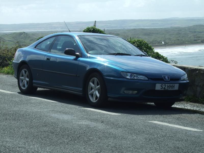

an old shot of it, on the way to book our wedding in devon
the lines of it are very crisp and clean and i dont think it has aged that bad considering the other cars on the road at the time and how dated they now look
Wont lie the 406 has caught my eye on the roads before and still looks somewhat modern despite a lot of new cars looking like spaceships with all there fussy lines.
Same here. I think the 406 is a very pretty car. But I don't agree the Corrado is ugly. In fact the odd thing about earlier VW's is that I generally don't like their styling when they are new but they tend to age well and look better when they are old.
Looks a great 406 though :)
Yeh not a bad looking yoke at all, nice spot as well overlooking Staunton sands :)
