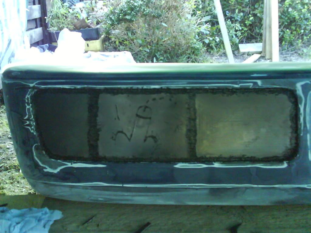

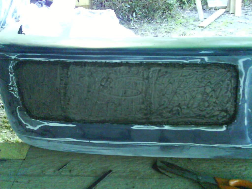

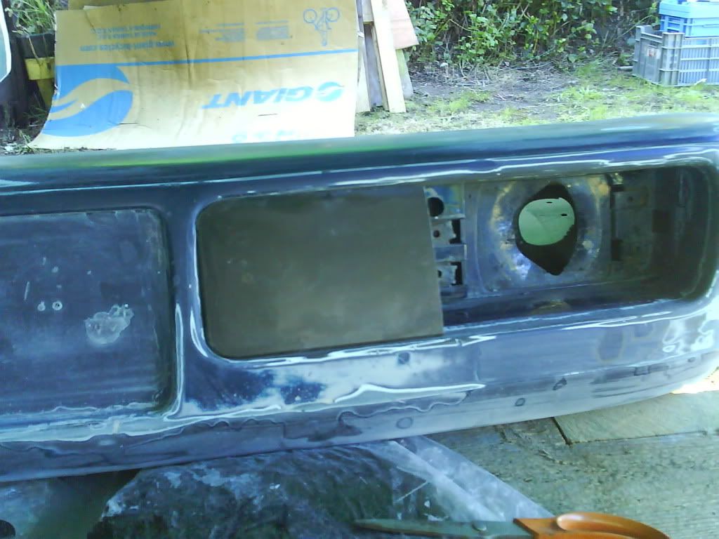

i smoothed out my fogs and indicators, its prety easy to do DIY , you just need to clean off the paint and plastic weld new plastic inplace with a soldering iron,
you do it a few mm below the finished surface so filler can be used to get everything level,
make everything rough for better adhesion.
Agree with delfinis38 - If you're going to do it, I'd do it on a spare bumper.
Keep your electrics / excess wiring clean and tidy too - You want to be able to bring it back to stock if required.
yer tbh im not to keen on smoothing the entire thing (lights 'n' all), i didnt really make it clear but i ment just the number plate recess, i quite light the fog and indicator set-up and my mate did the entire thing and imo now it all looks a bit plain. so yer, just the number plate recess really, and YES! getting a spare is definitely a good idea.. :) and i only plan to do the filling/plastic welding myself, then she is of to a body shop to have the entire front end re-sprayed.
