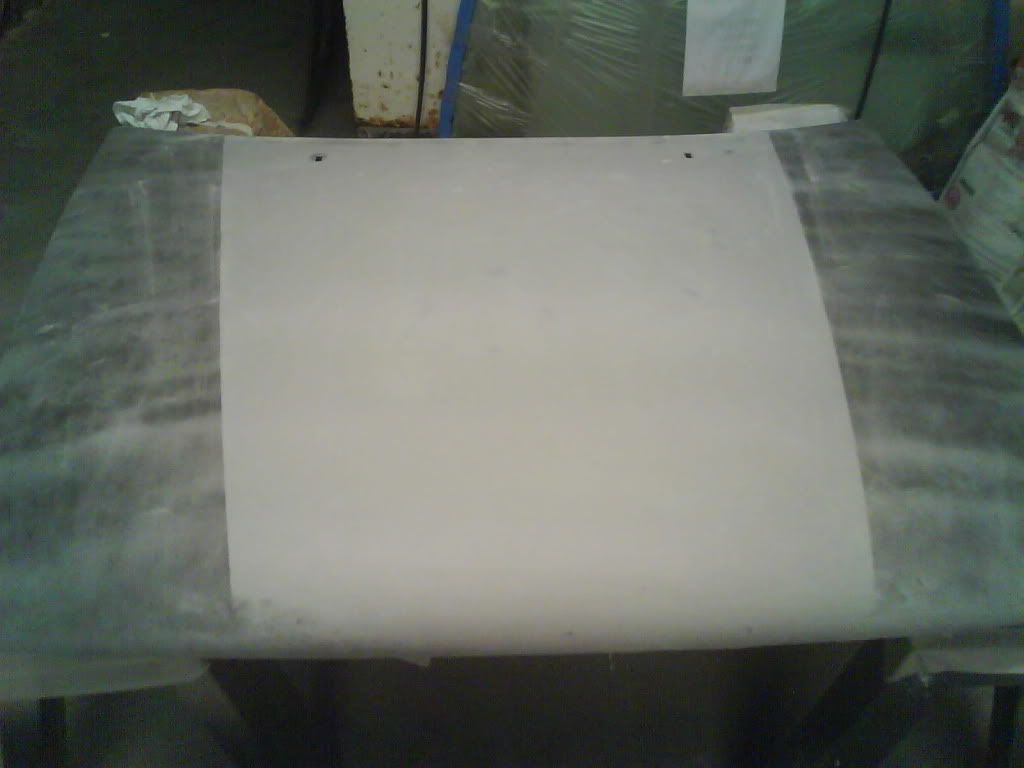

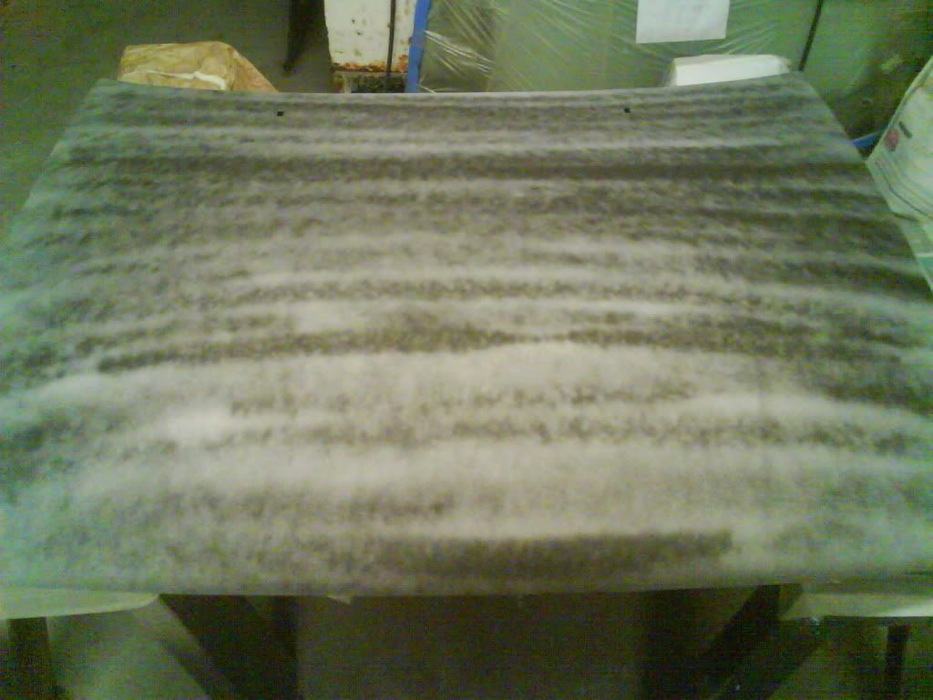

VW_OwneR_85 2 Posted September 3, 2012 when doing sanding to get your work straight , like filler's and sanding primer before colour use a guide coat, http://www.ebay.co.uk/itm/U-pol-S2004-Dry-Guide-Coat-Aerosol-450ml-UPOL-/110655893356?pt=UK_Body_Shop_Supplies_Paint&hash=item19c39aef6c you want no sanding sratchs harsher then 600 grit on your primer before colour, otherwise they will show through, heres an example of useing a guide coat, it reveals all the low spots which need to be worked out, bonnet primed and then lightly sprayed with a guide coat ready for sanding out imperfections like orange peel, halfway done you can see low spots around the left windscreen nozzle hole, your also need this stuff to keep your work clean http://www.ebay.co.uk/itm/5L-Can-Tetrosyl-Panel-Wipe-Pre-Paint-Wipe-Surface-Prep-/360484981272?pt=UK_Body_Shop_Supplies_Paint&hash=item53ee944a18 your want solvent basecoat mixed to your code, like this stuff http://www.ebay.co.uk/itm/1-2L-Solvent-Basecoat-Paint-BMW-317-ORIENT-BLUE-/300550651710?pt=UK_Body_Shop_Supplies_Paint&hash=item45fa36ff3e cellulose is old news and thats the same stuff thats in spray cans, iv heard waterbased isnt ideal for diy use, think its got something to do with needing a temperature controlled enviroment, also a moisture trap isnt enough to stop oil + water from passing through your gun, cant find the link but devilbliss make a filter which skrews straight on to the 1/4 male thread on the gun, deffo worth buying!!, theres so much more info but you just got to learn as you go , learn on a scrap panel first and try your best! another reason to use a 2k primer , it basicly insures all your hard prep work, all the prep work is from the primer and whats under the primer , basicly solvents cant attack 2k { 2k = 2 componant} so if you make any mistake applying your basecoat , like you get crazy runs or loads of dust falls into or like me i had contamination from oil from the compressor , you can just wipe the basecoat away with thinners even if its dry , so you can start again fresh from your preped primed surface :) Quote Share this post Link to post Share on other sites

sexybourbon 0 Posted September 3, 2012 Cheers owner85 thats some real good info there , the info on finding spots in the paint and how to rectify them is exactly what i need to learn and also i never knew that using a 2k primer was that benificial , ie that you can basicaly start over if you make a mistake without to much fuss I do remember visiting a welding forum a while back that had some good info about paint and body work but i cant remember the name of it for my life ---------- Post added at 9:17 PM ---------- Previous post was at 9:14 PM ---------- Would be looking for £100 delivered, but happy to throw in some mixing cups and paint strainers if it would help? Ian. Thanks for the offer ox but its a bit out of my range when i already have one sat in the garage , would be nice to have all new equipment but at the mo thats not gonna happen , cheers tho bud Quote Share this post Link to post Share on other sites
