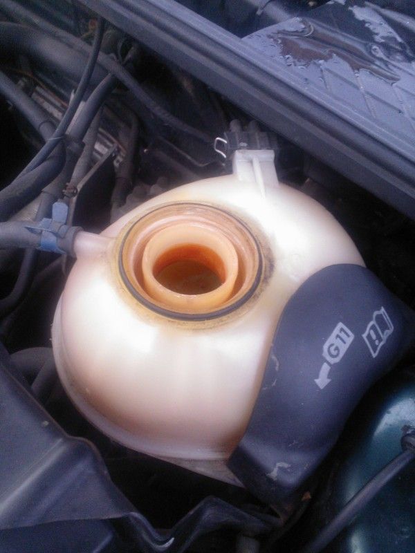

Looks like its been put there by someone previously mate. Cap has a seal further in than the thread iirc. It seals over the top of the hole on the tank, rather than the threaded part iirc
Guys, real quick one, is the seal supposed to stay on the tank instead of the cap like this on a VR6?
Cheers.
That seal is correct mate,mine is the same.
Blue caps are the updated version. The old black one were renowned for not venting, or venting too early. Worth upgrading to the blue if you dont already have that one as its a common cause of failure
Brill, mine came with the black cap. All my previous VWs have had an issue with the caps. Infact last week I had buy a replacement blue version for my Golf. Im jinxed!
