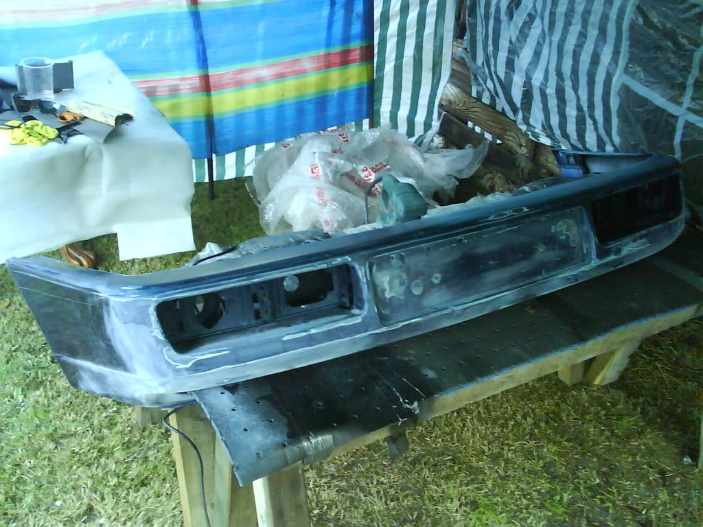

A better way to stick the plate recess would be to stick the filler piece in with LORD Fusor. I use it for bumper repair or modification and it hardens just like plastic and is dead easy to work with and can be filed, sanded, drilled, and even threaded.
realy like the colour of that corrado!, OP get a second hand bumper to work on { there cheap enough} and sand the paint off to bare plastic around the reccess and then plastic weld a filler peice {with soldering iron or what ever } in with plastic from another bumper or suitable plastic from some where a few mm below the surface and then key the plastic up good then skim with plastic filler { upol's SMC for example } for a flush finish, finishing up with a good finishing filler for small holes, could also use adhesives if you dont fancy plastic welding ,
its exactly the same thing as smoothing out the fogs n indicators
then fill and prep the rest of the bumper then prime>colour>clear
