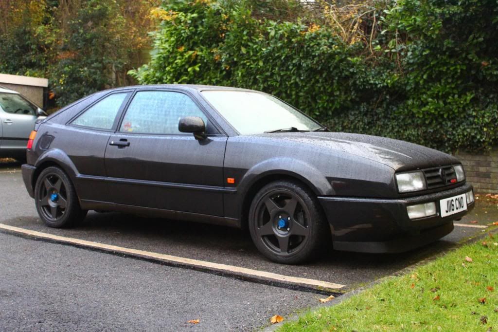

G60Luke 0 Posted December 7, 2012 Heres mine on 16" MO5's, ET35, on coilovers, mk4 rear calipers (no spacer), Brembo Calipers up front (small spacer) Quote Share this post Link to post Share on other sites
