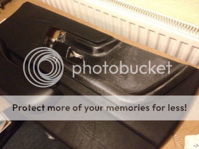

RadoVirgin 0 Posted December 13, 2012 I'm praying this works Quote Share this post Link to post Share on other sites
VW_OwneR_85 2 Posted December 14, 2012 looks funky although idd prefer leather in that area, iv thought about haven a bash at maken carbon stuff although the price of it is to much for me to gamble on,would love a carbon bonnet and maybe front wings,,, Quote Share this post Link to post Share on other sites
VAG-hag 0 Posted December 14, 2012 Go for it mate.... if you master the art u will sell loads of bonnets n wings on here Quote Share this post Link to post Share on other sites
RadoVirgin 0 Posted December 14, 2012 Yeah I wish I had the facilities to make bonnets and wings etc but it's just not possible on a budget. At the moment I'm just skinning parts with a single sheet of carbon fibre. I wanted to do the doorcards as my interior is all black leather apart from thee doorcards and I wasn't going to pay £200+ for a set of leather ones! Plus I don't think I've ever seen this done! Quote Share this post Link to post Share on other sites
captainredeye 0 Posted December 14, 2012 When you say skinning is this apply a carbon skin to the door card instead of say leather. or are you using one as a template to make a pure carbon doorcard. Does any one know of a company making carbon parts in the UK it seems like all I have seen is from the states with massive lumps of import tax bunged on top Quote Share this post Link to post Share on other sites
RadoVirgin 0 Posted December 14, 2012 Yes I am applying a layer of carbon fibre instead of putting leather. The main issue with making carbon fibre parts is the need for a mould and pressurised oven(autoclave) in order to produce parts without imperfections. It's a very expensive process to set up but one you have the tooling it's relatively easy. Quote Share this post Link to post Share on other sites
Jim 2 Posted December 14, 2012 Rather suits the door card actually.. good effort! Quote Share this post Link to post Share on other sites

VW_OwneR_85 2 Posted December 15, 2012 (edited) heres that guide to make a bonnet, doesnt look bad ,but you just need to gamble/invest in consumables and materials mould starter kit @ £80 http://www.easycomposites.co.uk/products/starter-kits/uni-mould-complete-mould-making-kit.aspx Edited December 15, 2012 by VW_OwneR_85 Quote Share this post Link to post Share on other sites
RadoVirgin 0 Posted December 16, 2012 VW_OwneR_85 said: heres that guide to make a bonnet, doesnt look bad ,but you just need to gamble/invest in consumables and materials mould starter kit @ £80 http://www.easycomposites.co.uk/products/starter-kits/uni-mould-complete-mould-making-kit.aspx I'm now seriously considering giving this a go! Quote Share this post Link to post Share on other sites
Craig 0 Posted December 16, 2012 Just watChed all of those you tube vids, impressive stuff but a lot of prep and hard work but awesome results :) Quote Share this post Link to post Share on other sites
VW_OwneR_85 2 Posted December 16, 2012 (edited) yea its all in the prep, so once that mould is made and aslong as its good it can be re used again so the second time around wont take so long, radovirgin go for it if you have the time and money, but how to videos all ways look easier then they are so i wouldnt expect it to be a breeze, if i was going to do it i think i would paint the parts body colour anyway, so i wonder if i would need to use the vacum pump + bag? i know that helps pull the resin around and get the air bubbles out but if im painting it all those imperfections can be filled, obviously the less air bubbles there are in the carbon fibre the stronger it is but im sure brushing the resin on the same way you do fibre glass would just be as strong it just wouldnt produce a show gloss finish on the finished side right? anyone know for sure if its ok to do that? edit: lol you brush the resin on anyway, and apparently you dont have to use a bag you just have to get as much air out as possible http://www.diycarbonfibre.co.uk/ tooling gel coat £15.00 http://www.ebay.co.uk/itm/GREEN-TOOLING-GELCOAT-1kg-KIT-Catalyst-Syringe-Included-FOR-FIBREGLASS-moulds-/251097355917?pt=UK_CarsParts_Vehicles_BoatEquipment_Accessories_SM&hash=item3a7691968d mould wax £12.00 http://www.ebay.co.uk/itm/600g-Yellow-Wax-Fillet-Block-for-Mould-Patterns-/220734703242?pt=UK_CarsParts_Vehicles_BoatEquipment_Accessories_SM&hash=item3364d0468a mould release agent = £10.00 http://www.ebay.co.uk/itm/500ml-L-R-PVA-Mould-Release-Parting-Agent-For-Fibreglass-Mouldings-/310351657022?pt=UK_CarsParts_Vehicles_BoatEquipment_Accessories_SM&hash=item484266783e fibre glass for mould x2 @ £6.25 = £12.50 http://www.ebay.co.uk/itm/Fibre-Glass-Mat-Matting-8-sq-ft-/300509821671?pt=UK_Body_Shop_Supplies_Paint&hash=item45f7c7fae7 resin+ hardner for mould & product = £30.00 http://www.ebay.co.uk/itm/5kg-GENERAL-PURPOSE-FIBREGLASS-RESIN-HARDNER-CATALYST-SYRINGE-KIT-MOULD-/251037798104?pt=UK_Crafts_Other_Crafts_EH&hash=item3a7304ced8 + a few extra bits n bobs like good quality brushs that dont leave brissels behind! so you should be able to make a decent wing sized mould for aroud £80.00 and then its just a case of adding the carbon which looks to be about another £70.00 for a wing, so your looking at gambleing around £150 to make a wing sized product, + your time, probably other things needed that iv missed aswell, or there complete mould makeing kit http://www.easycomposites.co.uk/products/starter-kits/uni-mould-complete-mould-making-kit.aspx Edited December 16, 2012 by VW_OwneR_85 Quote Share this post Link to post Share on other sites
RadoVirgin 0 Posted December 16, 2012 It's not too bad as I have access to the composite bay on the military base I work at which means we have all of the consumables including vacuum pumps and heat lamps. I'm going to have to give it a go after Easter! Quote Share this post Link to post Share on other sites
VW_OwneR_85 2 Posted December 16, 2012 RadoVirgin said: It's not too bad as I have access to the composite bay on the military base I work at which means we have all of the consumables including vacuum pumps and heat lamps. I'm going to have to give it a go after Easter! you bugger!!! yes you deffinatley have to give it ago now you said that! lol your be makeing bullet proof kevlar bonnets in no time Quote Share this post Link to post Share on other sites
