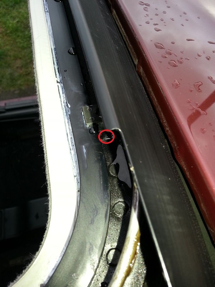

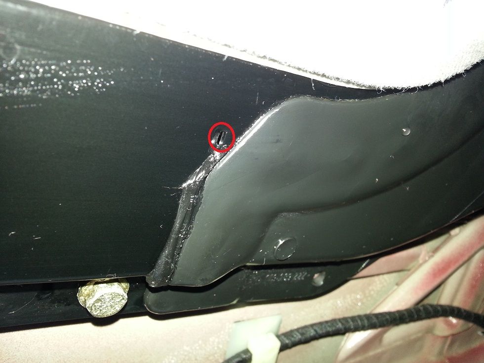

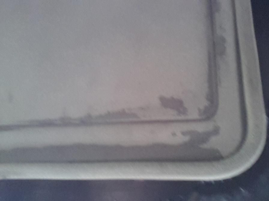

Critical_Mass 10 Posted December 15, 2012 (edited) Hi all, Need some help. My sunroof is leaking, its not the drains. they are fine. But somehow water is getting into the cabin. I've taken the roof lining off and poured water over the roof and i can see water getting in via a hole on either front corner. It looks like the holes are from factory. But when water gets into the channel - the channel the levers sit in that allows the wind deflector to go up and down as the sunroof is open/closed. Water will drain towards the front and go down the whole and onto the roof lining. Ive posted some picks circling the hole from below and above. However water is getting in at the rear of the sunroof too. But i cant see where its coming in at the rear of the sunroof. There's a seal that goes around the opening of the sunroof, can be seen when the sunroof is retracted into the roof. Could it be this letting water in? (see first pic) I cant see anything else it could be, im at a loss. The front and rear drains are not blocked and are connected. hole from above - hole from below - Water getting in at the rear - Water getting in at the front - Any help appreciated. Cheers Edited December 16, 2012 by Critical_Mass Quote Share this post Link to post Share on other sites

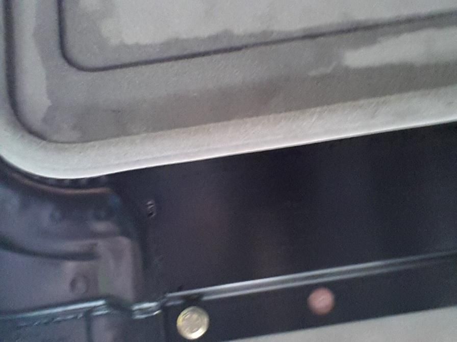

dragon green 6 Posted December 16, 2012 (edited) Mine looks different Or am I taking the wrong angle ? On further inspection,it looks like you have a cover strip missing ! A kind of flashing Edited December 16, 2012 by dragon green Quote Share this post Link to post Share on other sites
Critical_Mass 10 Posted December 16, 2012 (edited) Cheers Dragon, but at the wrong angle im afraid. Need to see under the wind deflector. If you take a look at my pic for reference. Need to see in the channel the metal rod for the wind deflector sits. Edited December 16, 2012 by Critical_Mass Quote Share this post Link to post Share on other sites
Critical_Mass 10 Posted December 16, 2012 Right taken another look and pushed the sunroof trim back into the roof. There is a gap between the roof and the sunroof seal. But the seal does butt up to the roof completely at one end. Its a small gap, but im guessing its not supposed to be there. I can also push the sunroof back a smidge which does close the gap but its still there a little. Im guessing the sunroof shouldnt be able to move like this. Also is there supposed to be some slight movement when pressing down on the sunroof, which does stop the water from getting in. Is this movement supposed to be there? Ive also sealed the holes at the front i was talking about. I may try a new seal and see if that helps. Quote Share this post Link to post Share on other sites

Critical_Mass 10 Posted December 20, 2012 Cheers Dragon. Im putting money on it being due to the slope of the drive. I've siliconed up those holes at the front and appear to have stopped leaking at the front - not sure if the holes are meant to be there or what though :-/ May have to test it on a flat surface. Bit odd if it is the slope. ---------- Post added at 12:15 PM ---------- Previous post was at 11:57 AM ---------- It did actually. But i assumed it was through those holes i mentioned. I think ive got a new seal coming in Jan. Assuming the supplier's computer is correct. Quote Share this post Link to post Share on other sites

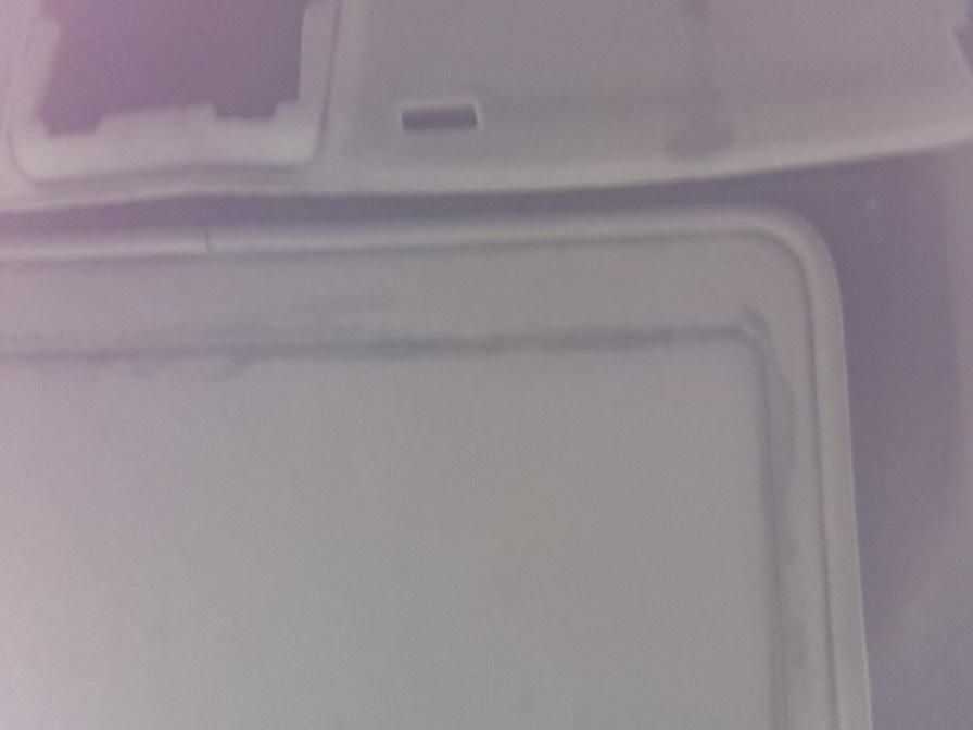

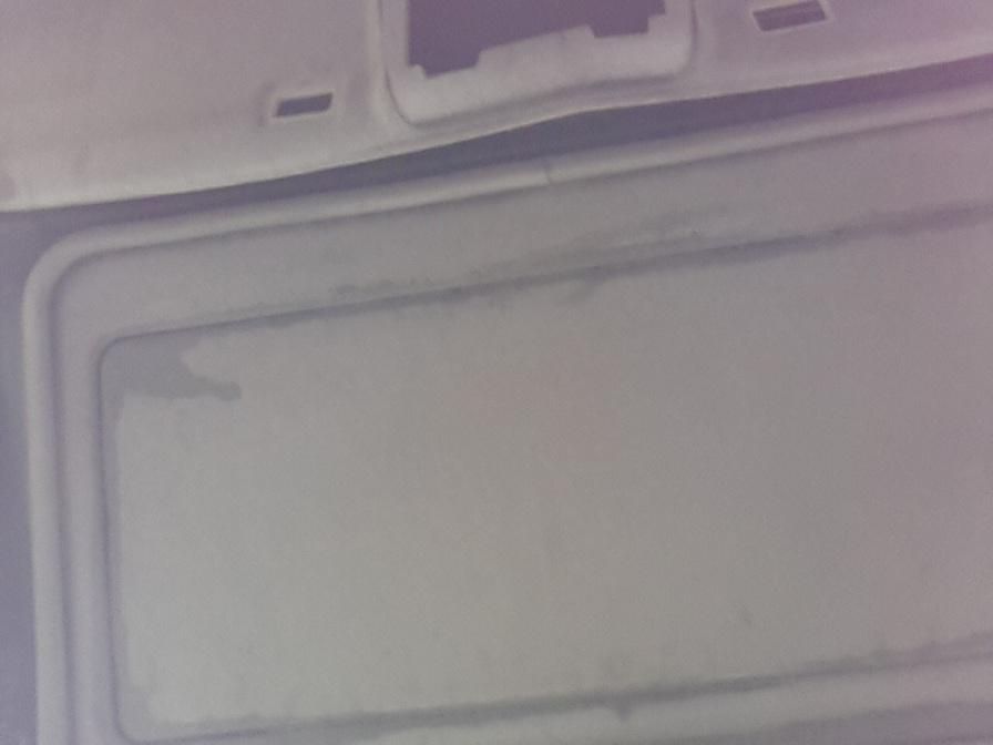

g0ldf1ng3r 17 Posted December 21, 2012 (edited) OK couple of pics taken There is no sign of any holes that i can tell on mine.....but Hmmmm on closer inspection of your 1st photo the small white bit by where you can see the + screw looks very much the same. Unfortunately im not in a position to take a pic of the underside but from what i could tell it didnt look like a hole that goes thru to the other side (if you get me) i hope they help m8 but maybe someone who is breaking a C or has their roof liner out might be able to take another pic of the underside Edited December 21, 2012 by g0ldf1ng3r Quote Share this post Link to post Share on other sites
Critical_Mass 10 Posted December 21, 2012 Perfect mate. do the hole is meant to be there. Must drain onto the inner trim and through the drain pipes. Quote Share this post Link to post Share on other sites
