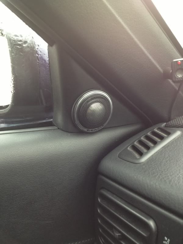

sexybourbon 0 Posted January 5, 2013 Where are you all fitting your speakers , iv put mine behing the doorcard , no wires to hide no on show crossovers making it look messy Iv fitted mine in the small triangles in the corner of the windows Quote Share this post Link to post Share on other sites
Portent 0 Posted January 6, 2013 Where are you all fitting your speakers , iv put mine behing the doorcard , no wires to hide no on show crossovers making it look messy Iv fitted mine in the small triangles in the corner of the windows The speakers are convertibles so I can have the tweeter either attached to the main speaker or separate. I also have some spare door triangles so I'll try them in both configurations and see which sounds best. Quote Share this post Link to post Share on other sites
sexybourbon 0 Posted January 6, 2013 I was told that fitting them higher up would give you a better sound as the tweeter sound isnt getting lost in the footwell in to your leg Either way mine fit behind the door card easily Quote Share this post Link to post Share on other sites

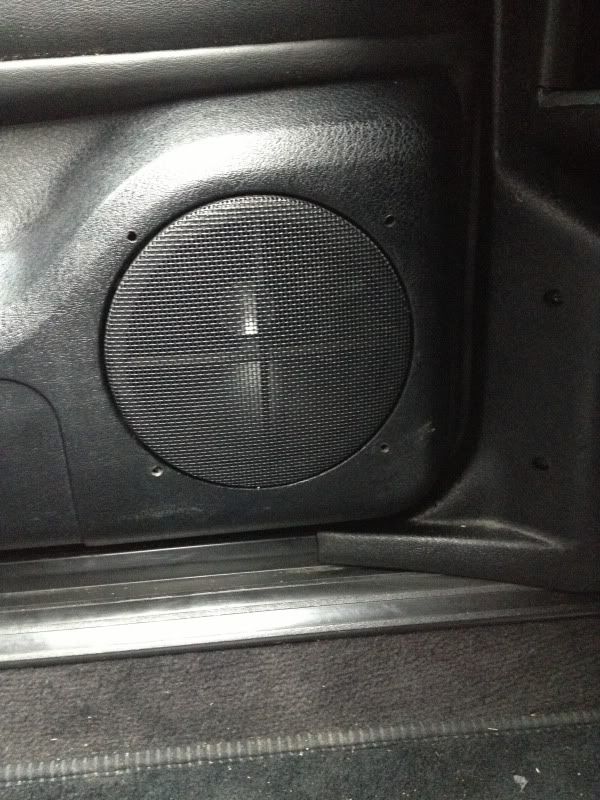

dil 0 Posted January 6, 2013 6.5" behind here Quote Share this post Link to post Share on other sites
Portent 0 Posted January 6, 2013 Nice. How did you get 6.5" behind the standard pods? Quote Share this post Link to post Share on other sites
dil 0 Posted January 6, 2013 Nice. How did you get 6.5" behind the standard pods? I bought some door pockets off eBay, scooped out all the unnecessary plastic , mounted the speaker to the door. I wish I had taken some pics , but I got inspiration from a post on vwvortex , will track it down and post up Quote Share this post Link to post Share on other sites
joebloggsVR69 0 Posted January 6, 2013 Hmm might have to try this out myself :) Any way of mounting them without having screw holes in the front? Quote Share this post Link to post Share on other sites
dil 0 Posted January 6, 2013 They were on the pockets already , presumably someone had screwed aftermarket grill to the front. I might fill them in one day. Quote Share this post Link to post Share on other sites
dil 0 Posted January 7, 2013 checkout the posts from "apaper" in this thread. http://forums.vwvortex.com/showthread.php?4853797 I cut MDF base to attach to the door( exactly as in the thread) then a speaker adaptor ring to bring the speaker forward as close to the door pocket, but not to close that when the cone moved it touched the pocket. you do have to cut some of the door car behind the pocket to get the adptor ring through. Quote Share this post Link to post Share on other sites
