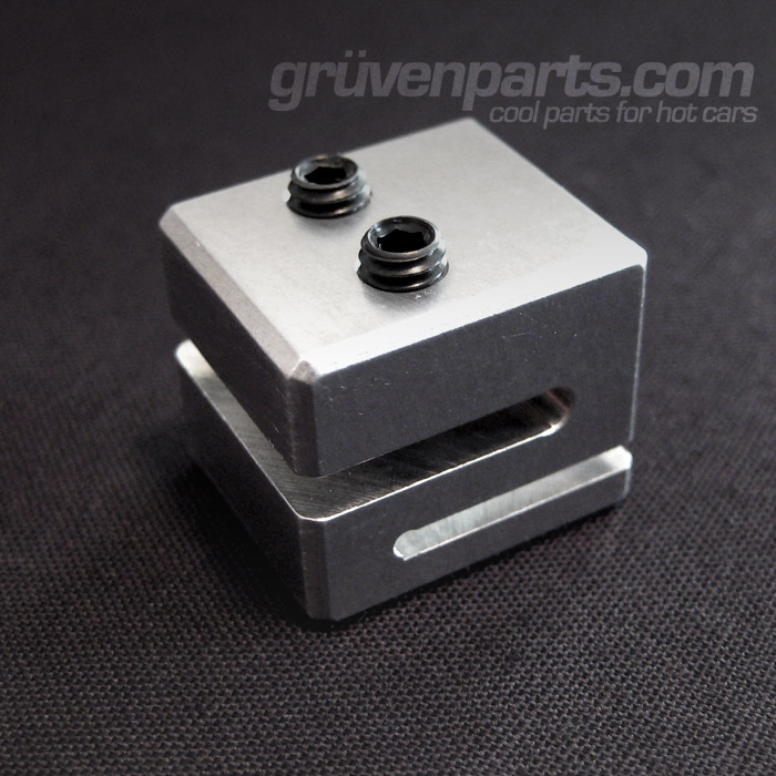

Bazmcc 0 Posted January 10, 2013 I have the engineer on standby with a CNC mill and lathe and we're going to have a go at coming up with a solution to the crappy excuse for a clip on the bonnet pull where the cable attaches to the bracket. This is the standard clip both normal and broken. The gruven one looks like it does the job but involves drilling holes and i'm not sure i'm convinced by the design. Gruven make this one: So I'm going to try to come up with a very basic and easy to fit version. Any pics, suggestions or help is greatly appreciated. We might as well make a solution for it because it seems to be an all too common problem. Quote Share this post Link to post Share on other sites

dragon green 6 Posted January 10, 2013 Make it as close to the Gruvenparts one as possible, I've got one,and it works ! Quote Share this post Link to post Share on other sites

Bazmcc 0 Posted January 11, 2013 Ok I think I have a design that will work well (the eureka moment). I need to take my bracket off and make a few measurements and then i'll put it into featurecam or else solidworks. Main criteria. It has to be modular so it can be easily removed or have parts replaced. No modifications will need to be made to the existing bracket. No modifications will need to be made to the existing cable. No welding or drilling will be required. There will be no sprung parts as they ultimately lead to fatique failure. Quote Share this post Link to post Share on other sites

Stonejag 10 Posted January 11, 2013 Does the end of the cable just wedge into the gruven one? Was tempted way back when but couldn't stomach the price and ended up getting a new cable instead with the handle already attached... If it's just a lump of ally with two slots routed into it and two threaded holes for the setscrews then any decent machine shop could bang them out very easily. Stone Quote Share this post Link to post Share on other sites
Bazmcc 0 Posted January 12, 2013 There's a couple of issues I've spotted with the gruven one which isn't ideal. The way it fixes to the bracket isn't very good so we'll avoid that. As far as I'm aware it's a stepped slot where the cable surround goes in and the cable itself fits through the end. Quote Share this post Link to post Share on other sites

sleeper16 0 Posted January 31, 2013 Bazmcc said: I have the engineer on standby with a CNC mill and lathe and we're going to have a go at coming up with a solution to the crappy excuse for a clip on the bonnet pull where the cable attaches to the bracket. This is the standard clip both normal and broken. The gruven one looks like it does the job but involves drilling holes and i'm not sure i'm convinced by the design. Gruven make this one: So I'm going to try to come up with a very basic and easy to fit version. Any pics, suggestions or help is greatly appreciated. We might as well make a solution for it because it seems to be an all too common problem. I made one a very simlar design to the gruven one not so long ago, i havnt fitted it yet as i need a new cable also. I will try and get pictures of it. The finish isnt amazing as i just wanted something that works rather than looks good. Quote Share this post Link to post Share on other sites
