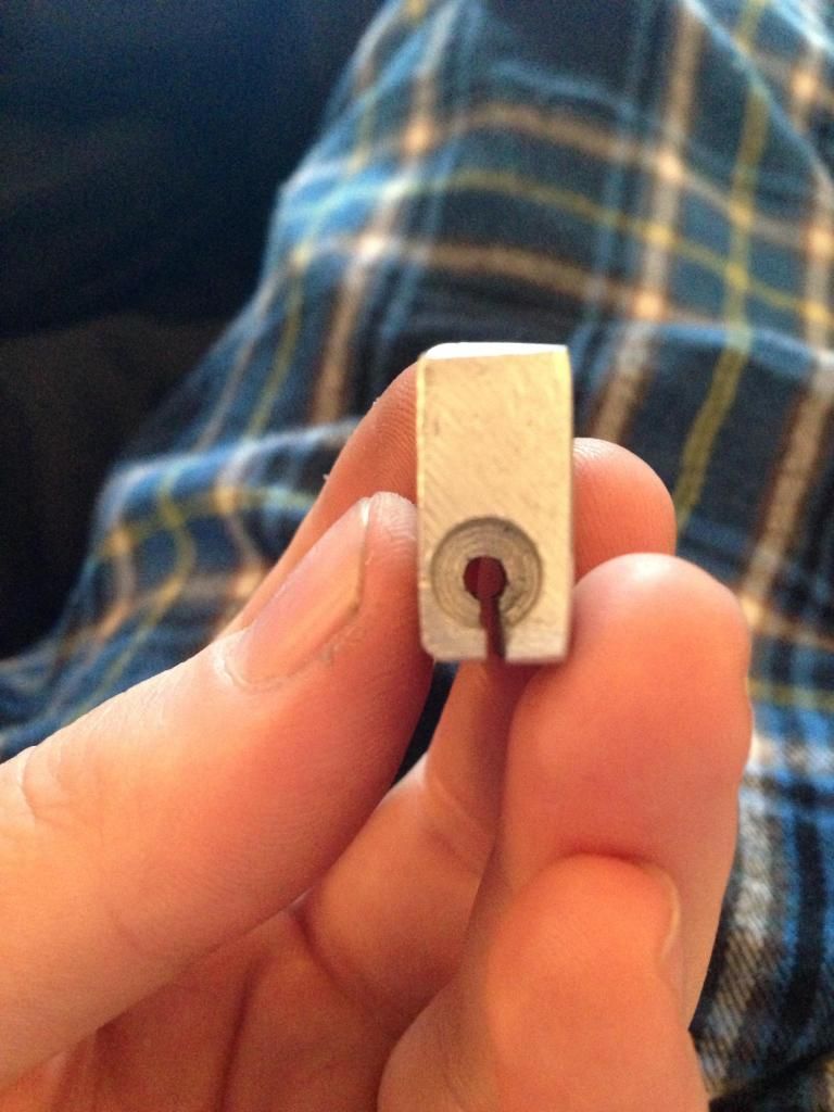

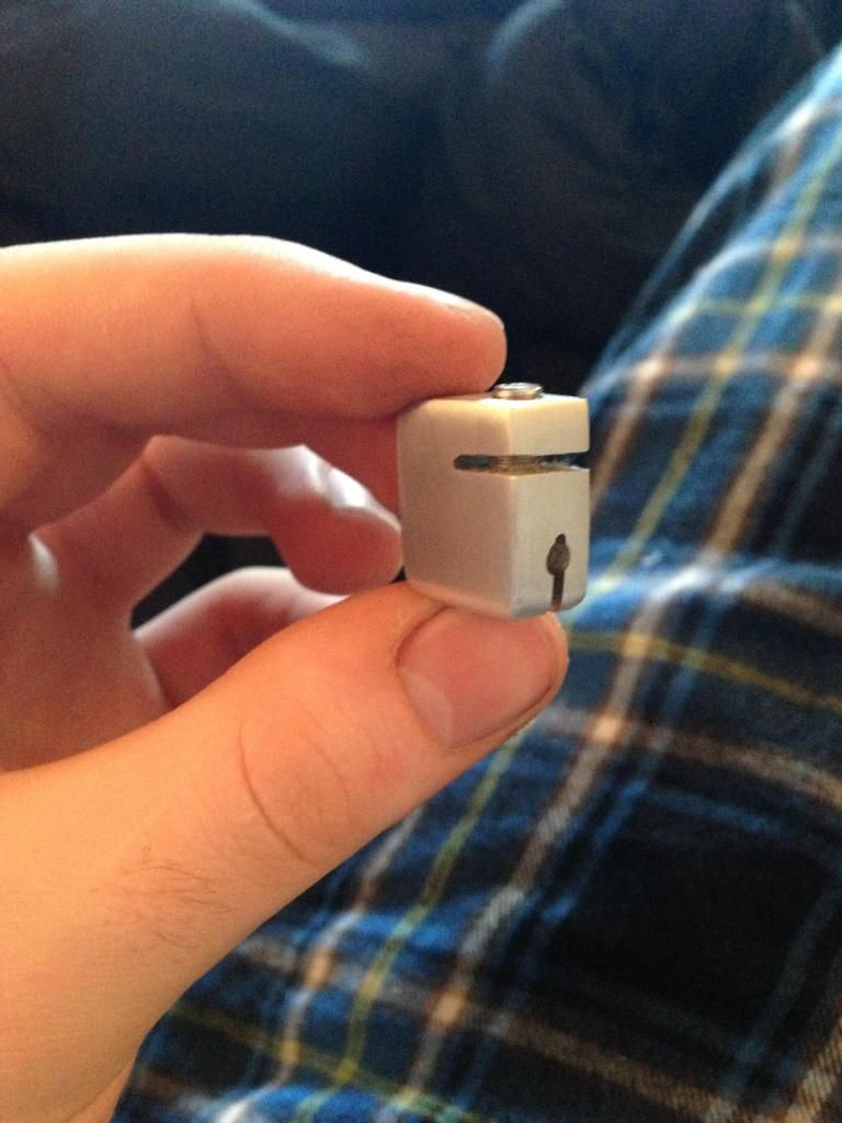

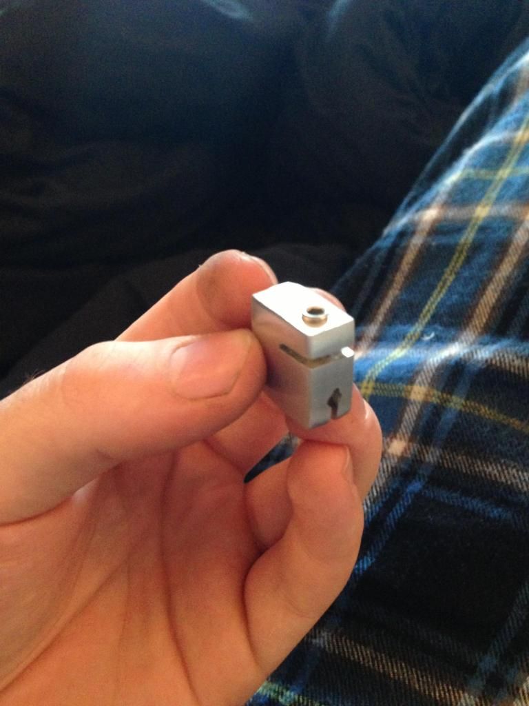

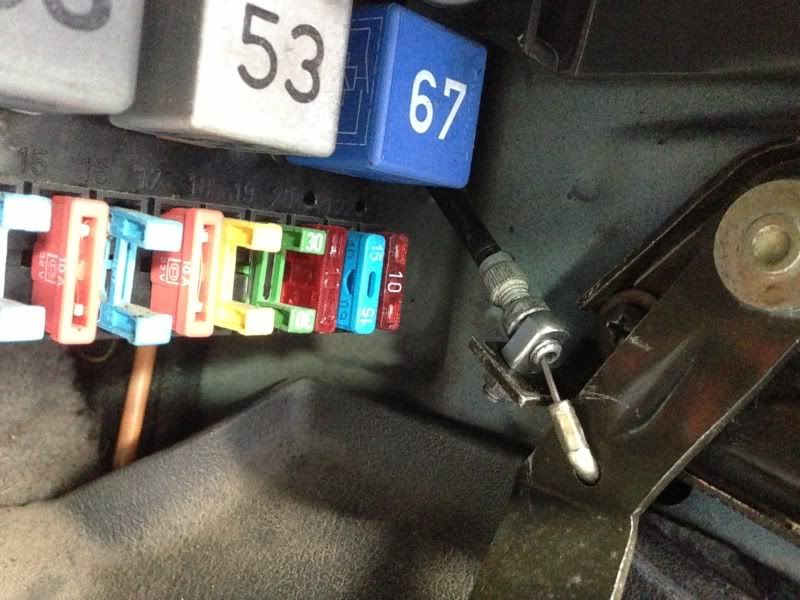

sleeper16 0 Posted January 31, 2013 Bazmcc said: Exactly. Don't worry I haven't forgotten about this. I have a design drawn up rough so I'll get it done accurately next week and we'll cut up some metal. here we go, as you can see the idea is it slide on to the tab on the bodywork towards the rear of the car so that when the cable is pulled it puts pressure against the tab, there is a grub screw just to clamp it onto the tab. the bonnet cable then slots through the bottom and the outer has a seat for it to pull against. like i say i have not tried it yet as i need a new cable, but i see no reason why it wont work. Theres no mods that has to be done, standard cable will work with it no holes drilled etc. not the prettiest but i didnt really take my time or finish it off as ill never see it unless im fixing something. Quote Share this post Link to post Share on other sites
Bazmcc 0 Posted January 31, 2013 The only issue I can see there is the grub screw? It'll probably work perfectly fine in most cases though. There will be a percentage of people who might ring the threads out of it though. What grade of aluminium did you use? A good way to stabilise that would be to put a countersink into the tab on the bracket about 1mm deep to let the grub center on. It's not a million miles away from what I've drawn up. I'll try and get it sorted as soon as I can? Quote Share this post Link to post Share on other sites
V-Dubstar 0 Posted January 31, 2013 Helicoil's could be an option to prevent stripping the thread maybe? Quote Share this post Link to post Share on other sites
Bazmcc 0 Posted January 31, 2013 Helicoils are added complexity too though as it has to be drilled out wider meaning the walls are weaker. Making it from steel is another option as it's only a small part but something like 6061 T6 shouldn't strip if the threads are well cut but the smaller the threads the easier they are to rip out. Quote Share this post Link to post Share on other sites
sleeper16 0 Posted January 31, 2013 Not sure what ally it was to be honest I don’t have any square or rectangle stock, so I can’t think of where I will have found it. Maybe cut it out of a bit of round T6 as that the only bar stock I have. Other than that my option was EN304 stainless and I didn’t fancy making something so intricate out of something so hard. I had thought about the issue of stripping the grub screw, so my thoughts were to make the cable stop as close to the slot for the tab on the car as possible to reduce the leverage it will have and hopefully instead of trying to twist the tab it will be close enough to try and pull it instead (if that makes sense?) so in effect the grub screw is just to stop it sliding off when the cable returns to its resting position. The whole thing is very small maybe 15mm at most from top to bottom so the cable should be pretty close to the "pivoting" point hopefully so close that the stress it causes works in the way the tab is designed to. Quote Share this post Link to post Share on other sites
Bazmcc 0 Posted January 31, 2013 Sounds good. Make sure you take some pics when you get it fitted. Quote Share this post Link to post Share on other sites
