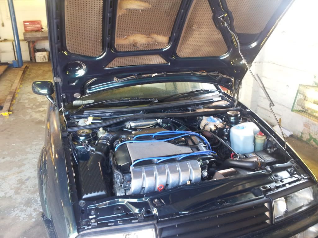

Decided to just clean out TB and ISV, and polish the inlet up a bit whilst I was there.
TB nice and clean!

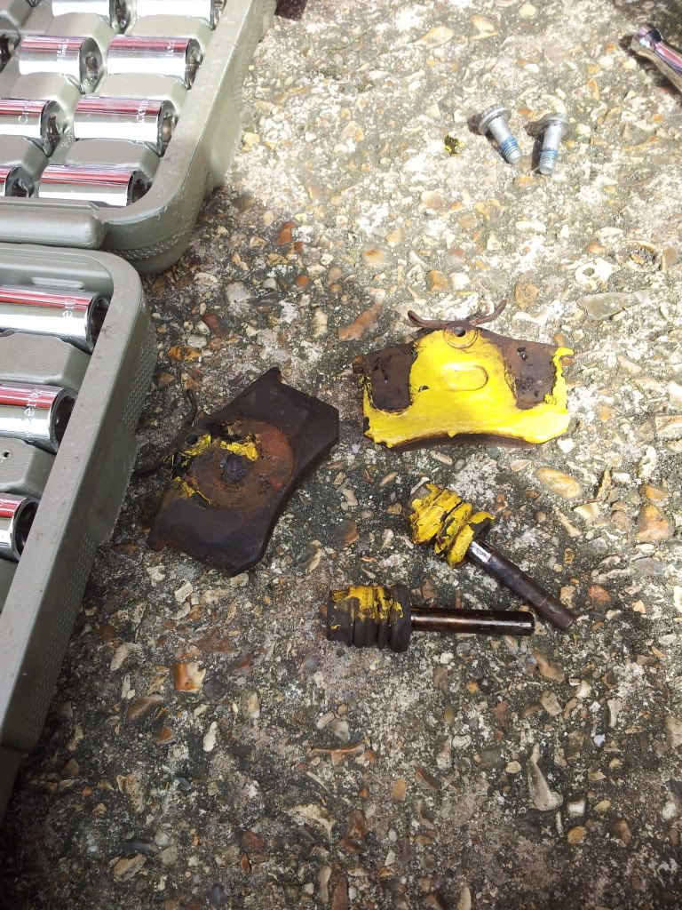

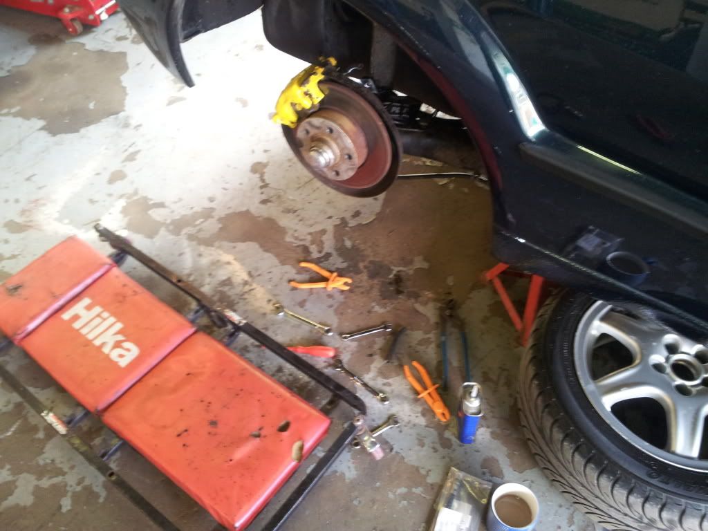

On to today. I decided to start on the brakes. Car is now fully up on axle stands, and will probably remain like this for a while now! First off was the O/S/R as the handbrake cable needed replacing on this anyway. Got it all stripped down and had the first good look at it.
****ing amateurs! The only thing that went well today was the caliper bolts came off without issue.
Slider pin boots were replaced, and all surfaces were stripped of paint and cleaned including the pad backs.
I then Removed the handbrake cable and sorted the compensating bracket from this.............
To this.
The trouble then started. The collar from the cable where it enters the pipe that goes into the cabin had corroded in.
Lots of pulling, tugging, and naughty words later, the drill had to come out which as you can imagine, had a flat battery! More bloody waiting about for it to charge, so thought I'd put the caliper back on and mount the cable with the caliper in situ.

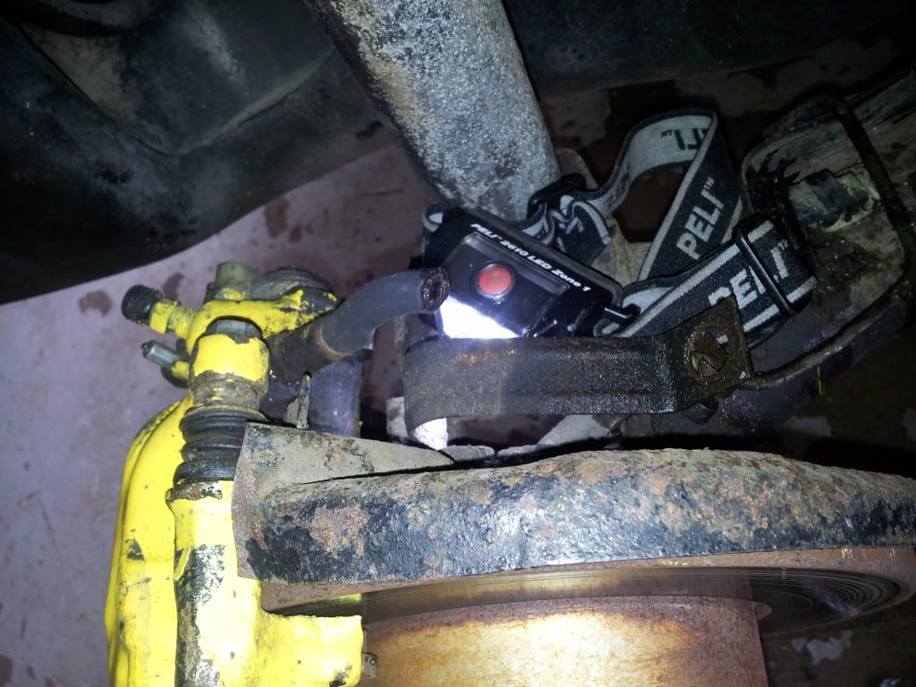

I then noticed a nice big bulge in the brake hose near the metal collar. FFS!

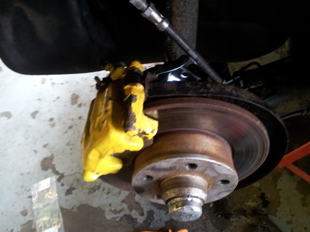

Carried on to try and wind the piston back a bit and refit the caliper, but nooooooooooo! Won't wind back will it! Spent a good hour and a half trying, but its a no go.
I have an insert that goes onto a ratchet, but not a proper tool.
I'm now in two minds whether to buy the tool, even though the caliper might be shagged, or just get a set of Mk4 Golf Rears as I'm gonna need to replace the hoses anyway...................

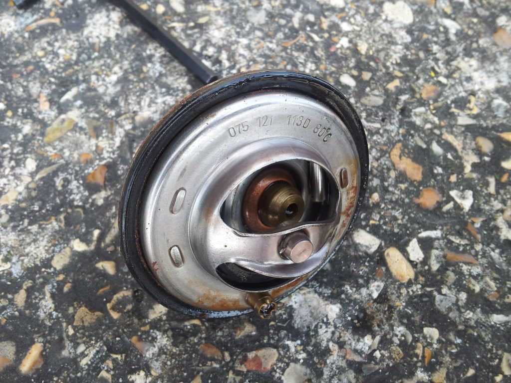

Think the old stat had seen better days.................................................
All water pipes/ways flushed with fresh until they ran clear, stat replaced, Reservoir scrubbed with the babies bottle brush.................................Its ok, we have another! Refilled, run up and bled, and jobs a good un!

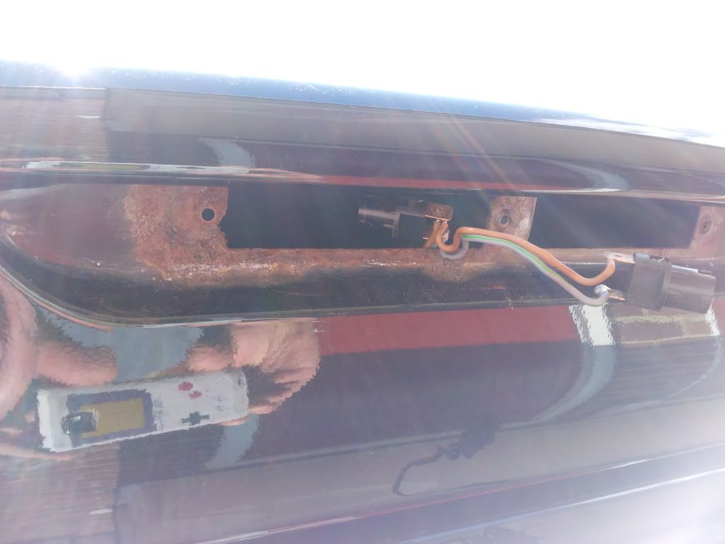

A small amount more done. Took the number plate light surround off as I need to replace one of the lamps, and was greeted with this!
One of the screws just spins and doesn't bite now, so thats a job for sometime pretty soon!
Treated the area with kurust, and went round the arches that have a small bit starting to come through as well. N/S front wing has a bit that needs sorting as well, but luckily its all still solid around there so a rub back and a lick of paint will sort that.

Brake hose replaced and system bled this afternoon. All went really smoothly which I was shocked at, but happy about. All nuts came away nice and easy after a couple of days of constant soaking in PlusGas.
Old duff hose. You can see the bulge to the left, just before the metal collar.
