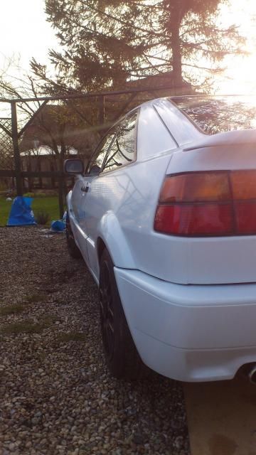

right been working on the car all day and knackered having sorted the electrics i set about the bodywork i couldn't deal with the orange peal paintwork anymore every time you run your hand over it it would get all the dirt stuck in it i decided to wet sand it after all cant look much worse and im very chuffed done one side and its turned out great really need to invest in a polisher no where near show finish but decent enough anyway heres some pics what you think.not bad i think for my first ever wet sanding session
see the difference didn't get round to the bonnet
no i think it was sprayed inside but its not the best paint job think its got orange peal because it wasnt baked on thanks for the comment
