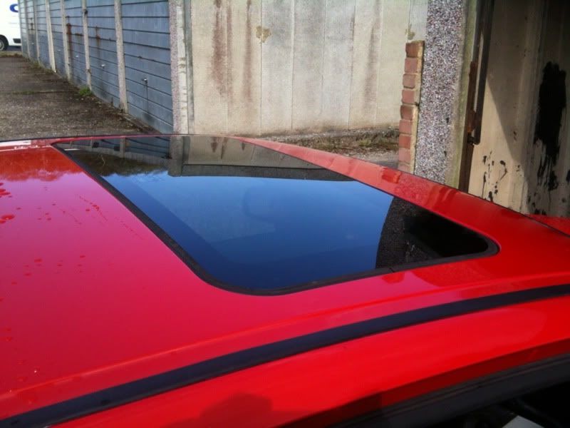

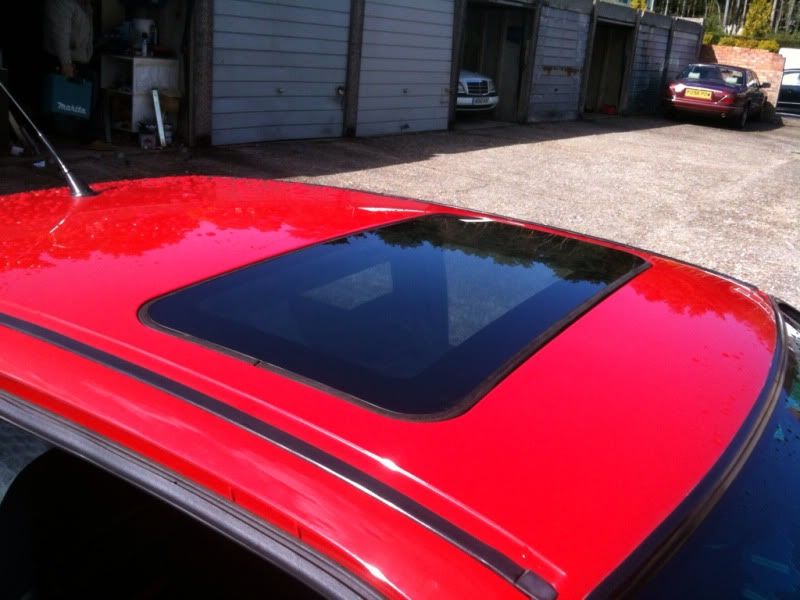

Jamie 1 Posted April 27, 2013 :D :D :D :D :D :D Needs a wee bit of adjustment but it's in and works a treat. MKIII Golf GTi mechanism with B4 Passat estate glass :) Quote Share this post Link to post Share on other sites
GlosterOx 0 Posted April 27, 2013 Looks good!! Ian. Quote Share this post Link to post Share on other sites
