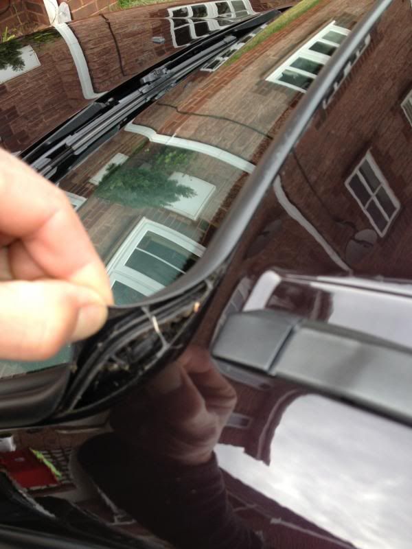

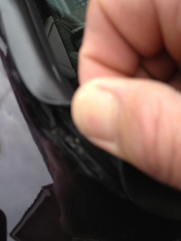

robrado974 1 Posted April 28, 2013 I gave the old girl a wash today and found that the trim has come loose around the top edge of the windscreen , not very happy tbh !. I had a new screen in 2010 when the repaint was done and the pillers were replaced as they were rotten . I have spoken to autoglass today and a technician is coming out on friday to re seal it . I hope there is no damage done , i dont know how long its been like it . I presume any water that has got in can escape ? ,just a bit worried as this is why my pillers were replaced in the first place ,due to poor fitting . What do you guys think ? Regards Rob Quote Share this post Link to post Share on other sites
STU175 0 Posted April 28, 2013 thats not a waterproof seal dont worry no water will enter the car stu - national windscreens Quote Share this post Link to post Share on other sites
seanl82 23 Posted April 28, 2013 As Stu has said, the screen is bonded from the back. That seal is actually just a trim piece, get some compressed air in there to blow all the possible water out before its fitted back in, and you should be fine Rob. Quote Share this post Link to post Share on other sites
robrado974 1 Posted April 28, 2013 Thanks , you have both put my mind at rest . I know the screen is bonded , but it makes you think , where is that water sitting that has leaked into that hole ? Quote Share this post Link to post Share on other sites
VW_OwneR_85 2 Posted April 28, 2013 the reason its not tight tight is because the windscreen was put in place abit further down in the channel when fitted , they could of done with bringing the screen up 1-2mm extra , the higher up the windscreen is the tighter fitting that seal will be, but you run the risk of it being too tight.. Quote Share this post Link to post Share on other sites
Supercharged 2 Posted April 28, 2013 Yep - it should only be 'glued' along the top so they are often a bit loose round there but shouldn't be ideally... It's wither fitted a bit low or they've used an aftermarket seal that's shrunk If all else is ok though a small blob of silicon will sort it Quote Share this post Link to post Share on other sites
